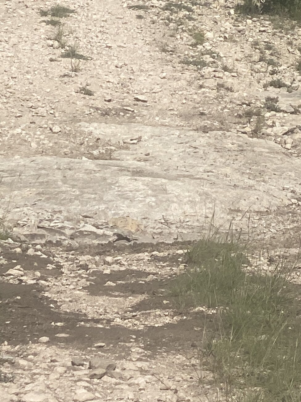

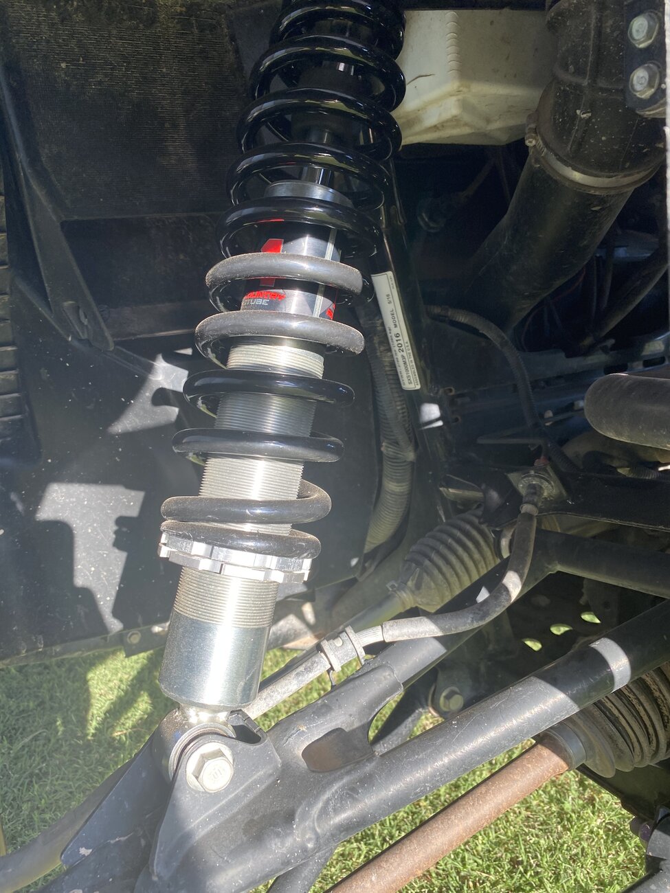

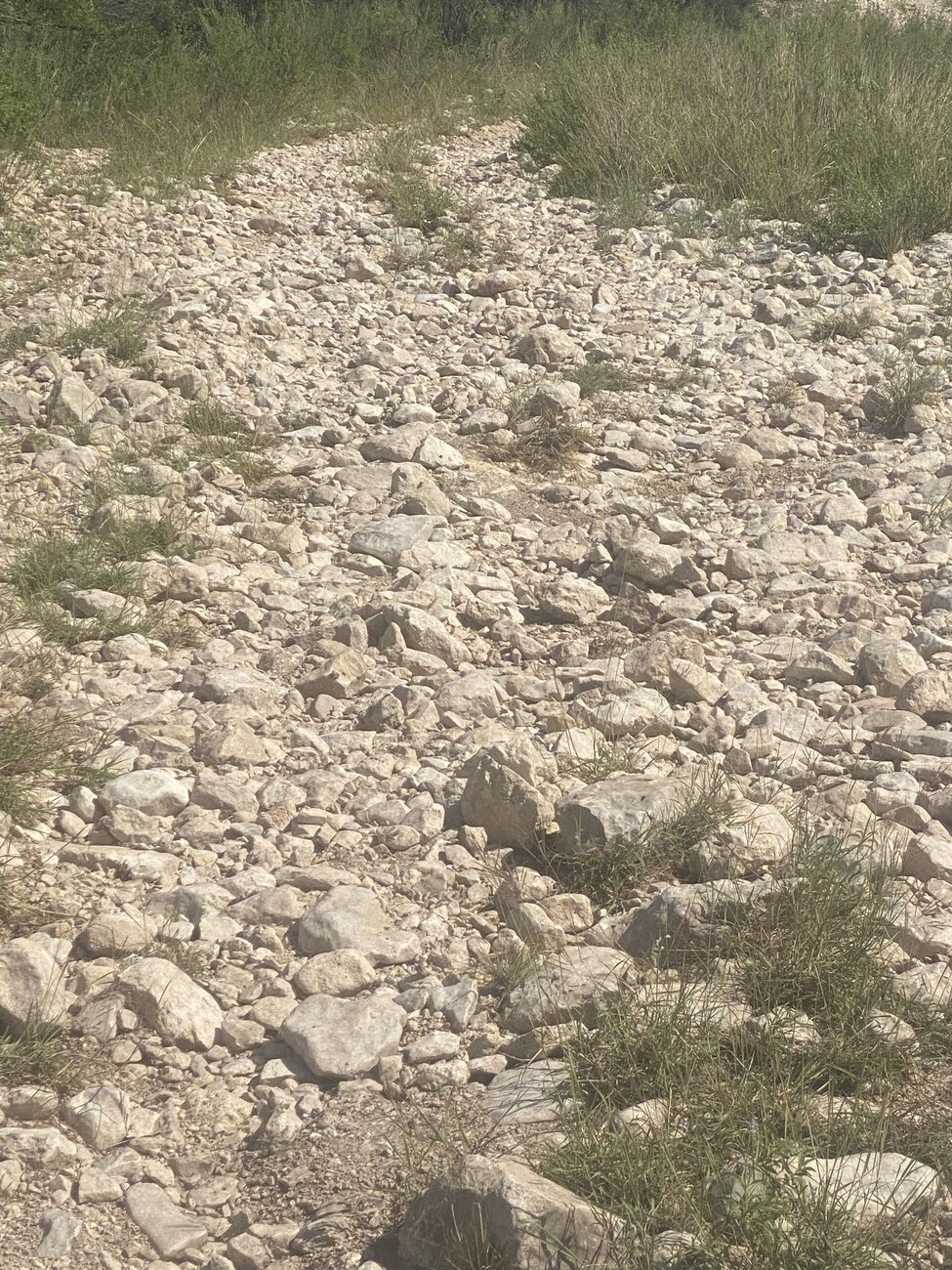

So after this weekend of banging on the rocks it rides better than before but not like a Cadillac. Seeing these cost the same as factory replacements but you can raise the height not a bad purchase. Overall I am not disappointed in the shocks. I think something like the 814’s would be better as they are more adjustable.
DBFCAAEC 948A 4FA2 B430 DB87B872512A
D5BC2EA5 A3A8 4F5A BAD4 38151DC4C054
These are what my roads look like. I put 650lbs of corn in the bed and it barely squatted the p1k.
