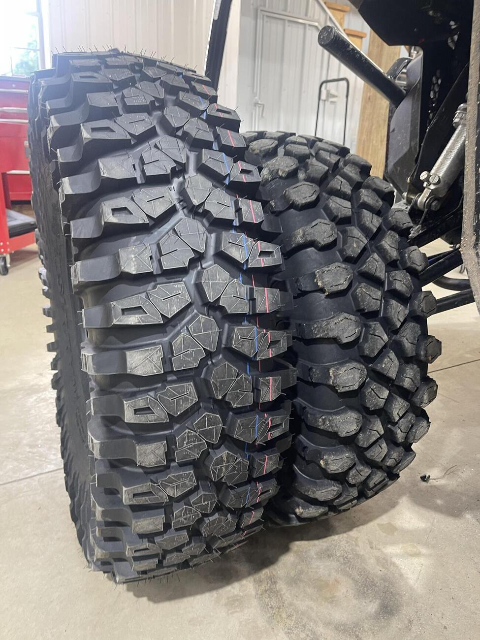

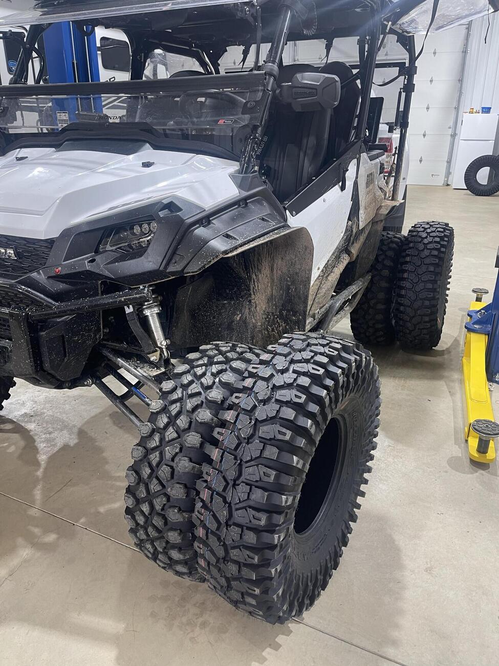

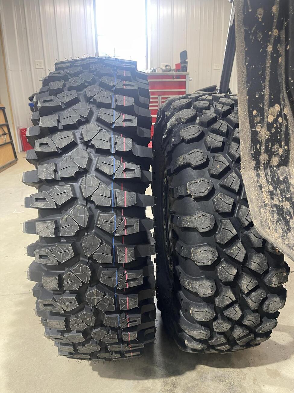

Here’s what’s to come to truly test out the steering upgrade!!
TerryH
TerryH
Sep 13, 2019
664
2,241
Springdale, Ar
Reactions: Smittyp
8,140
61,478
32” is what’s on it now. The zillas are 35”.
I’ve got the IGR 25% reduction and talon reverse upgrade in my pioneer. With FCP tuning.
Let us know what you destroy. Few of us have been on this adventure before but it was 32" Zillas at @snuffnwhisky expense, back before it was cool to have Zillas 😂 . @joeymt33 found all the weak points, snuff fixed them all, then parked the old girl in a field to die....
