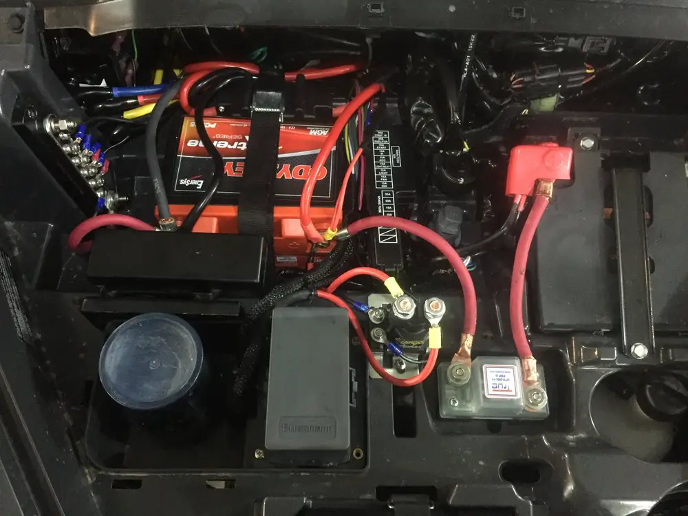

Exactly! I'm not worried about draining the battery sitting around listening to music around the campfire, all of my accessories are ran off of the key to avoid that dumb sh** anyway. That's why they make boom boxes.
I'm trying to avoid over drawing the stator with too much running at the same time. Not that I would make a habit of that either, but that's the only time I should be drawing from the battery other than starting. I just want a bigger battery really. Adding a second in parallel is the easier alternative.
With short runs of fat cable and good connections, hooking to a heavy bus bar may generate less resistance and better flow of current than these isolators do?
Go for it!!
You are correct in that this is wired in parallel. The main issue gets technical. All the wiring needs to be large enough to handle the current draw due to voltage drop.
This is true, not such a problem in high voltage like we have in our homes, but low voltage drops quickly as it travels. We don't want to see P5's start burning up like RZR's.

On the 1000 you want to keep your primary battery voltage safely above 12v the "TRUE" ISO breaks the connection to the secondary if the primary's voltage is less than 12.7, it WORKS my secondary 55ahr Optima quickly dropped to low in the 10v range when winching someone out of a hole. A winch can draw 300 amps the stator can only put out 46amps at full output. Never be able to keep up, but it can recharge it once the primary hits 12.8 volts.
The 700/500 only have a 32amp output
On the 500 that won't make a difference, BUT the factory battery is not designed to be deep cycled, you drain it deep several times it's gonna die, did that on my 700 TWICE second time I put a yellowtop Optima under the seat which is designed for deep fast discharges like when winching, voltage would drop when winching but it'd quickly get a near full recharge with a half hour of riding.
Lithiums are not designed for deep cycles so while they are smaller and pack more power, can let it go faster, winching is not their designed use, no manufacturer will warranty them.
I have my battery tender hooked to my primary battery whenever it's parked, when it hits 12.8 it starts charging both batteries and they stay right at 13-13.2 v consistently with the motor off. Powersports batteries are such a small capacity a small
parasitic drain can fully discharge one in 4-5 days, causing permanent damage. At $100+ per battery you learn(my first battery on my 700 I killed with the memory drain from a crap radio in a week)
Optima is heavy and takes up room but, for how I use my machine it made sense. I can't put the Honda heater or the storage under there but I needed more juice, I use my winch. I'll get a heater and put it in the cab against the "fire....wall?" Only be a small child in the front middle so it shouldn't be in the way.
Doesn't fit everyone's needs but sometimes having all the info and taking into account your use, wants, needs, then weighting them out allows you to make the most educated decision(or in my case S.W.A.G.) you can.

Yes, I have three of them on my P5. However, they don't serve as an alternative to properly sized wire. And my second battery is a deep cycle battery with three times the AH as the stock. If the dual battery set up is wired right, you're always cranking with the stock battery that has higher cca's.
32,050
No Absolutely correct a breaker is NOT!!!!! an alternative to properly sized wire. Safety measure incase something goes wrong, so you don't look like a flaming popo and out $$$$$$ while stuck in the woods somewhere.

Now there's the educated answer I was looking for! I just needed a viable argument to my theory, other than that's what everyone else does. Thank you for that reply.
