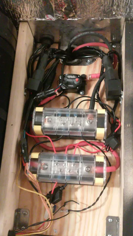

Didn't get anything done yesterday, power outage, heavy rain and wicked wind.
Back at it today though and she's up and running. Had two 15' ers of 4 ga. wire, figured I'd have some left over but after routing the first cable and giving it some to spare, it measured 7 1/2'. Cut them in half so all cables are the same length, pos. and neg. between the two batteries, then one neg from the factory battery and a positive off the second battery to the power box. Battery and winch connectors soldered and shrink wrapped. Put it all together and tested.
Tomorrow I plan to dielectric grease all connections, fine tune the routing of wire and loom it all.
Battery Power Board
Hooked up
View attachment 39921 View attachment 39922 View attachment 39927

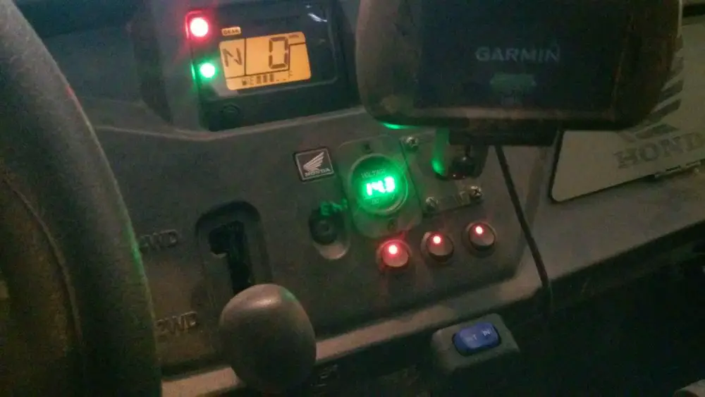

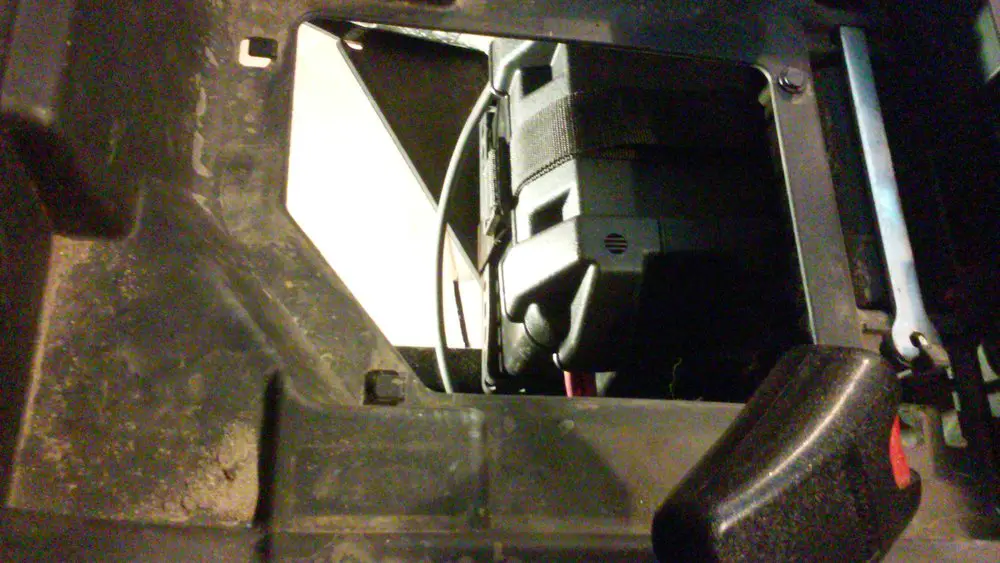

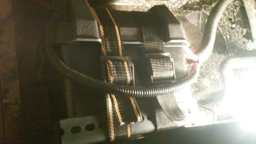

Finished it up today and I like it. Unless you use that area for storage, I think it's the best place to put a second battery. It sits right on the frame, lower than the stock battery and it's as far forward as possible, puts it right behind your calves. No exposed or visible cables unless you go looking for them.
The Ricochet's cover the bottom of that area a little more too, that's a bonus, kinda curious as to how much mud will even make it in there now.
Installed an led volt meter in the dash to finish it off.
Done

Looks good
Trig....love the green
voltage meter
Reactions: trigger
That's a great idea putting the battery in that location and not under the hood adding more weight to the frontend,good job @trigger !
