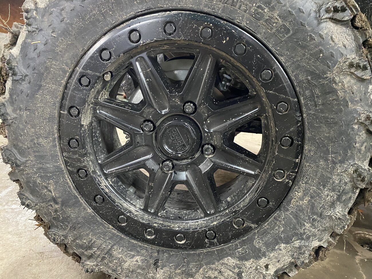

Stock mine measured 49.5” in front and 50” in rear. 1.5” wider in front and 2” wider in rear. Wheels are 5+2 on the web site, but I think they are closer to a 5.5+1.5. Here is a better pick of the wheel. Tires are sniper 920’s.

Stock mine measured 49.5” in front and 50” in rear. 1.5” wider in front and 2” wider in rear. Wheels are 5+2 on the web site, but I think they are closer to a 5.5+1.5. Here is a better pick of the wheel. Tires are sniper 920’s.View attachment 329353
Thanks for the measurements and the great pics!
