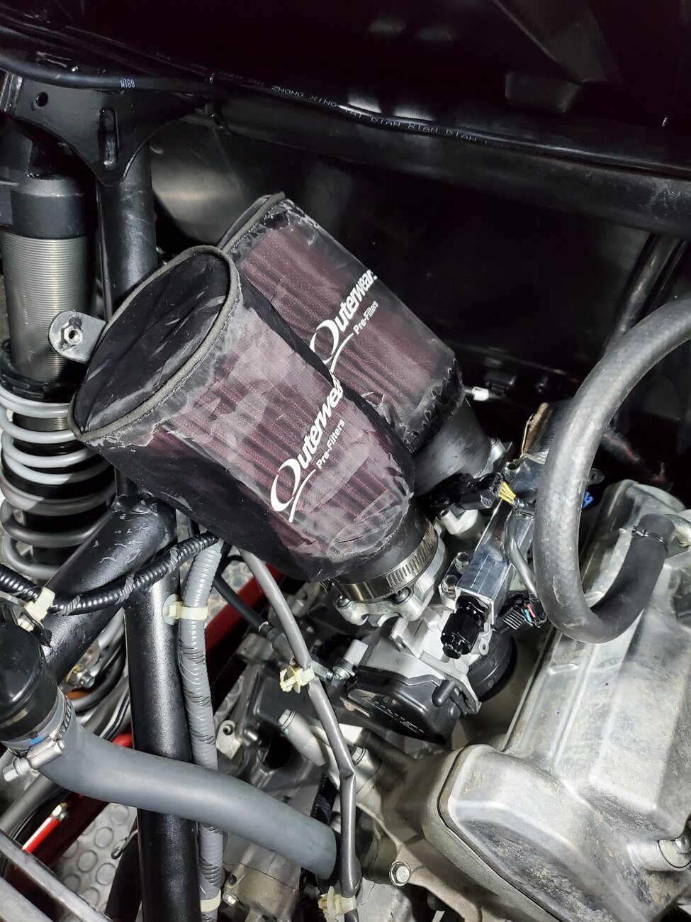

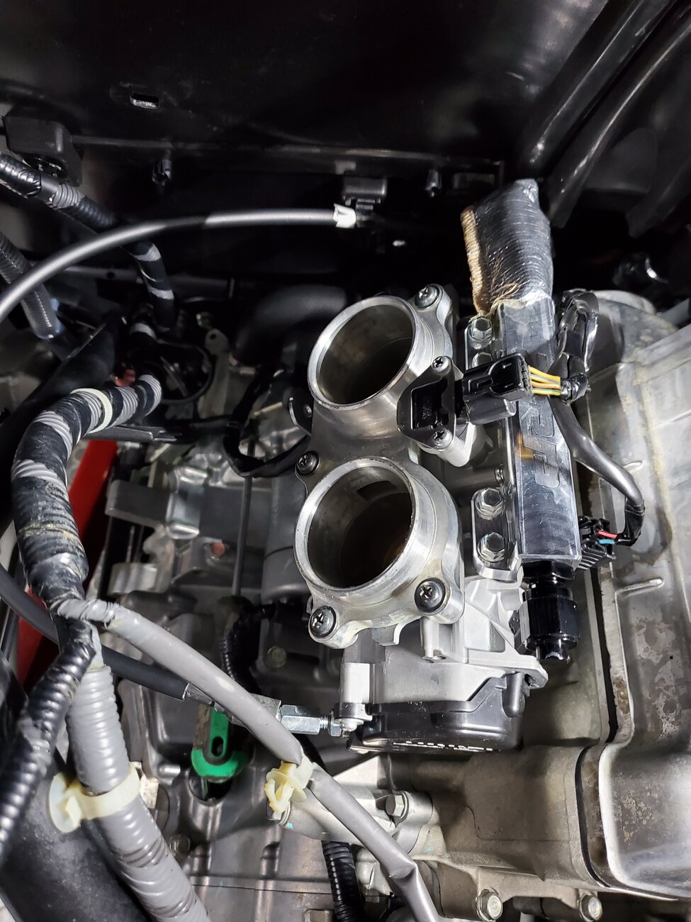

I've been working on the car a bit.
This is either going to be an awesome idea or a stupid one.....

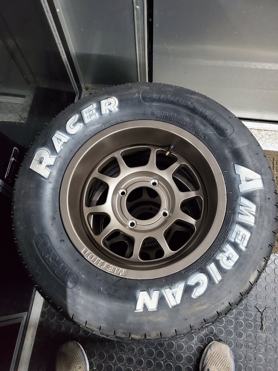

I also picked up 4 new wheels and tires....

If you can get that filter setup to run properly, do your engine a favor and trash those filters before they trash your engine. Use some properly oiled Uni filters and protect that engine.
For simplicity, I think this dual throat filter will fit. Get a couple and clean/rotate between races...
I got to say i wouldn't run a K&N on anything i own, but the Jackson setup on our race car has been flawless with the foam pre filter. Buy he does wash and oil every race.

I got to say i wouldn't run a K&N on anything i own,.but thr Jackson setup on our race car has been flawless with the foam pre filter. Buy he does wash and oil every race.
"Foam Pre-Filter" is the key word in your statement!!! The K&N under it is doing almost nothing but holding the foam. You could use a course screen mesh in place of the K&N and get the same results.
The ONLY place I use a stand alone K&N is in a pre-filter situation, they work great for that.

I've run K&N filters on lots of stuff and never had an issue. I also check, clean and oil my filters regularly so that may be part of it.
I've never had good luck with Uni Filters. Used them in my dirt track kart and a couple pit bikes I built to race and ended up swapping them for K&N's and Outerwears covers. All my Uni's let super fine dust past the filters and into the intake, the K&N's don't.
Worst case I wrap the filters with the red Uni foam I picked up on Amazon
The K&N is still pretty dirty afterwards, depending on the dust. I totally agree with not running them, but it seems to work in this case.

No going back to the stock air box for me unless I find a spare one. I cut the bottoms of both air box boots off and Gorilla glued them into the K&N filter bases so that they would "snap" onto the throttle body plate.
Anybody have an old airbox laying around they want to sell me the boots off in case my idea sucks? 😁
Call a few dealers. I needed one and my dealer just gave me one they removed from installing a Turbo and the customer didn't want it.
