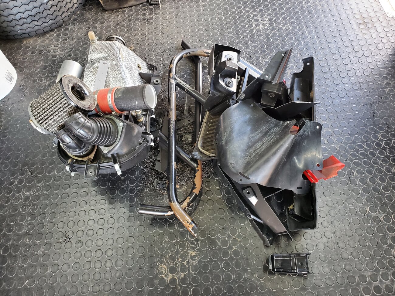

Found more stuff to cut/take off...
20211018 214848
And when I weighted the parts the other day I only had 1/2 an air box with no lid in there and no pre-filter setup. Gathered it all up and got all of it weighted earlier today...
20211019 145815
Pretty respectable number considering I took a ton of weight out of it when I originally built it...
20211019 145910
