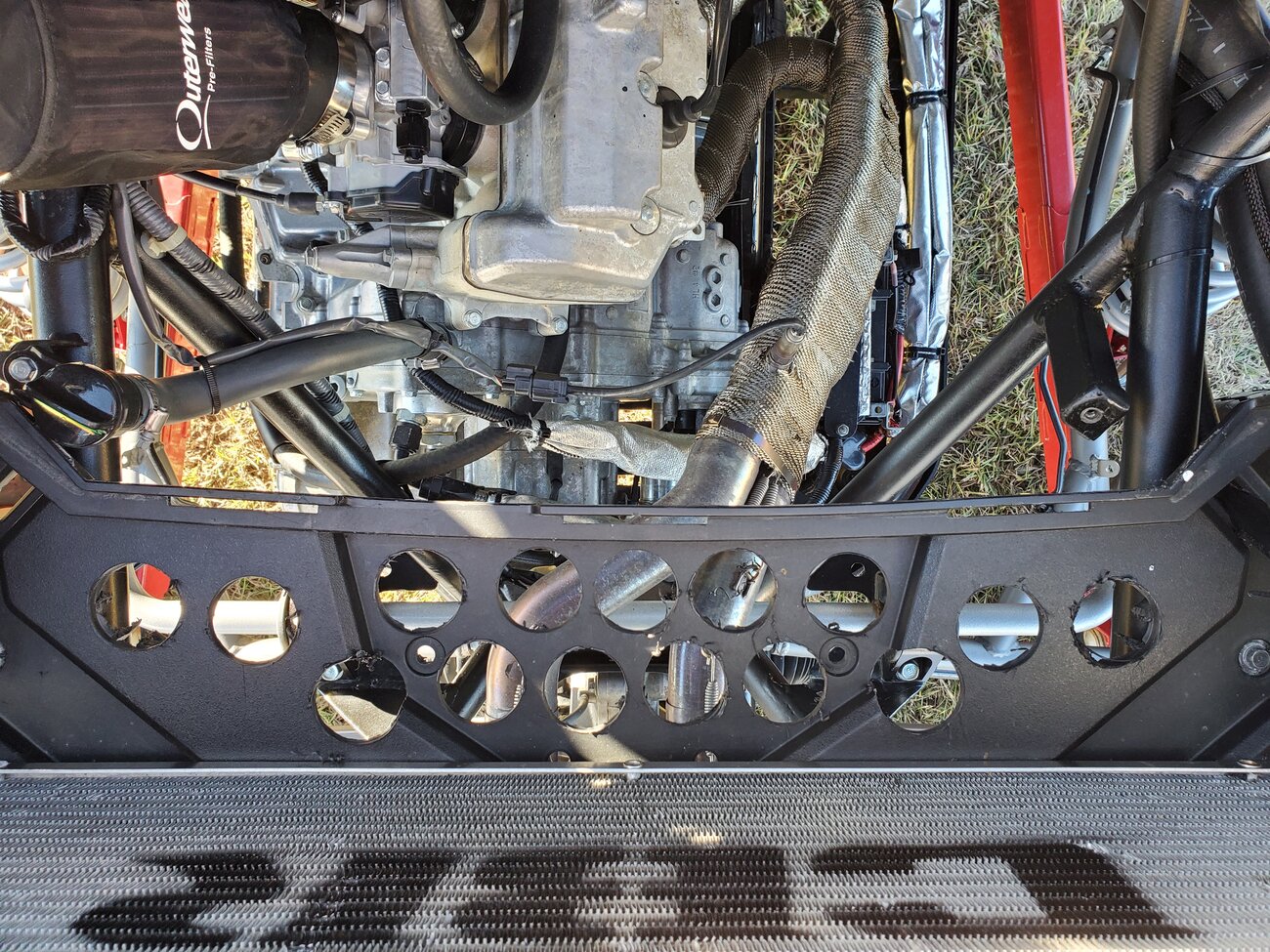

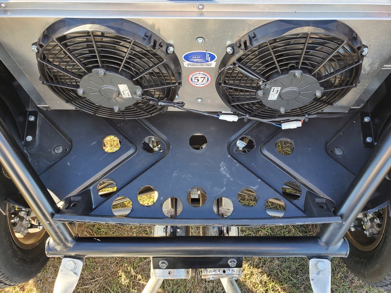

Well... The HMF fuel tuner I ordered last week didn't show up so I wasn't able to make it to the track for practice/tuning like I wanted to this weekend. Instead I went out to the trailer and thought about what I could do to remove more weight. It's amazing what you can accomplish with a Sawzall and a hole saw in just a few minutes. 😁
I cut more off the back and sides of the bed, Swiss cheesed the parts I couldn't cut off and then went full retard and cut the top portions of my nerf bars off.

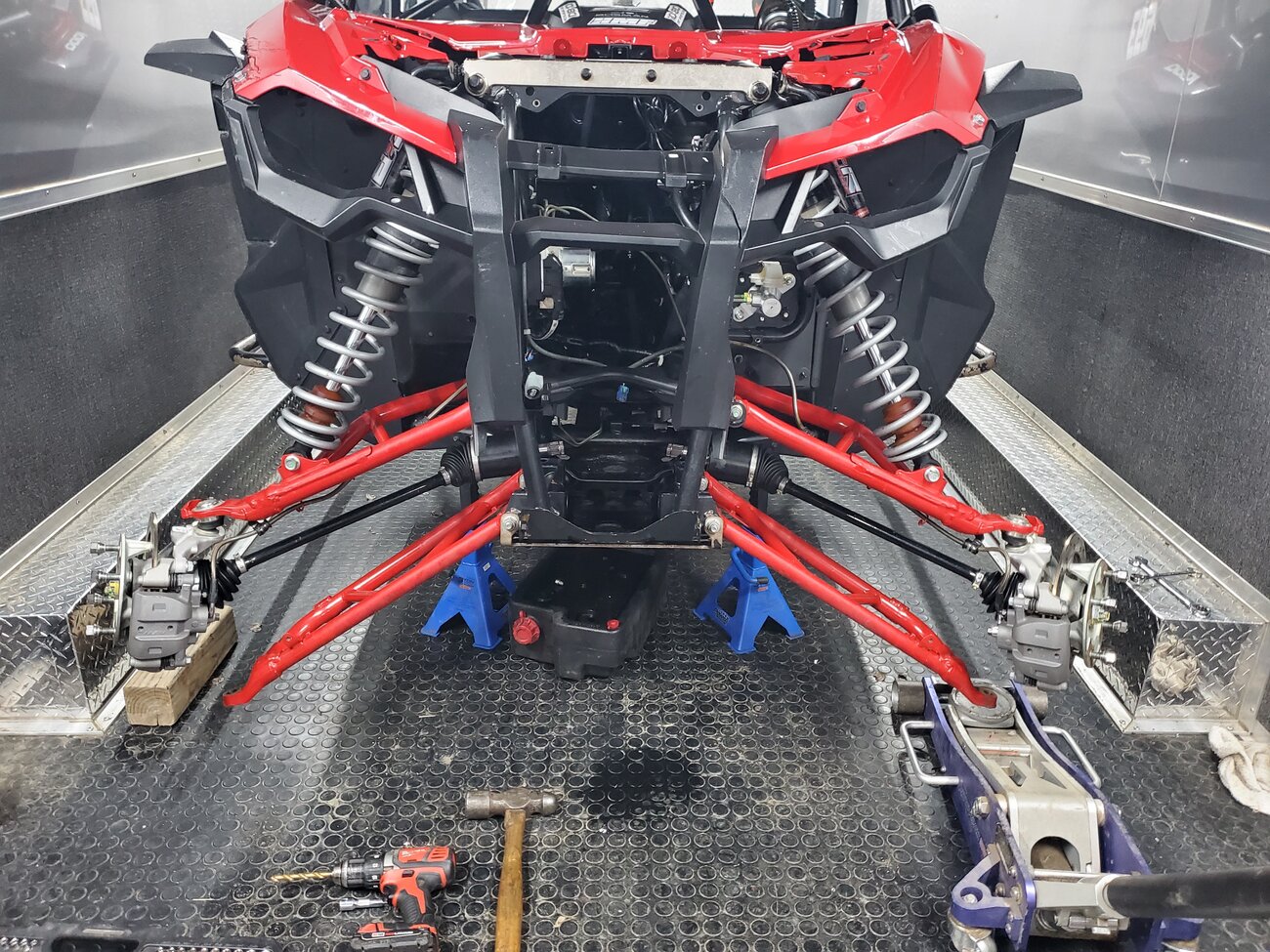

The rack might be tweaked but I won't know until I pull it out and inspect it. I ran the main after the crash and didn't feel anything odd except for the 2wd part.
I'm happy to report that my chassis/cage came out of the crash unscathed. Guess I did a good job when I built it!😁

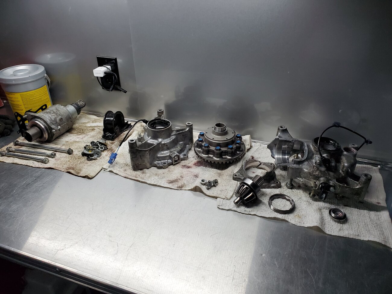

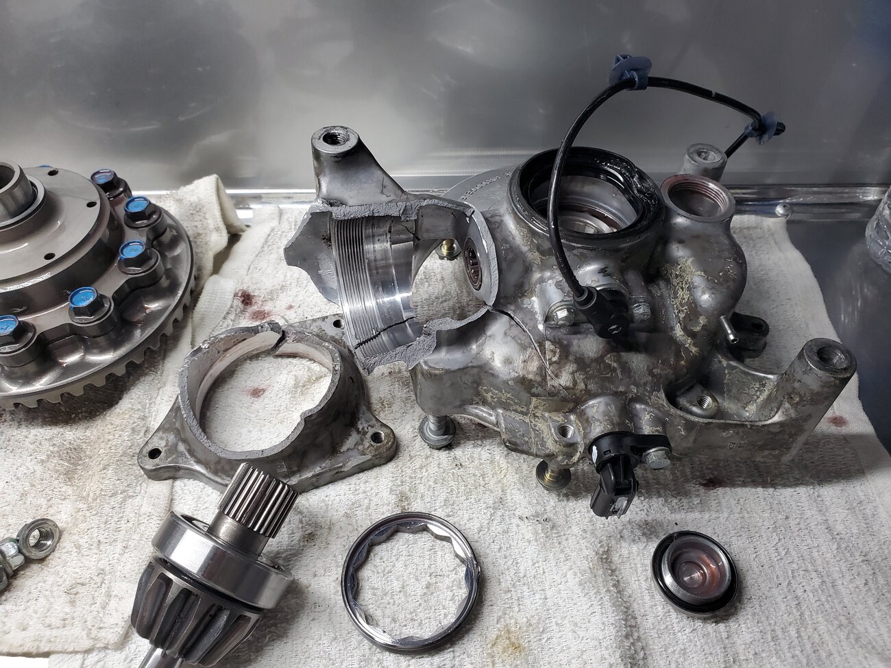

Did the frame bend enough to bust the diff?
No, Frame isn't bent anywhere except the rack mount. Diff broke and rack mount bent when I landed on the RF at full throttle and full right lock. The shock load sheared the u joint ears off and when the driveshaft tried passing the broken yolk on the diff it snapped the case.

Kind of off topic but...... Holy crap that front differential is heavy!!! This winter I need to get that thing to a machine shop and have them shave a bunch of weight off the case. I bet I could run only half the ring gear bolts and still be fine doing what I do with my car.
