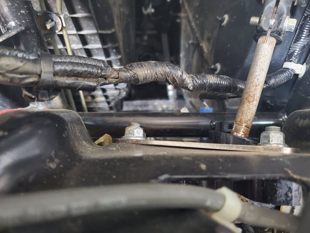

Oh, and if anybody is questioning how strong an RB3 billet rack is, check out this picture....
20211030 194811
I landed on my RF tire at full lock from about 3-4ft in the air and the force of the hit got transfered through the tie rod into the rack. The hit was so hard it pushed the rack body up on the right side and basically stamped the shape of the rack into the frame mount. The only damage to the rack was a chipped pinion and rack gear. Nothing else bent or broke!! Because of the strength of that RB3 billet rack I was able to finish the heat race and run the main without issue. Had the stock steering rack still been in the car when that crash happened there is no doubt in my mind that it would have exploded into a million pieces all over the track and I would have been out for the rest of the day.
The RB3 Honda Talon steering racks are the real deal. 😎

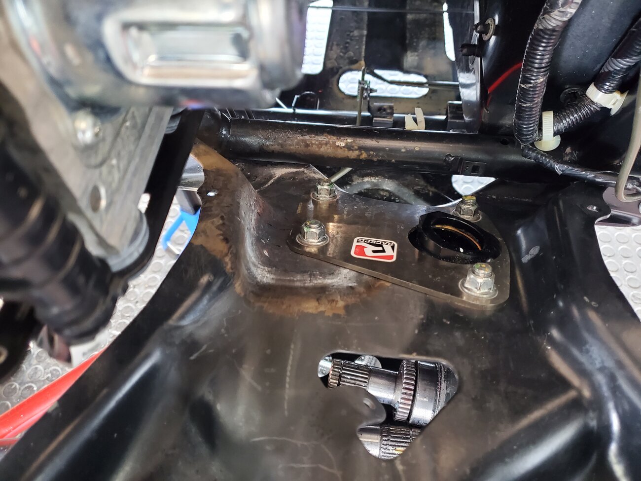

Did you have Jamie's brace on previously?
Yes, this is the before picture. I honestly don't think that thing does much to prevent the mount from flexing or bending. I just think it adds extra surface area and clamping force so that the rack studs don't wallow out the holes. I have a great idea on how I can brace that mount the right way but I'm going to have to wait until the season is over so I can tear it down to the bare chassis and do some fabricating.
