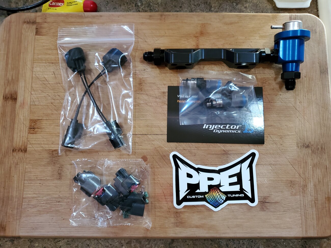

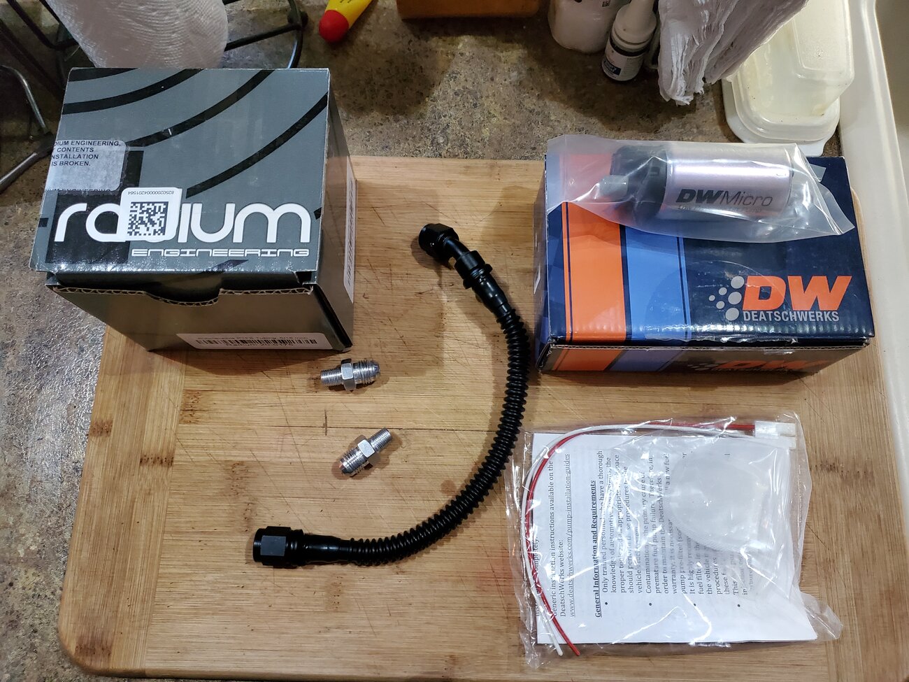

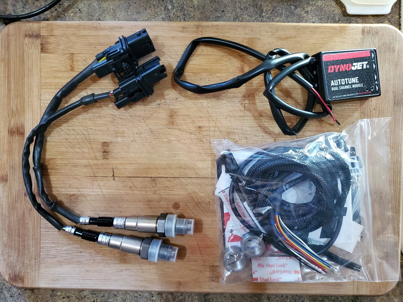

Zoom zoom...
20211202 181835
20211202 200701
20211211 124131
20211211 123357
Just waiting on a set of bronze valve guides and the spring/retainer kit to show up later this week and then it's all getting shipped up to Missouri for the build.
Due to the extended time frame needed to get certain engine parts custom made for the build I decided to go with mostly off the shelf parts and race fuel for next season so I don't miss any races at the beginning of the year. We still plan on bringing the car up to PPEI for dyno tuning and while it's there they will be adding the launch control feature so Slowpoke can get some holeshots next season. 😁
Other than throwing it on scales at some point this winter to make sure it meets the new 1700lb minimum weight rule I don't plan on changing much else.
