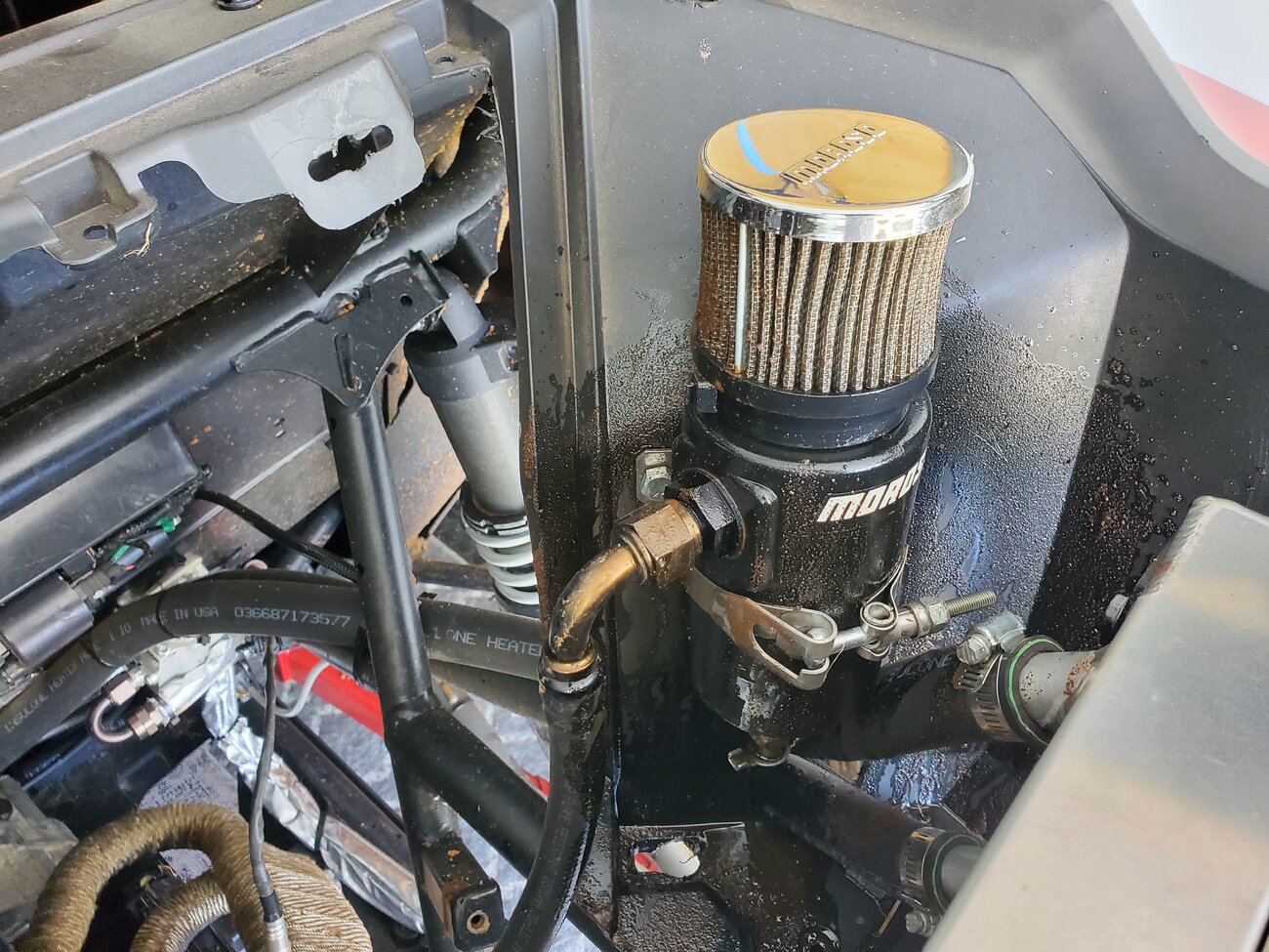

So..... I took the car to a local MX track this morning to run some easy practice laps to see if I can drive with 1.5 hands and I killed it. 😟
Apparently the air filter collapsed and got sucked down into the velocity stack. Once that happened it sucked the filter oil out in those two spots and started inhaling dust. I didn't notice a problem until it was honed at least .030 or .040 over so now I get to pull the motor, disassemble it and get the block sleeved on top of having to rebuild it.

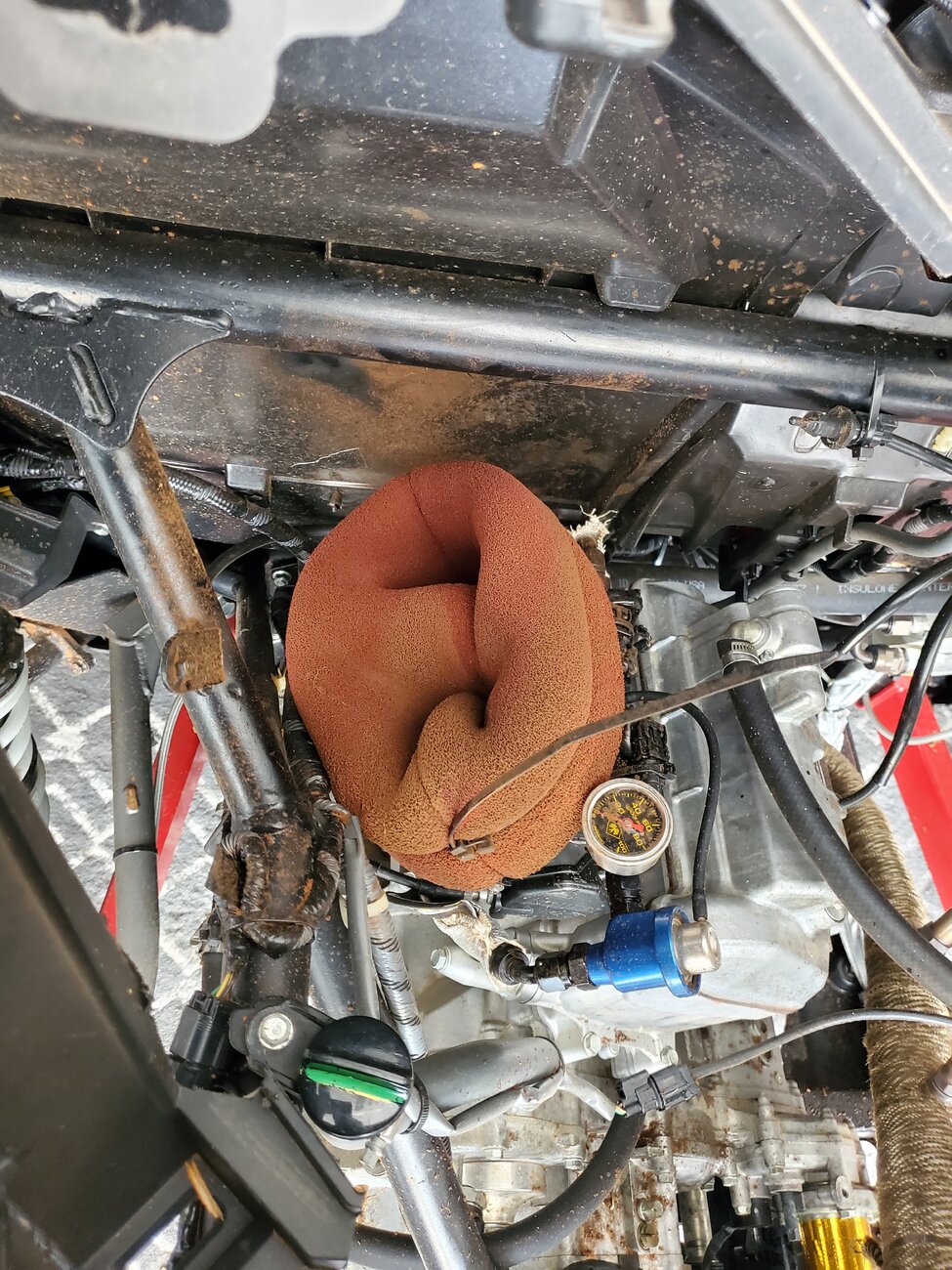

Engine is out but I've had Dr appointments the last few days so I haven't pulled it apart yet. I'm going to do that today after I mow the lawn and get the trailer set up as my clean room for disassembly.

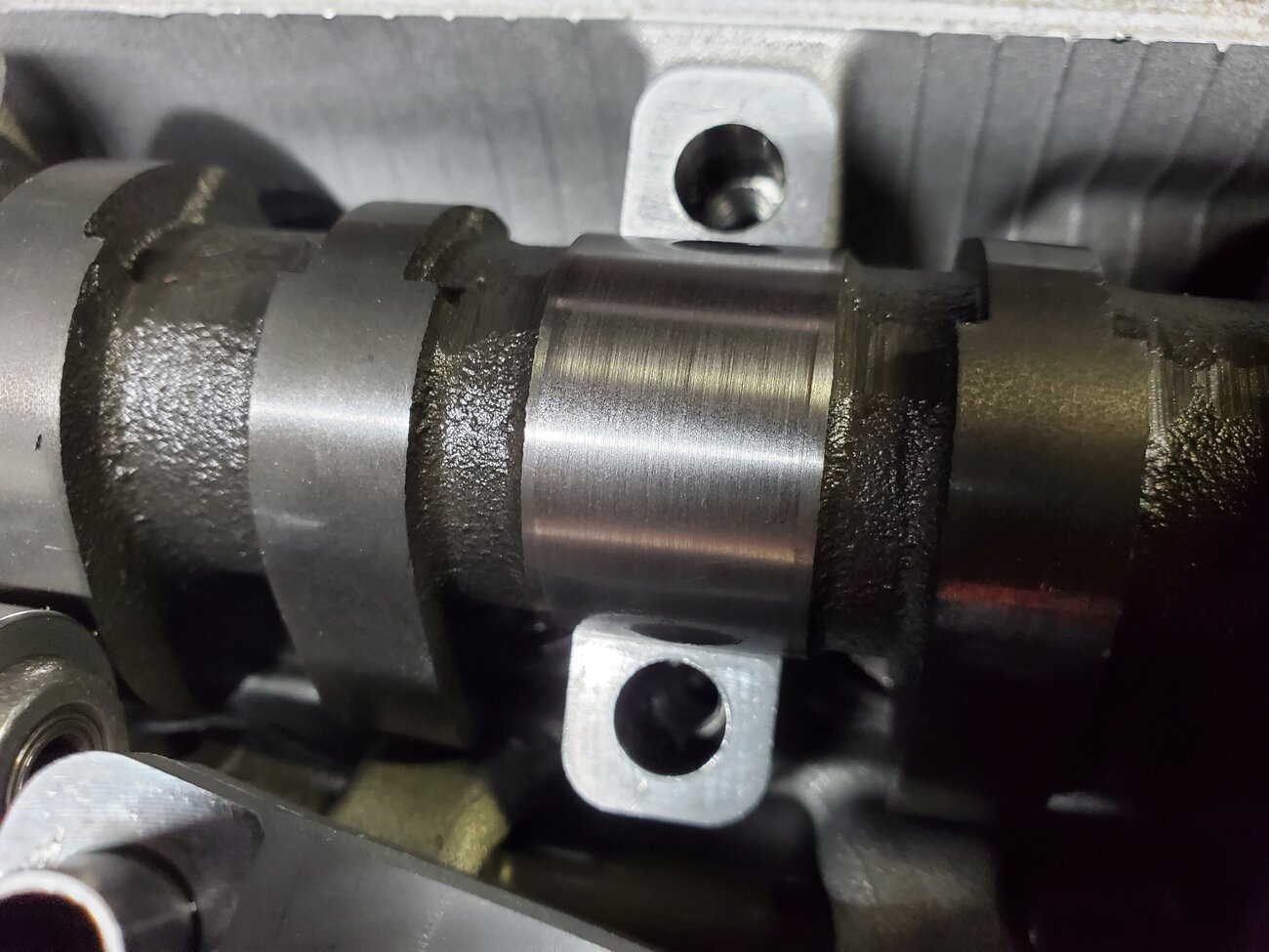

Lots of dirt in the intake ports and lots of oil in the exhaust ports but I'm happy to say that the cam journals in the head look fine and with a good cleaning after it's disassembled will be as good as new. That is a huge relief as I REALLY didn't want to start over with a new head! 🤗

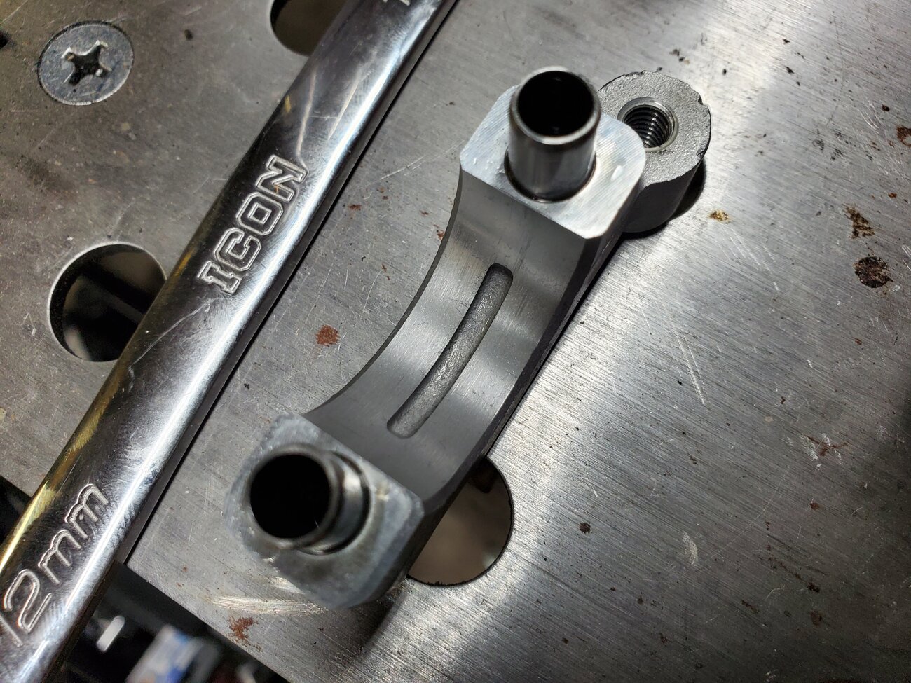

On another positive note..... My engine guy found me a set of Crower rods with ARP 625+ bolts for a steal on FB Marketplace the other day so I scooped them up and they will be here tomorrow. I wasn't planning on getting new rods unless mine were trashed but for the price I paid it was a no brainer.
