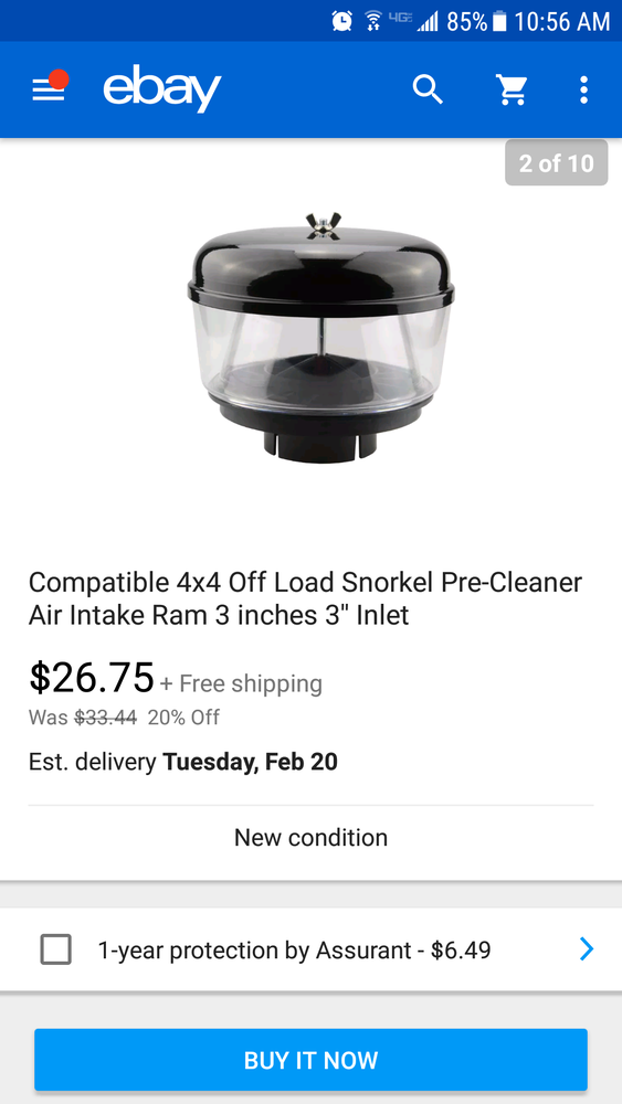

I plan on using the warior riser when I build mine. I like the pre filter @Yankee used on his 1000. It's a flower pot type. I dont know what size he used on his. You can see how much dirt it catches and filters out in the plastic bowl.
Those work great, but for my build through hood I wanted the look of the 1000 with ram head
Reactions: Deluxe700
elkaholic
elkaholic
Illegitimi non carborundum
May 14, 2017
2,097
8,606
Ridgeway, SC
I had a Donaldson prefilter like this on the 3B in my BJ73. It was really nice.
