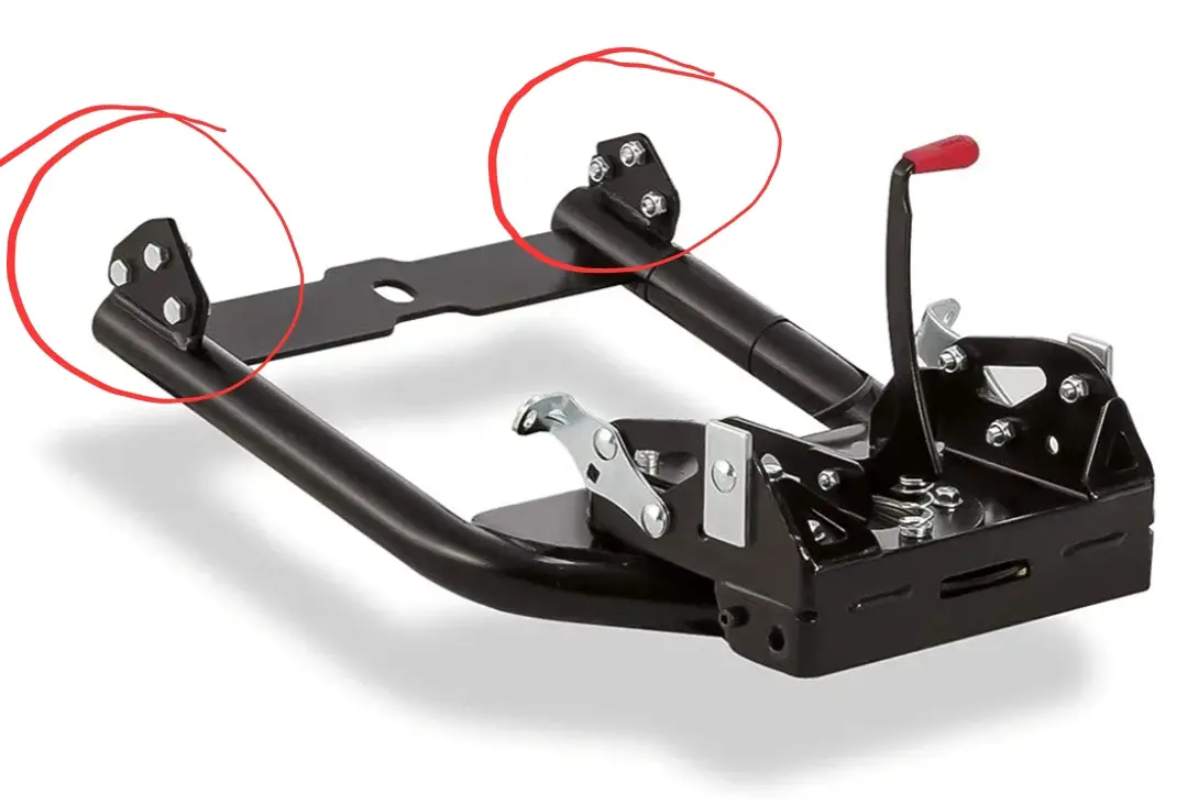

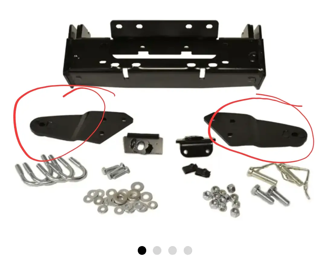

Sorry to go sort of off topic, but I have a warn provantage front mount bracket, and wondering if the KFI blades the same mount pattern?
The Provantage setup is three parts:
Front mount (vehicle-specific)
Push tube (generic)
Blade (generic)
What does the non-blade end of the KFI push tube look like? I highly doubt it will fit the warn front mount. The vehicle-specific front mount includes parts (tabs) that install on the generic push tube, so if you don't have those, you're not even close.
Push tube (generic)
Blade (generic)
I have the whole system... just saw the KFI poly blade and the wheels started turning, but I'll just use what I have until for now.
Ahh, so you have the front bracket AND the push tube. Your post only said front bracket.
If you have the whole system, why do you want to put a KFI blade on it? If you want a different blade, why not get a Warn blade?
I've had my Provantage setup on my Grizzly since '14. It's a solid system.
Why do I want to do anything? Just looking for ways to spend money is all. I just specified I had the front mount instead of the center mount, but all I was asking about was the blade attachment.
Actually, I have a 54 inch blade, and I have bigger tires (27s) and 1 inch spaces all around so I was thinking of going to 60 inches to give a bit wider path when the plow is pitched, and thought the poly might be lighter. I don't really need it, just thinking...
