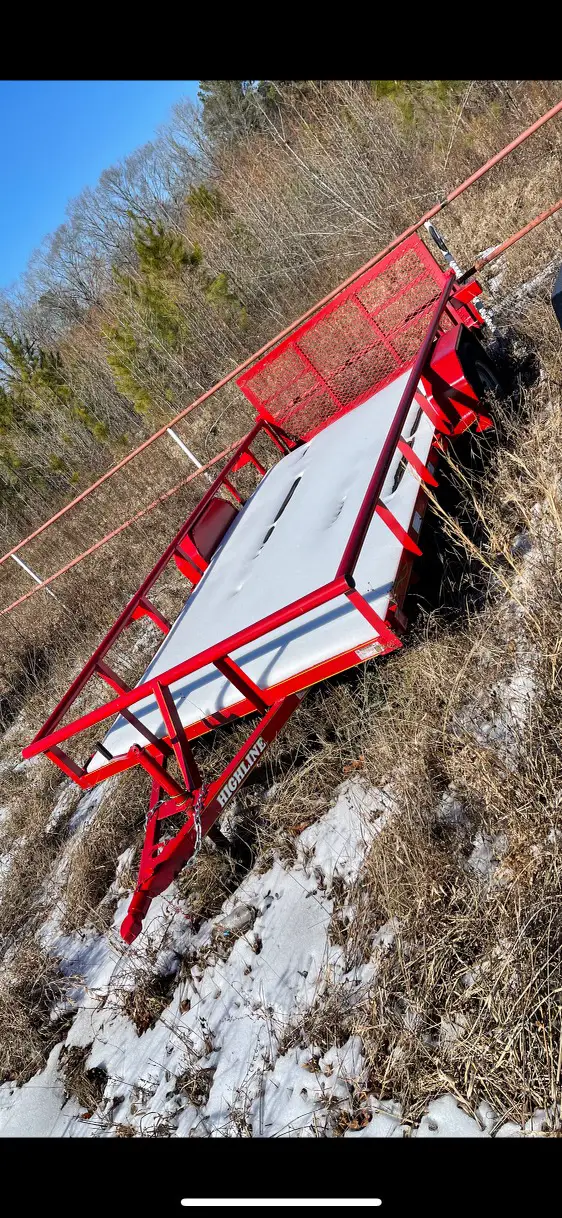

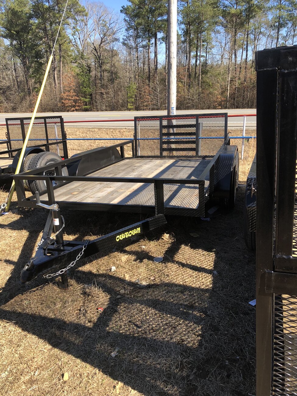

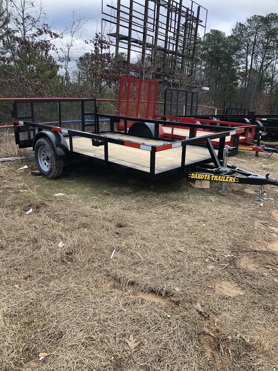

Still looking at trailers for my 1000-5. Found these today, decent pricing, just dont know the reputation of the brand both are single axle. The red one is a 14x76 high line HD with pipe trailer ($1850) and the black one is Dakota pipe trailer 12 x 76 ($1695) Also found a 12x 82 angle iron trailer winch as single brake axle and a spare included for $2100 which is made by cowtown? Any thoughts? Thanks
View attachment 320117 View attachment 320118 View attachment 320121
I built a 16 ft single axle. 3500 lb capacity axle. I bent the axle spindles 2 x hitting potholes loaded close to max. Axle manufacturer said axles are marginal at capacity. Just don't hit a pothole. I put a 6000 axle tube with beefed up spindles never had another problem. Sold that one and got a tandem with dual 3500 lb axles brakes on both. Rides much better. No bouncing like a single. Love it.
Spend the money on a tandem you will love it for years.
