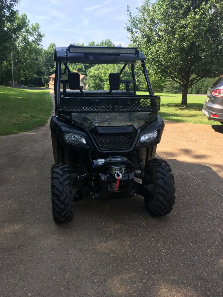

I use mine for hunting on small tight atv trails. I don’t ever go on joy rides. Here is a must list for me.
1. Hard Top because the canvas will rip on low limbs.
2. winch
3. Boot protectors

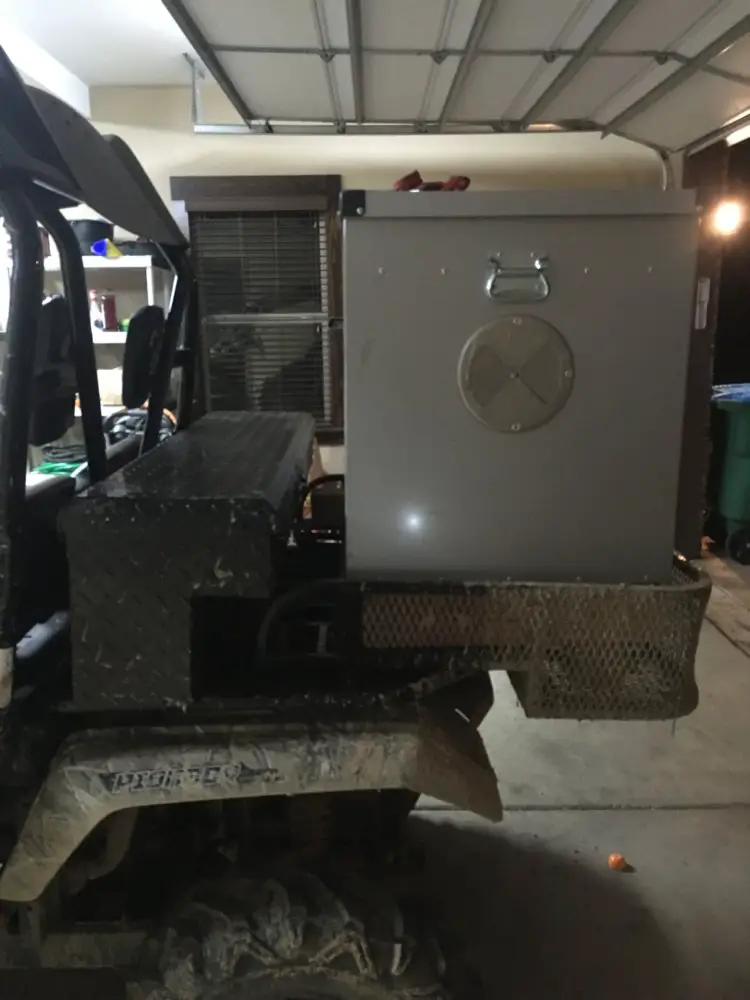

4. The rack setup. Toolbox with a atv drop basket rack. Both can be picked up cheap on Facebook marketplace.
5. Front basket rack from strongmade.
6. The glovebox mod
With that being said you can fit a windshield in there at anytime but the p5 lacks in storage especially for hunting gear.
Good suggestions. My comment is I bought a Strongmade 252 front rack and even when empty, it blocked my view of the 5+ feet in front of the P500. With a hunting pack (or a game bag of boned-out meat) it would be impossible to see rocks or holes in a trail-especially at night packing out an elk . I learned this last season the ‘hard way’.
I moved mine on top. I’m hoping the addition height is not an issue, but Montana is mostly pine trees next to trails.
Added a $50 amazon light bar. If you seal with rtv silicon they’e dependable- I’ve had one on my pickup for over 3 years.
