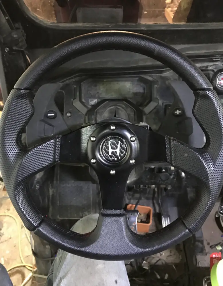

P1000 Steering wheel
Ok deep pockets, get it....:D
Lol and I was happy with the 20$ wheel but @Neohio has me looking to add to the watch list.
The wheel really does make a difference driving, it’s worth a few bucks to get rid of that cheap plastic thing. I was surprised to see Talon with same one but cheap fix

Both of my 1000’s are red and for that I like the black and red that you posted. I agree it’s purely an aesthetical move that will cost all total it looks like just under $100.00. Not too bad I suppose.
Both of my 1000’s are red and for that I like the black and red that you posted. I agree it’s a purely aesthetically move that will cost all total it looks like just under $100.00. Not too bad I suppose.
This is the red/black. I liked it, it was matched to the old seat cover we had but time for a little change.
60845C08 DC66 4391 ABDD F18C4844FE94
I think it’s about 65-70 to do a cheap swap. But then from that point you can change to a different wheel down the road.

I like this one or the one @mjn had. Can you post a link
Type in “steering wheel 350mm” and look through. As long as it says 6 bolt which nearly all do it’ll fit. Dont do deep dish because paddles too far out. Check em out there’s probably something you’d like better
I was just going to add that... make SURE it doesn't say "deep dish". You want hardly any dish at all. I think mine has like 1 or 1.5" dish.
You don't want a hub that fits a Grant wheel, those are 5 bolt.
Going with 14" is only .22" bigger in dia than the 350mm might open other options for you.
Good call. Hadn’t thought about that. There’s a few pretty cool ones.

I have to order a honda horn button too right?
I’d have to say yes lol! But most come with a button I believe. Honda is just a nice touch

All I wanna know is how in the hell did you figure it out? How many used steering wheels did you try to put in before you stumbled on the old Accord wheel??
We have CP to thank for this mishmash of parts that WORK.
Took the factory wheel to the wrecking yard and took steering wheels off (which sucked because of air bags lol) till I found a couple cars it fit. Cross referenced those on line till got a good grouping.
Then started ordering parts. Got it wrong several times but kept trying till the right combo hit. Tried different variations to find something easier or to make better suggestions but I haven’t found it.
I don’t give up very easily or take no for an answer very often. I hate it sometimes because I can’t sleep thinking about something. It’s a f***ing curse
This keeps popping up and teasing me... I’d like a horn where it’s supposed to be.
It’s doable, had button in PJ working. If you have a self serve wrecking yard close by can get it done pretty easy.
I could promise the wheel change is worth the 70$ though, maybe it would keep you off the roof some. Helped me for awhile at least. :(
