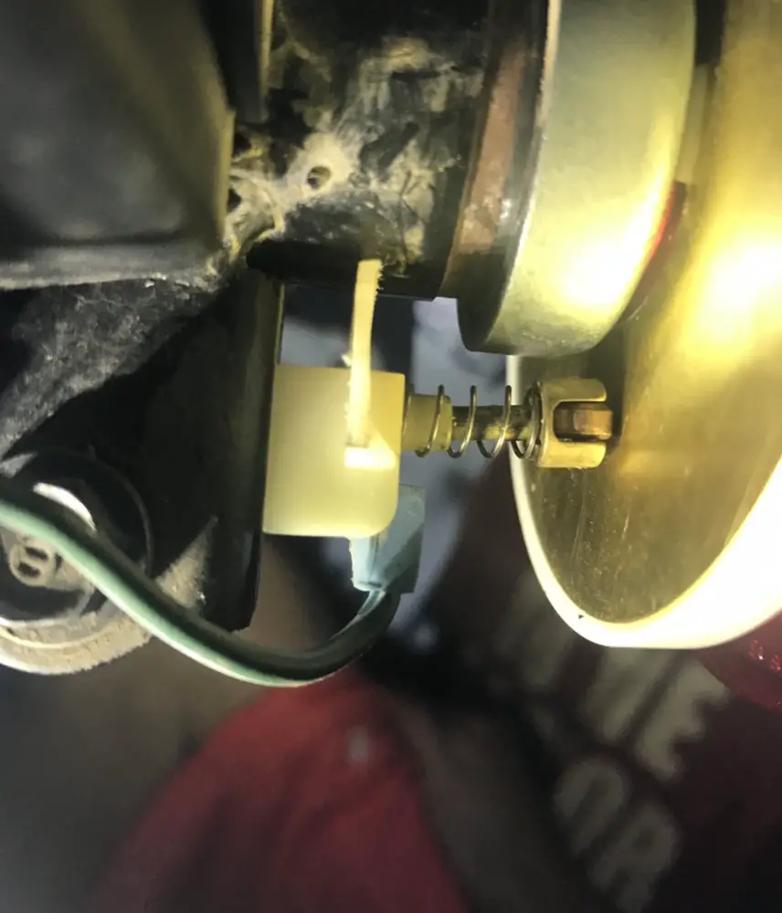

Ya that’s newer cars. Not sure official name of these but maybe horn contact? Anyways they were in older cars. I just retrofitted it to go under and used a 2-part epoxy.
This wire goes to ground side of horn. Positive side is just accessory wire and done.
34E13B5F 1846 4877 AC96 8A1B689147CF
All gets covered with the plastic boot.
F7A40F51 1BAF 427C AB3A ACD55573FFDF

Thanks for the pic that is much more simple. Yea @Neohio I was picturing the new style.

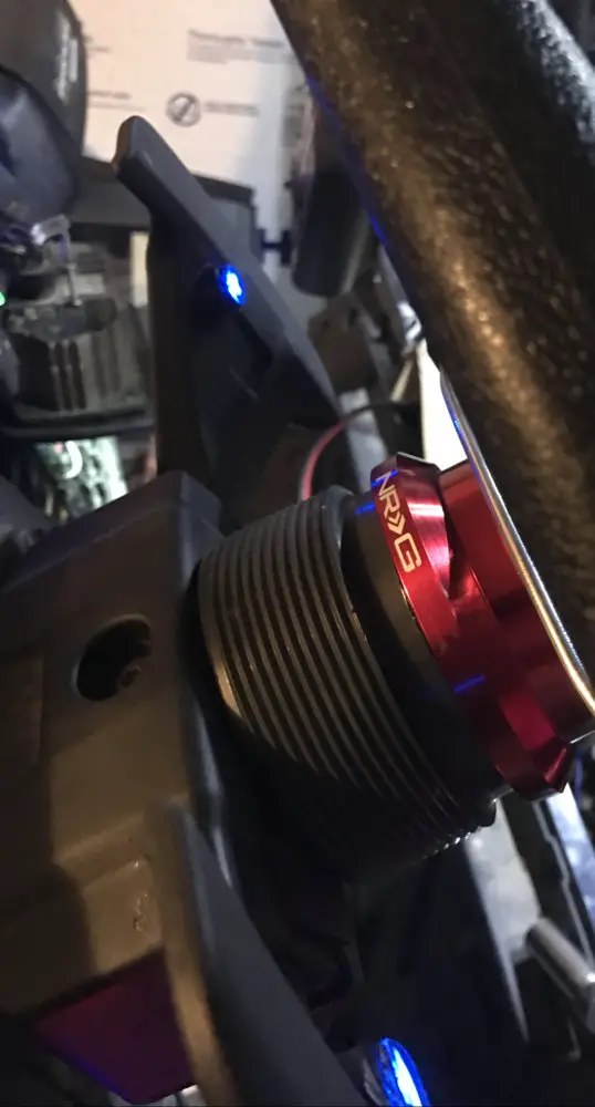

322,956
Use the short adapter. Only use that one for the rubber flange on it
