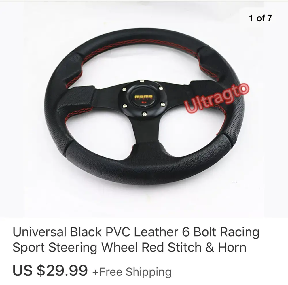

I was wondering if one of these club car wheels would work... it has a 6 bolt pattern.

Pick your 6 bolt wheel. 350mm is very close to factory. 320 works good too but paddles stick out a little. We were 50/50 with what we liked better. I’m going back to the 350 but there’s less choices.
Btw I’m nearly positive this setup will work on Talon and probably would on 500 and 700 as well. If someone tries it report back if you would.

Just went back and looked through my pictures from 2 years ago I did this mod and these were all DIRECT fit to the Honda steering wheel. I physically had that wheel on all those cars. So something seems screwy.
