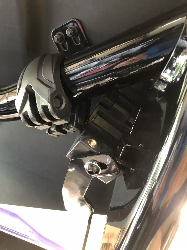

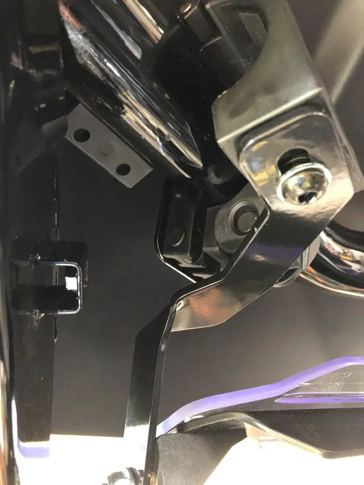

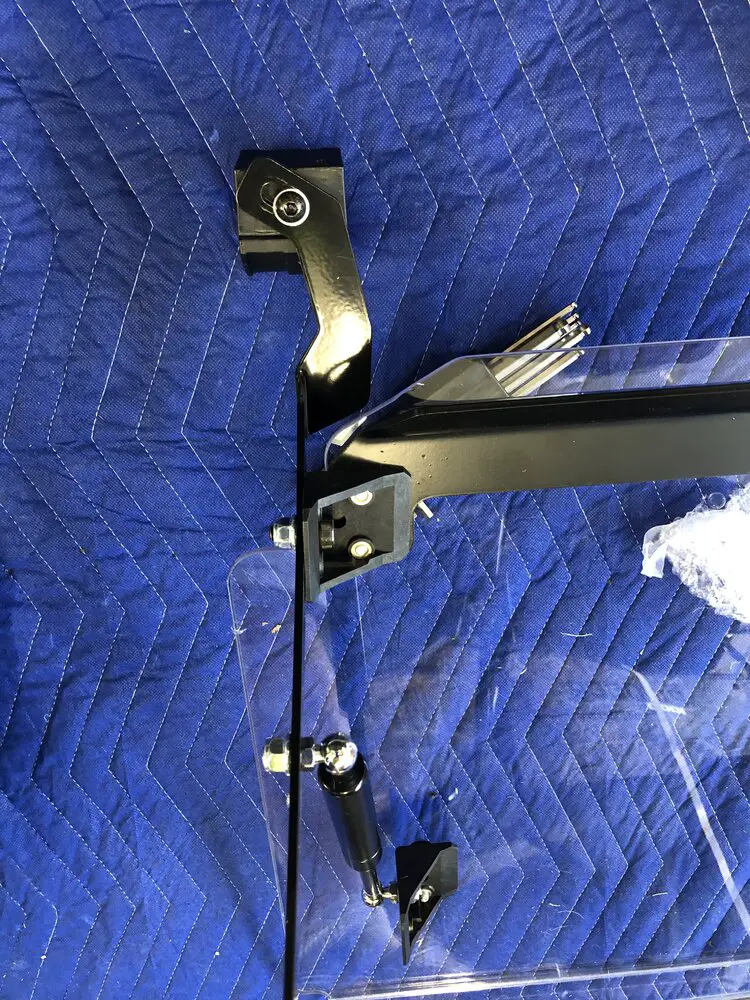

Good evening tribe,
I installed a Honda Hard Top , part # 0SR85-HL4-501 last night. I has purchased a SATV flip up windshield after verifying compatibility in this forum as well as SATV website. The lower windshield installed without Issue, but when I attempted to Install the upper, the SATV clamps interfered directly with the existing clamps of the Honda windshield. I followed the instructions explicitly and even looked at SATV’s You Tube installation vide So I did not cut corners.
I am attaching pictures so that interested parties might assist. Many Thanks in advance for any input you might have.

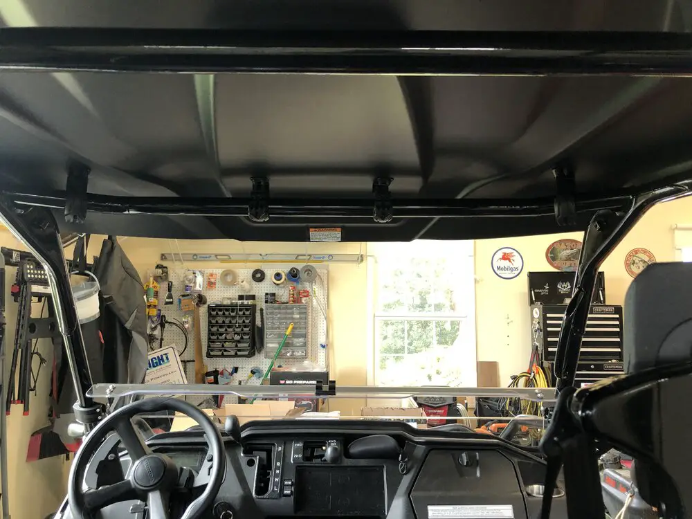

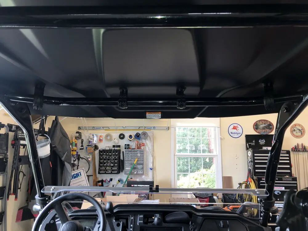

Thank you so much for posting these JD!
Three more questions:
1) Could you Please take a picture from the front with the windshield closed (I am trying to assess the final fit)?
2) Did the installation require quite a bit of finessing?
3) Did You attach all the final hyd. To the pivot mechanism after the install or was everything installed before you installed the upper windshield?

Just installed this a couple of days ago. Already had the factory roof on and had a hard time installing the way SuperATV recommended. I installed the upper windshield arms and gas struts first and then brought the upper windshield up and connected it to the brackets. You will definitely need 1 extra set of hands when you go to put the windshield on to the brackets.

Thanks to all who assisted in this Project; I always get excellent, informative advice through this forum.
1) it does require a bit of thinking through the interference issues before even thinking about installation of the upper Windshield
2) As mentioned, everything needs to be in loose ly fitted,
3) install the hydraulic arms but leave the final pivot point install to the last. I wrapped my ball joints with some of the packing material so as to not beat up the windshield during the upper installation.
4) I disconnect the clamps in the roof in case I needed some wiggle room during the upper installation.
5) aligned the windshield clamps in the open position and Tilted the Upper windshield back and up while at the same ensuring the clamshell clamps came up and behind the ROPS. Them fold them over and secure with a single screw.
6) Performed the final alignment and closed the windshield, made the final adjustments and installed the remaining screws and secured everything .

Good evening tribe,
Spoonbill
View attachment 221321 View attachment 221323 View attachment 221325 View attachment 221326 View attachment 221327
Do you want pictures of my Honda roof clamps with SATV windshield clamps?
It takes some loose fitting but fits perfectly in the end.
