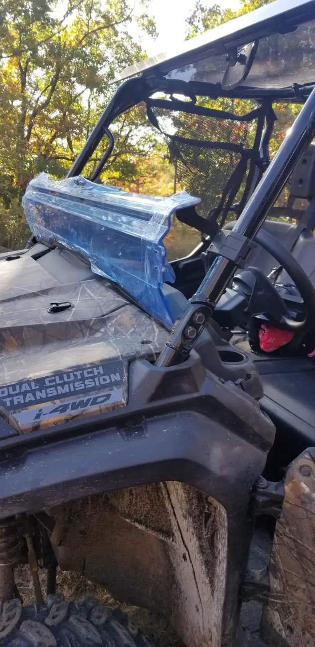

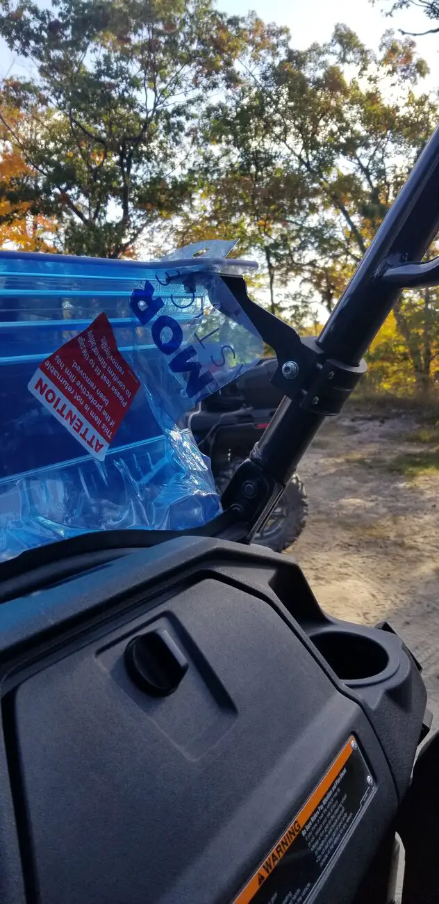

Hello everyone, I have a question. I ordered the flip up windshield from Super ATV and this is how the bottom fits... this just doesn't seem right to me? Did they send me the wrong parts? With this big curve and huge gap, what is the point of having a windshield?
Your thoughts?
This is a 2022 Pioneer 100 - 5
The lower section also doesn't fit the hood very well. At least a 1/2" gap in the center section between the windshield and the hood.
View attachment 358302 View attachment 358303
........like mentioned above, you have the brackets on the opposite sides and also the ROPS clamps have to move down some. Good luck 👍

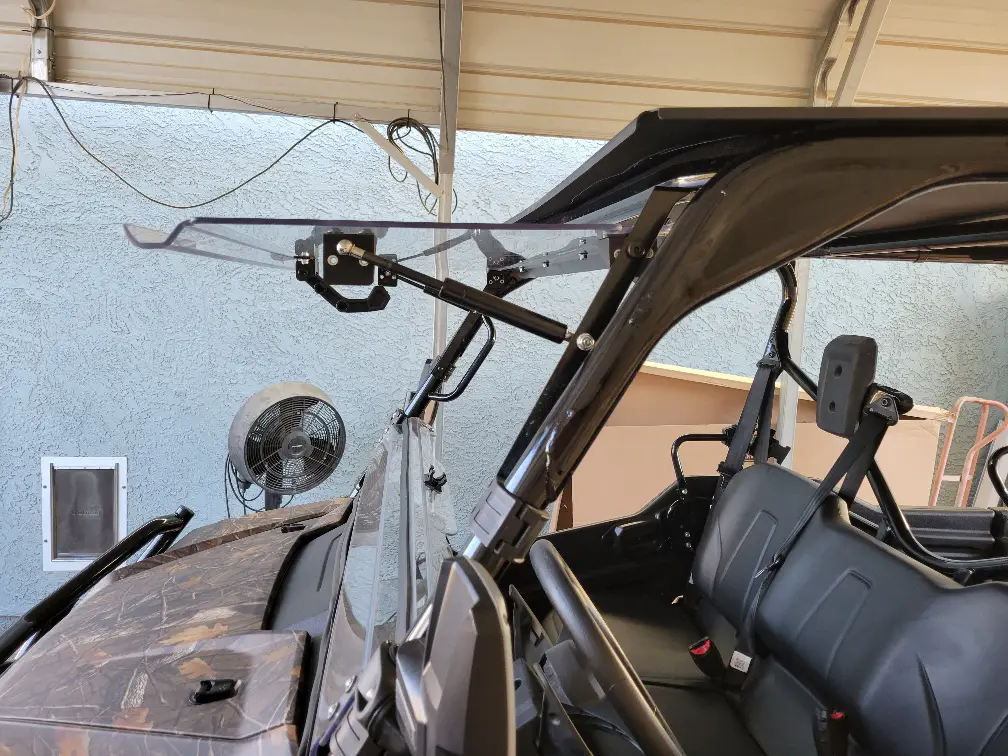

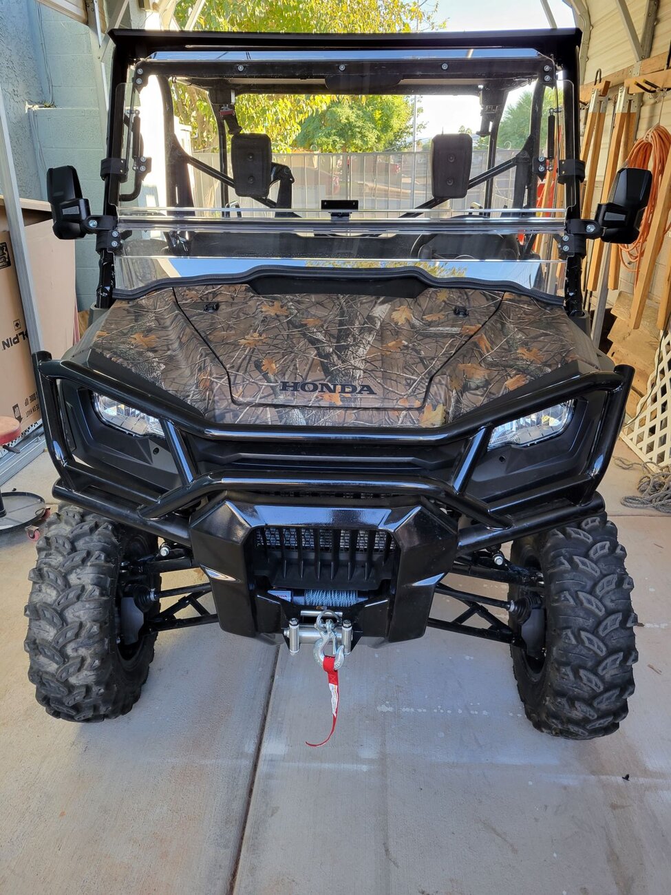

I just installed the SATV Flip Up and the Kolpin Steel Roof on my 2022 P1K5. Install of windshield was easy and fit perfectly. The Kolpin roof was a beast (120lbs) but after figuring out how to use a rope and a pulley from above to handle the weight the install was completed by wifey and I in about 2.5 hours. Roof fit was spot on!

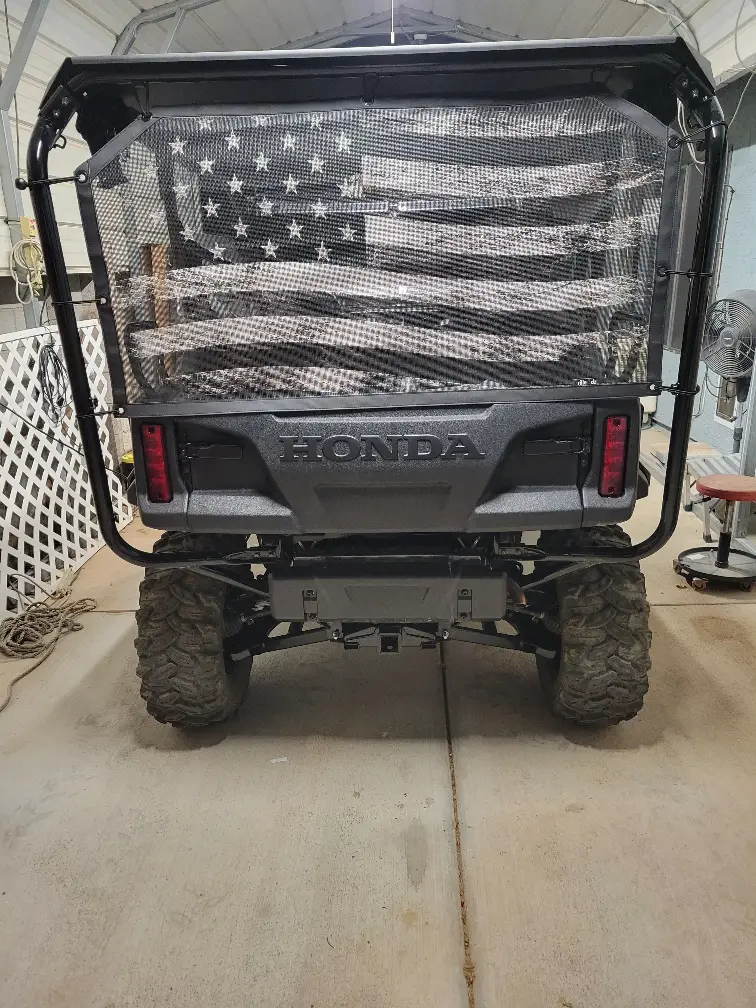

PICS AS REQUESTED.
FLIP UP SIDE
FRONT
Behind
