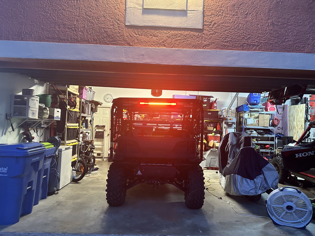

Had some complaints about my chase light being too bright at night so I needed to tone it down a bit. I had some head light tint vinyl laying around so I figured I would give a try. One layer all the way across, and a 2nd layer on the orange. Hopefully that makes it easier to be behind me.
Let them complain. I didnt think they were to bright. I donth see that well though

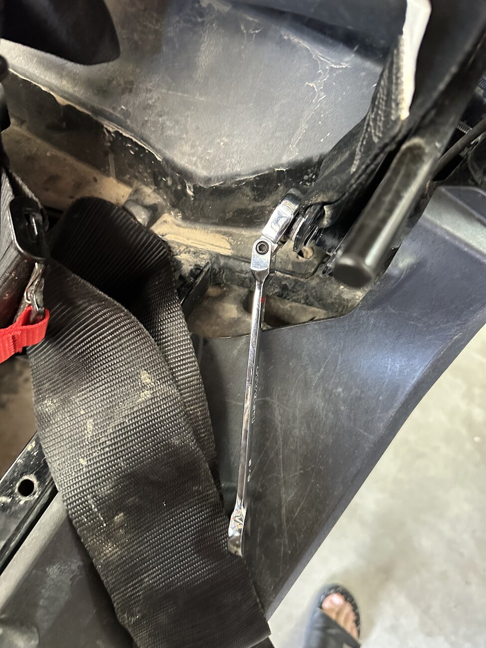

In order to squeeze this thing into the toy hauler I decided to remove the front 1” spacers. This (if anyone remembers) caused the 30” on 5+2x15 wheels to ride hard on the atlas pro A arms. So I decided to add the steering stops provided by SATV.
Not really wanting to disconnect the outer tie rod, I used a 32mm crows foot to remove the inner. Ordered new lock rings (washers?) because the tabs ripped off when removing.
