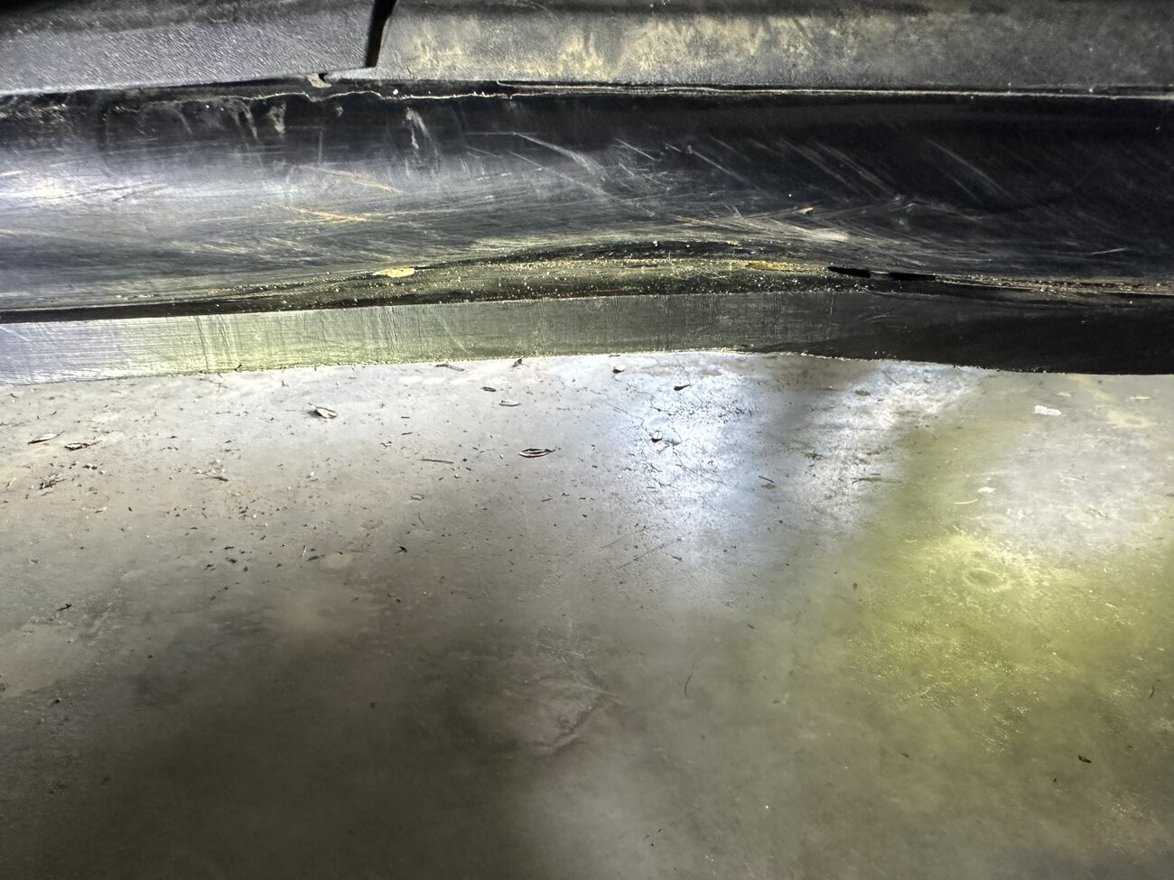

The SATV A arms did come with a steering stop to prevent rubbing which I opted to not install. Without the spacers the 30" 5+2 offset wheel/tires rubbed hard on the fwd A arms at less than full lock. With the RB3 spacers (1" front, 1.5" rear) they easily cleared the A arms but still rubbed slightly on the inner fender well. I suspect 16-21 models would be fine but the added material in the 22+ models reduces the clearance. The rubbing in the front is pretty minor and will likely go away as the tires start to wear.
