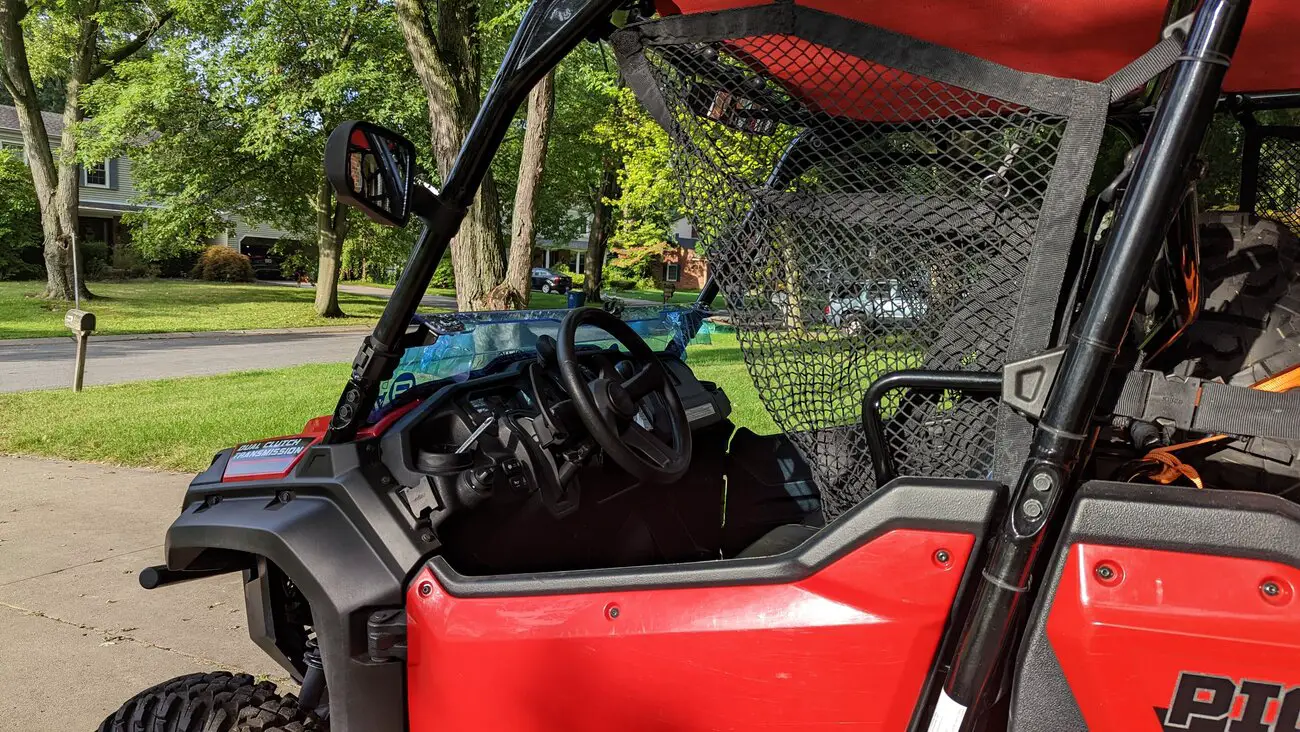

I am in the process of installing a super ATV flip out windshield on My P1K-5. In the first couple lines of the instruction, it says that super ATV does not recommend leaving the windshield installed on the machine while transporting it in an open air trailer. Sounds like a pain to take this thing apart and store it someplace while traveling. I'm just wondering if anybody leaves there upper windshield on while towing the side by side down the highway?
Thanks...Jim
PXL 20220822 124634476
Reactions: SuperATV
Thanks...JimView attachment 350002
I trailer mine with no problems. Others do too. Just make sure you close it when trailering.

Hello everyone, I have a question. I ordered the flip up windshield from Super ATV and this is how the bottom fits... this just doesn't seem right to me? Did they send me the wrong parts? With this big curve and huge gap, what is the point of having a windshield?
Your thoughts?
This is a 2022 Pioneer 100 - 5
The lower section also doesn't fit the hood very well. At least a 1/2" gap in the center section between the windshield and the hood.
Flip up 1 Flip up 2
