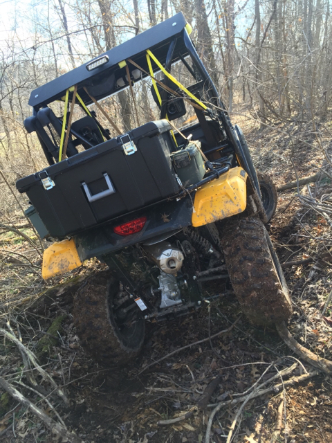

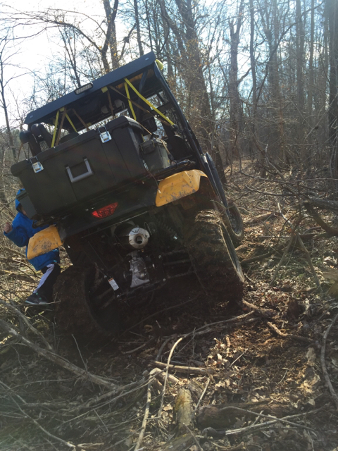

Ok I ran a run with the swaybar went to the hill with the vine that I almost rolled it on. Stopped on the vine the front wheel was barely touching the ground and with 1 finger I could tilt it 3-4 inches off the ground. With the sway bar detached and ziptied up same spot I stopped on the vine felt slightly less tippy the front tire was touching the ground (not barely like before) and it took a few fingers to get the tire 3-4 inches off the ground. Driving back the fast trails full speed 40-41 weaving between brush dips and rocks (tight trail) you could feel the difference with it disconnected it 'swayed' or dipped more nothing scary. I was weaving back and forth if I added another 10-15 mph and tried that I think the bar would be a big help and would clearly be needed. I could not drive any faster as that is all the faster it goes. If the trail was more open than barely fitting my P500 I would not need to weave like that and on the open road at full speed it felt fine. If I drove crazy like that on those kind of trails all the time I would reconnect it. With it disconnected the smoother ride and I feel better stability on rocks and inclines I am keeping mine off.

I don't have great pics and I could take a pic of myself tilting the buggy but this is steep and you could very easily push it over.
This is before swaybar disconnected.

This is after swaybar disconnected front wheel is more on the ground and still easily to push over but not very easy. When I got back it the first time just sitting in the drivers seat ( downhill side) you could feel the front wheel pick off the ground

Thanks for the detailed report and pictures. After reading your post and seeing the pictures I think I will disconnect mine and see how it works for me. With the disconnect one just needs to keep that in mind when traversing a steep hillside. We ride so many rocky areas the smoother ride would be a plus allowing the Independent suspension to do it's job.
