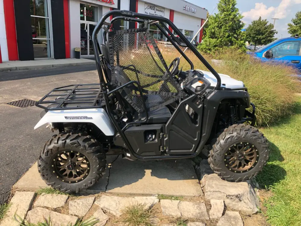

So, I came one step closer to buying a pioneer by taking one for a test drive today at a local dealership. It has aftermarket "system 3" 14 inch wheels with 27x9 & 27x11 maxxis vipr tires. My first impressions were, I was shocked at the peppiness of this little machine, even with the big tires on it, and the ride wasnt as bad as I was expecting. I also see the need for an unlocking rear diff. Anyways, my questions are
1) from what I understand, the pioneer isn't a dual clutch?
2) if I'm correct on question above, should you not shift in manual mode at full throttle? Or does it make any difference at all?
3) are these tires too big/heavy in your opinion for this machine? Love the looks, but worried about all that extra mass on the drivetrain.
Thanks to this forum, i know that what this dealer wants $$ is way above what many on this forum paid, so going to keep looking and doing my research until a great deal pops up. Thanks for the feedback in advance!

Hello!
It is not a dual clutch. Its essentially electric shift on a honda quad.
I hardly ever lift off to shift.
No, I'm running even larger and heavier tires and don't notice a thing.

12" wheels with the advantage of the larger sidewall will give a better ride compared to 14" wheels with the same tire.
The P500 is not dual clutch. ... The electronics will cut the throttle for you during full acceleration shifts.
Plenty of guys run 27's on the P500. Stock setup - 1st gear is about useless so worse case you'd just use 1st more often. I'm still on my factory tires though so others could have a more informed opinion on this.

It should handle the 27" tires just fine but a 12" rim will give you a better ride as @JeremieBaker said.
Although you dont need to lift on the throttle to shift, I do because it seems to shift smoother for me.
The 500 is not a dct but it does have two separate clutch systems. There is a centrifugal clutch (wich allows the machine to idle while in gear) and a set of clutch packs that shift the transmission.
I hope you find the right machine for you, they are pretty awesome!

I run same size tires, no problem. The computer automatically retards the engine during shifts. You can’t hurt it. As said by many, aftermarket Power Steering and a TorqMaster front locker makes it even better.

Thanks for all the feedback guys, sounds like stock 12" wheels are the way to go then, and good to know on the shifting at full throttle!
Front diff lock and power steering will be on my want list, but probably after winch, tires, & plow.
Thats the 2nd time ive heard someone recommend Toledo Honda, ive also heard lexington ky has a dealer that will cut a really good deal
Id be willing to drive to a neighboring state if I was saving $500 or more. This local one I test drove was sharp, and im sold on the white color, but it looked like it'd been stored outside which is a redflag for me, it had bad rust on the inside of the frame tubes on the rear. I wont be afraid to use my machine, but im not gonna leave it out in the weather either
