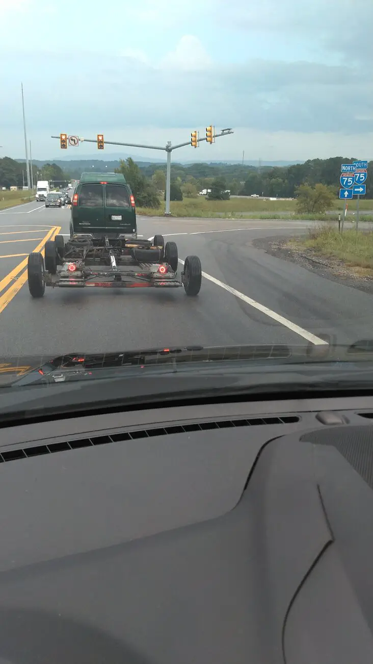

Doubles is legal in TN. But what about triples.
When I picked up my project F150 in Omaha a few months ago…
There was a pair of 2000’s 1/2 ton Chevy trucks with TX plates that each had this setup. They were picking up 4 damaged front wheel drive vehicles from the IAAI yard.
They took the rear bumper covers off of two of the front wheel drive vehicles and then “installed” (lol) a hitch on the metal impact bar that they just removed the covers on. The installation consisted of self tapping screws and chains.
They then put the disabled car with the newly installed DOT (not) hitch apparatus (looked like it was made from pig iron and tposts) on the first dolly and connected the second dolly to the rear of the first car, and then put the second disabled car on the second dolly.
Had to have been a long miserable drive pullling that swaying assembly back to the border lol.
