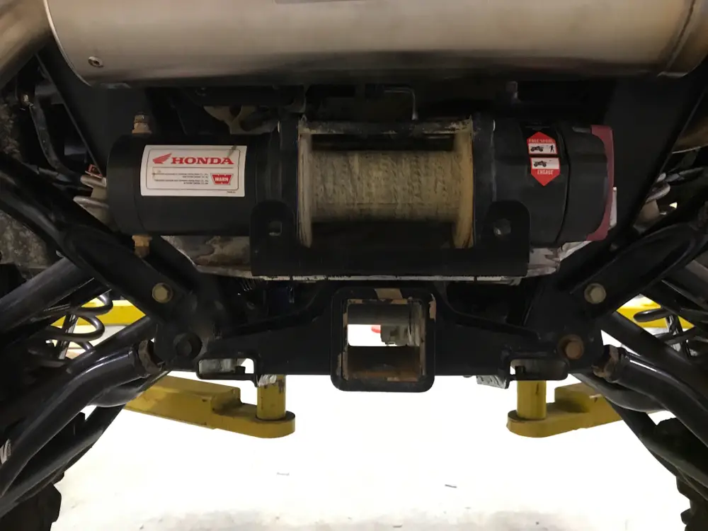

Here's a picture of my old front winch positioned in the rear of the vehicle.
3e134768f2a62514de47d7a4b1671020
Clearance from the muffler is tight...

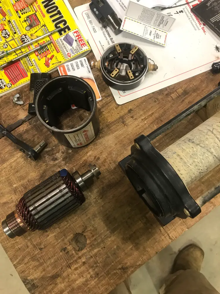

Next was to clock the terminals so there's no clearance issues at the frame. I wasn't real sure what I was doing here as I've never done that before and I don't have any instructions. But I just took the motor off and turn the whole thing and put it back on

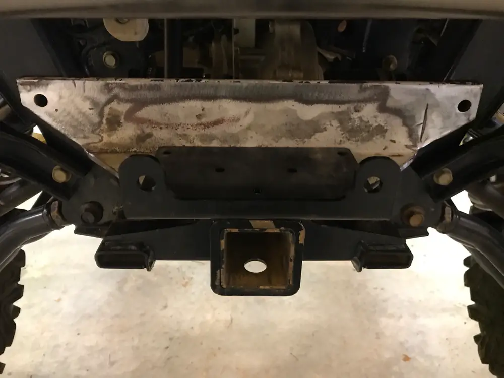

I started making a bracket for the winch mount. I had some leftover angle iron from a previous project years ago and it is quarter inch thick which is quite a bit stronger than the winch plate that come with the winch. Not sure if this is the final version or not but it probably is.
So far I have only cut the metal to the shape I wanted and drilled the upper holes for the mounts.
C8be61d1f7d9dac2232d48643d1c9929
Dc8a767fdb59925447072d57422f668b
It will mount on top of the hitch and use two of the rear suspension bolts.
