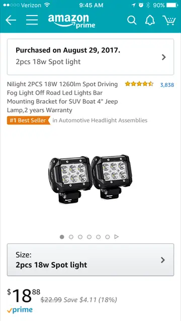

Joey, on your fender lights are you using a light with a single bolt mount that attaches to the sides of the light?
Reactions: DGann and sharp
39,129
Yes, you have to replace the stock fender bolt with a longer one.
