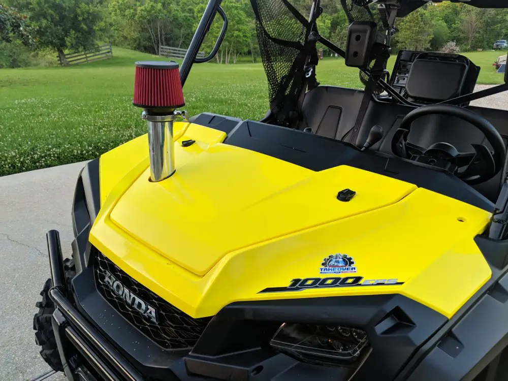

The rowboat finally made it! Thank you all again for all the info to get it done. Came in handy Memorial Day when I fell off in a hole that used to come up to the center caps and it had turned into a headlight level hole. Also learned that relying on my in-door storage for my recovery gear sucked when that door was mashed into the bank.

Looks good. Hopefully that saves another motor from Hydro lock

The rowboat finally made it! Thank you all again for all the info to get it done. Came in handy Memorial Day when I fell off in a hole that used to come up to the center caps and it had turned into a headlight level hole. Also learned that relying on my in-door storage for my recovery gear sucked when that door was mashed into the bank.View attachment 133013
I like to keep recovery gear on both sides just for that reason.
Yep, added a strap, tree saver, shackles to the other side as soon as I got home. What's funny is there was a stock 700-3 down in the little creek run I got stuck in. Water was prob 4-5" up his tires so I dropped in and immediately sunk to the headlights. Found out he had just finished winching through and asked if I knew how the hell to get out, lol.
