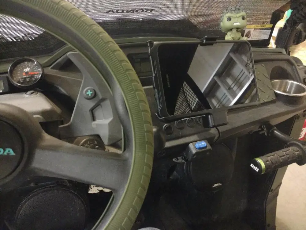

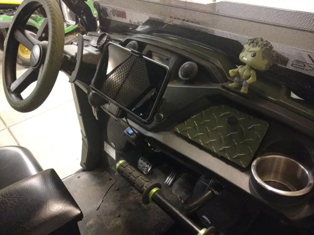

Active Tab 2 is Samsung, has an IP67 rating. 1" RAM ball mounted to the dash. Powered cradle is hard wired and keeps it charged all the time, never have to plug in. Shortest arm I could get keeps it from bouncing all over. Here's my setup...
P500 - Where and how do you mount your cell phone or tablet?
I have a similar set up. Just used the short 1” ram mount that’s bolted to my dash and a very short adjustment arm for different angles. I already had a OTTER box on my old tablet that protects it, just bought a rugged ram mount tablet holder for 25$ on amazon. I do like the ability to have it hard wired somehow. Usually my charge last all day. Can u easily remove it so knowone steels it or so you can take it in for updates? How did u do that?
Trigger, Think I'm getting it. Assuming an AMPS pattern for the 1" ball bolt-down with a short arm. Assuming you used a steel backer behind the ball on the dash? Smallest backer plate I can see is 2.6" X 2.6". Is that correct?
