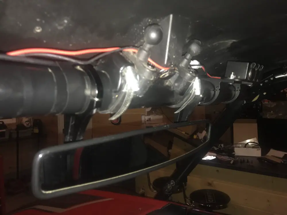

I agree that it will vibrate a lot with that setup. On my 500 I mounted from the roof where the metal bracket is in the center. It did well but still vibrated some. In the Talon I mounted to the rollbar in the front. I used two ram mounts around the rollbar with two connecting arms on and X-grip. Works awesome up out of the sun and dust! Here is pics of the Talon setup. View attachment 135514
Vondy, that looks awesome on the Talon. To clarify those are two RAM ROMS clamps (1" ball) suitable for the Talon rollbar diameter?

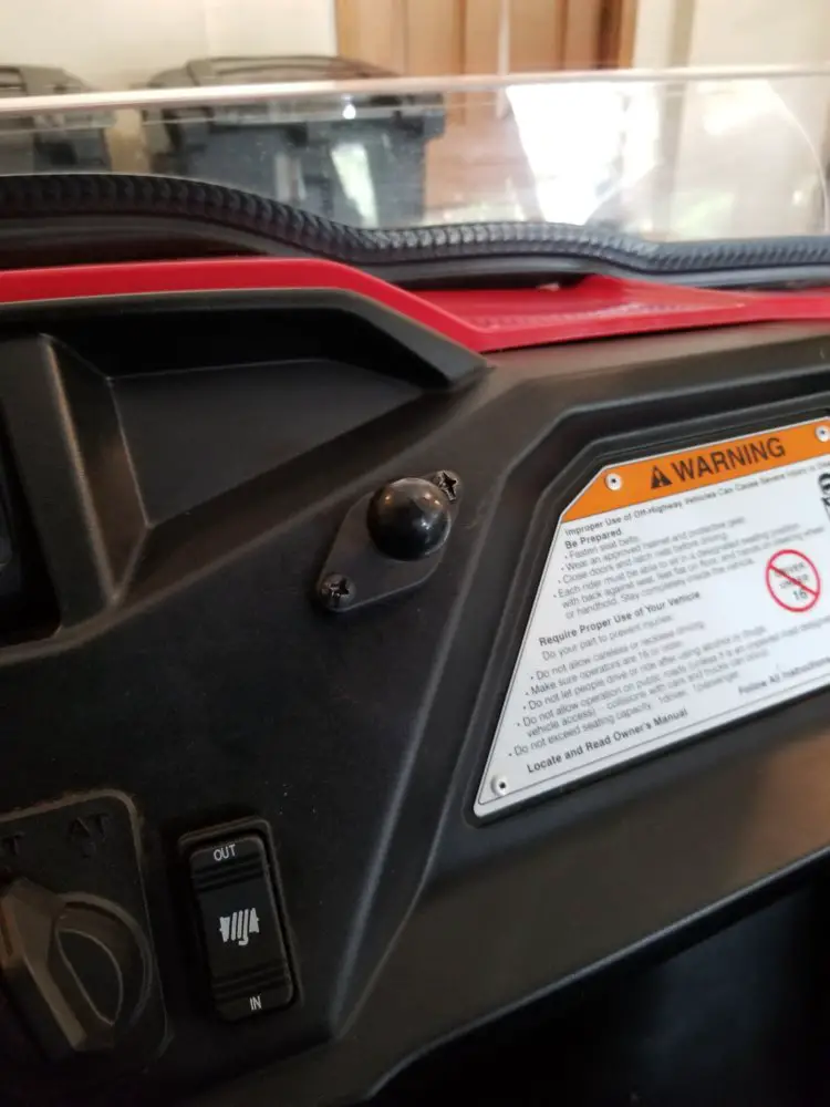

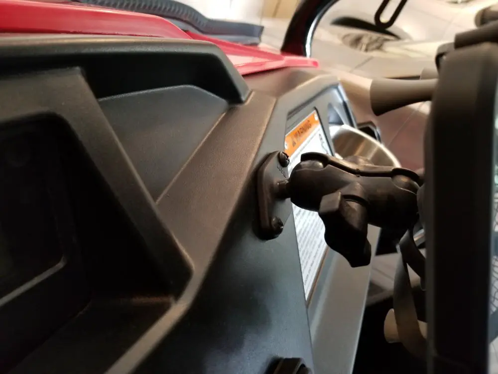

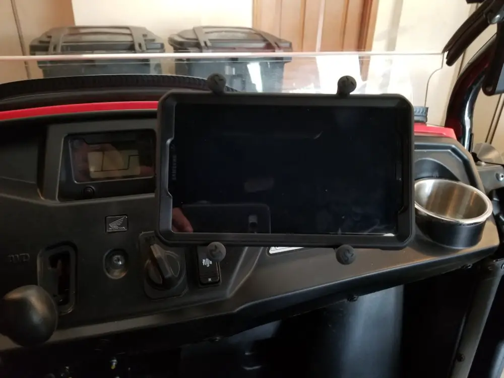

All,
Thanks for your help on this. Got all the gear and borrowed the mounting technique suggested by Montecresto:
1) Diamond head 1" Ram ball mount to dash, (2) 3/4" pan head hex bolts, fender washer, lock washer, nut (avoided other accessory cutouts under the hood)
2) 1" double socket Ram short arm
3) 1" Ram X-Grip for 7-8" tablets
4) Samsung Tab A 8
5) Supcase Unicorn Beetle - Samsung Tab A 2017. Anxious to give it a spin and see how we do. Picture follow. Thanks again, GMac
Mount Lil Red 1 Mount Lil Red 2 Mount Lil Red 3

All,
4) Samsung Tab A 8
View attachment 138241 View attachment 138242 View attachment 138243
Quick follow... Two half day runs using Colorado NF Mvmu's on Avenza App. Rock solid. Tilts toward driver but wife enjoyed having it in front of her as well. 8 in is a good screen size. Pleased with location. Gmac

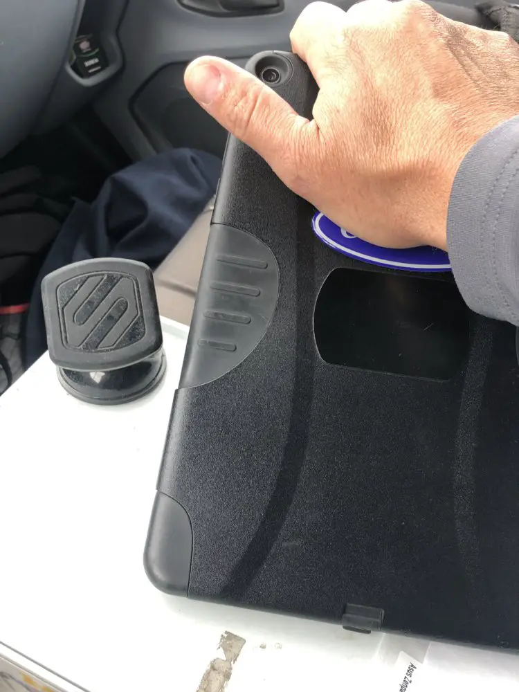

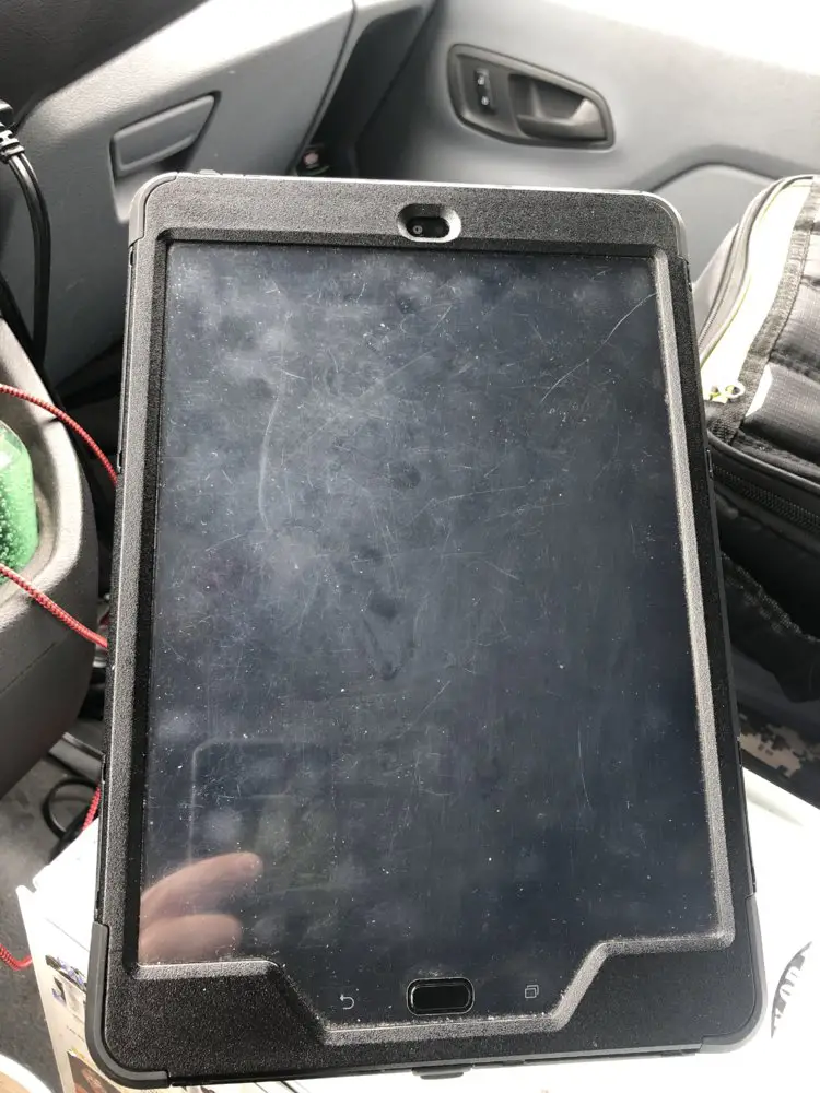

I have that same magnate thing for my work tablet in my service van. Works great for that and regular driving. If I slightly bump the tablet it will fall off. I think with off road trail riding it will wind up being a PITA with the tablet falling off at every bounce. Just my opinion.
This is the plate on the back of the tablet and the suction mount.
You were right, this type of mount worked in some situations but not all. I have since bought the RAM mount and it is the way to go.
Vondy - did you buy 2 of each of these?

I used 2 of these https://www.amazon.com/RAM-Coated-U...up+to+3.15"+in+Diameter&qid=1617726988&sr=8-1
I upgraded the X-grip to a different mount. I had it mounted over head tilted down and on hard hits the tablet would fall out. I upgraded to this one. I didnt use the mount part of it, just the piece that goes around the tablet.
They you'll need two arms. I think this is the size I used.
Thanks man - much appreciated! I am just trying to check things off of my long list and this was one of them...
