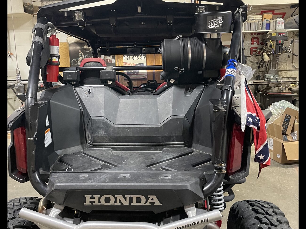

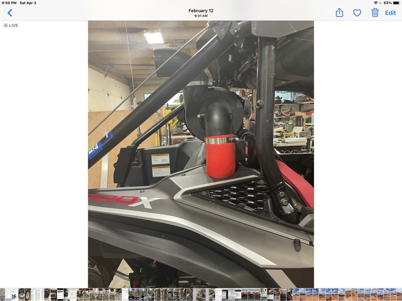

It was very over priced, for what it is. It sucks they want you to run the stock exhaust, and their air filter design is terrible to service. I did a similar Donaldson system as the previous post, but used the “top spin” unit on top of the Donaldson canister . Also used intercooler hose for a cleaner look. Also replaced the stock pistons with 9:1 forged pistons. I’m currently waiting for Erik at PPei to get the tune perfected to run a pipe. He has many hours of dyno time with the Talon, and is getting really close to releasing a tune that will get over 200 hp at the rear wheel. Sounds like a bigger fuel pump and injectors will be needed for the added HP.
View attachment 322511 View attachment 322512 View attachment 322515
Any chance anyone has the part numbers for this Donaldson/Top Spin Setup? I'm about ready to take the copper vitamin trying to clean the Jackson setup and there upgrade doesn't really make changing/cleaning the filter any easier. Thanks, I tried to lookup Donaldson 3" cartridges but it was rough.

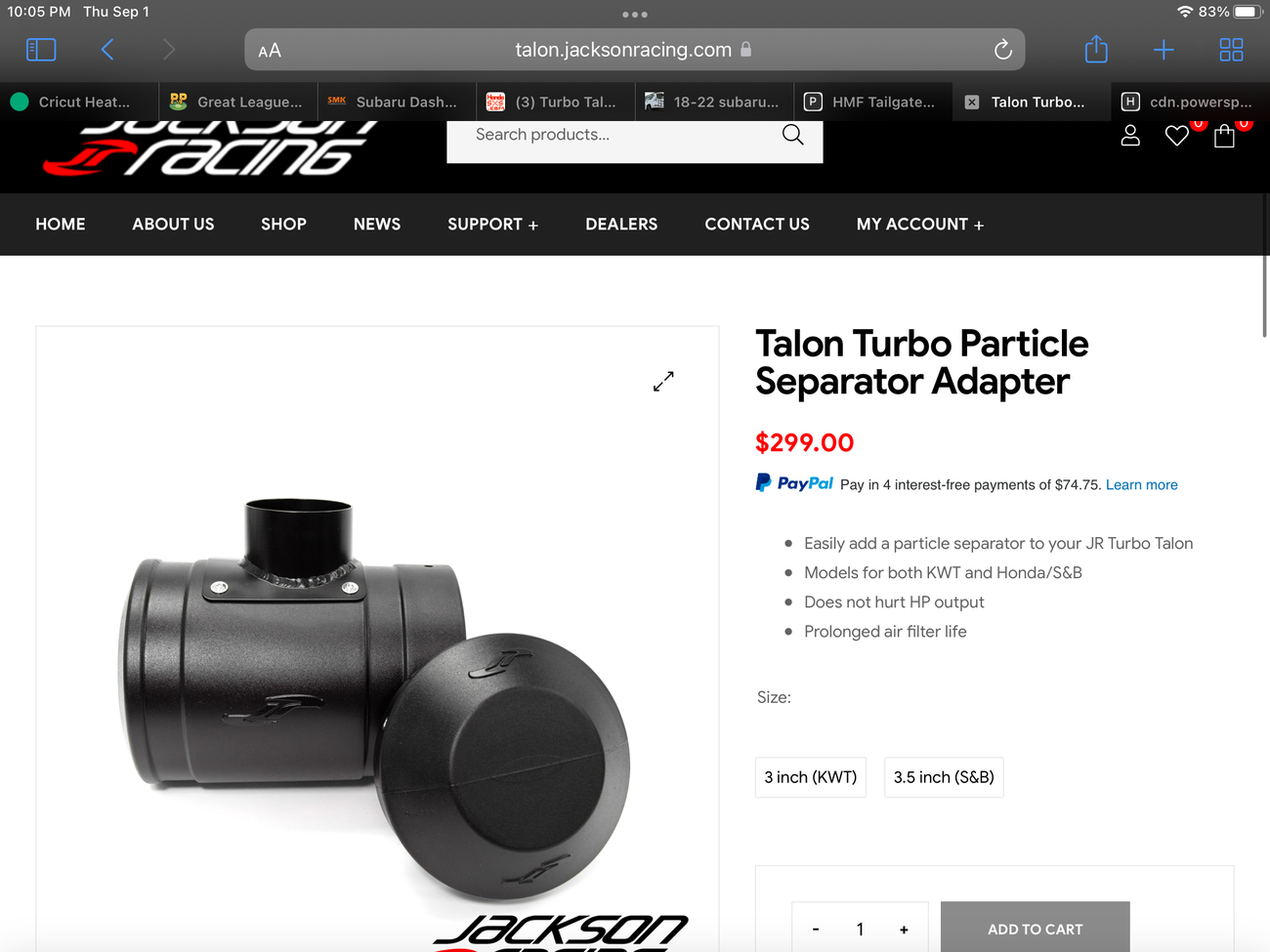

I'm going to give Jackson a call today and find out what you get for $299. You'd still be stuck having to pull that damned fender liner out is my complaint.
EDIT: Just spoke with Jackson about the upgrade. You get a complete new filter housing with the flange/adapter and solid cover.
mmjsport
Apr 23, 2021
61
195
California
Being able to use the particle separator with a pre filter would be awesome if that’s even possible. If so, it might make the stock filter last a longggg time.

i had an S&B before my stock jackson filter. yes it helped but the K&N is junk. and still dusted my engine. after i researched and got the donaldson installed no more dust issues.
