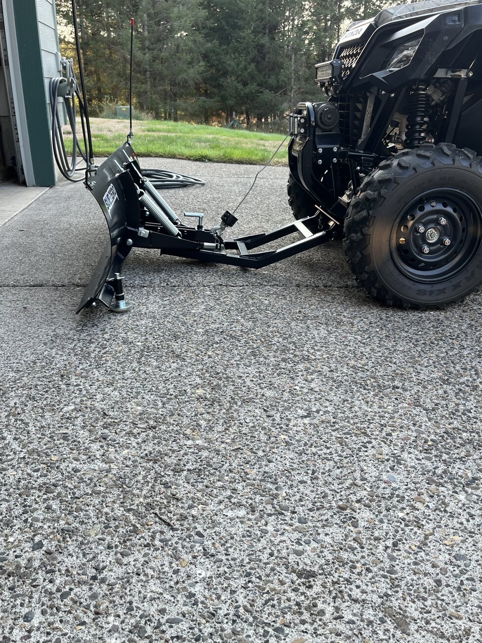

Okay, four years later I finally purchased the Tusk Sub Zero snow plow kit. Not sure if I received the incorrect push tube. The push tube sits about an inch off of the ground with the skids on. Take the skids off and the tube is on the ground. Anyone have experience with this?

That does not look right to me. For the proper geometry for the blade to swing left and right, you want the plane of that pivot mechanism to be parallel to the ground when in use.

Wow…that doesn’t look right at all ….the plow is really really out there in length! Along with the incorrect angle, the length will put an enormous amount of torque ( moment) on the frame when you turn.
I don’t think you have the correct push arm assembly. That one looks like a rear or mid mounted type.

That tube assembly might look like it should be the setup if you had tracks put on?

I sent pictures and measurements to RM ATV. I am waiting back to hear from them.
