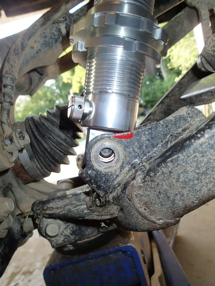

First issue-- rear stock a-arm mount needs a trim:
P6043773
Trimmed, blended, primer and painted:

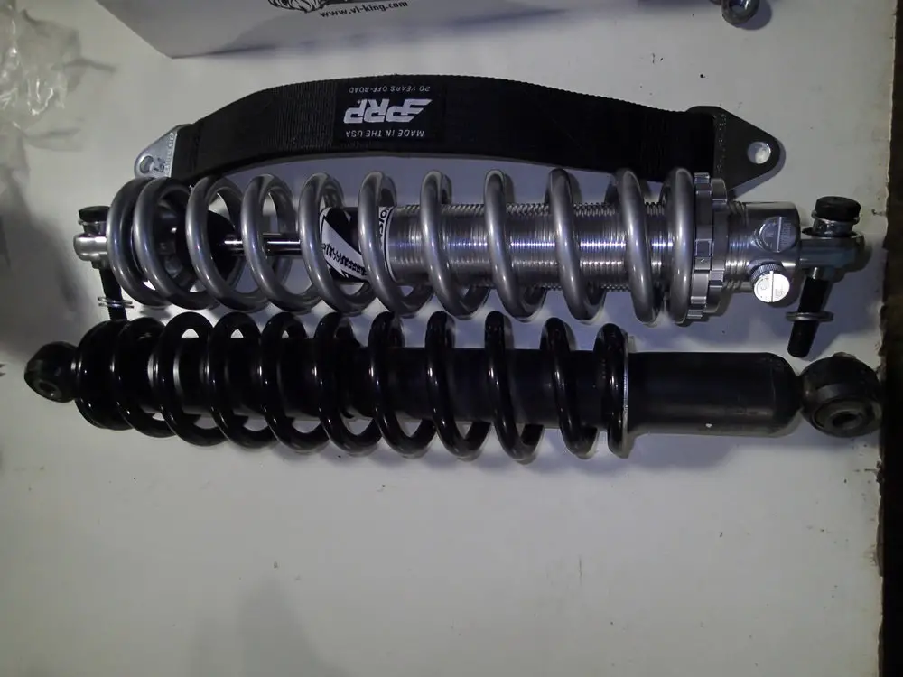

Fronts were good to go, spent some time trying to get my cheap snap ring pliers to work, my good sets were too large for the shocks, ended up filing down a pair of knipix to work... Wasted a lot of time
Picture of 814 next to stock front:

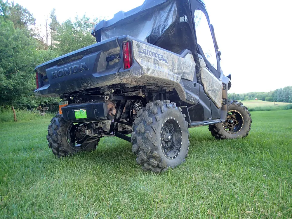

Rears mounted up, I think I could crank them up just a touch still: (Note: muffler heat issue melting orv stickers :))

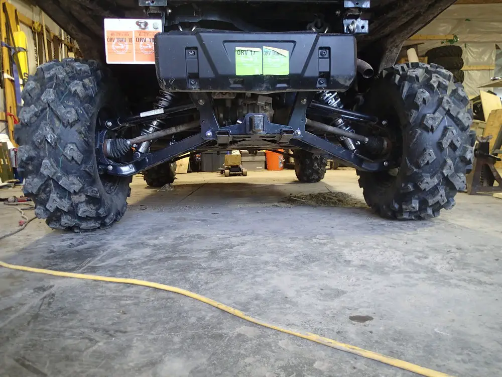

Fronts on, plenty of clearance on everything:
P6053783

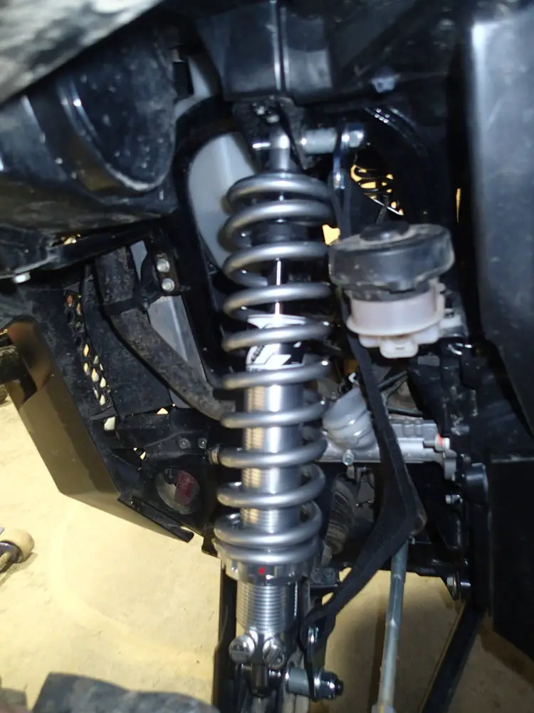

Bolts I picked up- I really only needed 8 nylocs but wasn't sure how I'd run it, needed spacers as the shank of the bolt didn't have enough thread to put nuts on tight to the mounts under the straps.That was all of the stainless metric washers they had. I cut spacers about 3/4 '" long from some tube I had in the scrap bin.
P6053792
After a couple of test runs thru a freshly baled hay field, wow what an improvement. I started at the recommended 6 & 8 clicks on all the shocks and it is great, body roll is reduced, it is way smoother on the rough patches, can't wait to really test it out.
