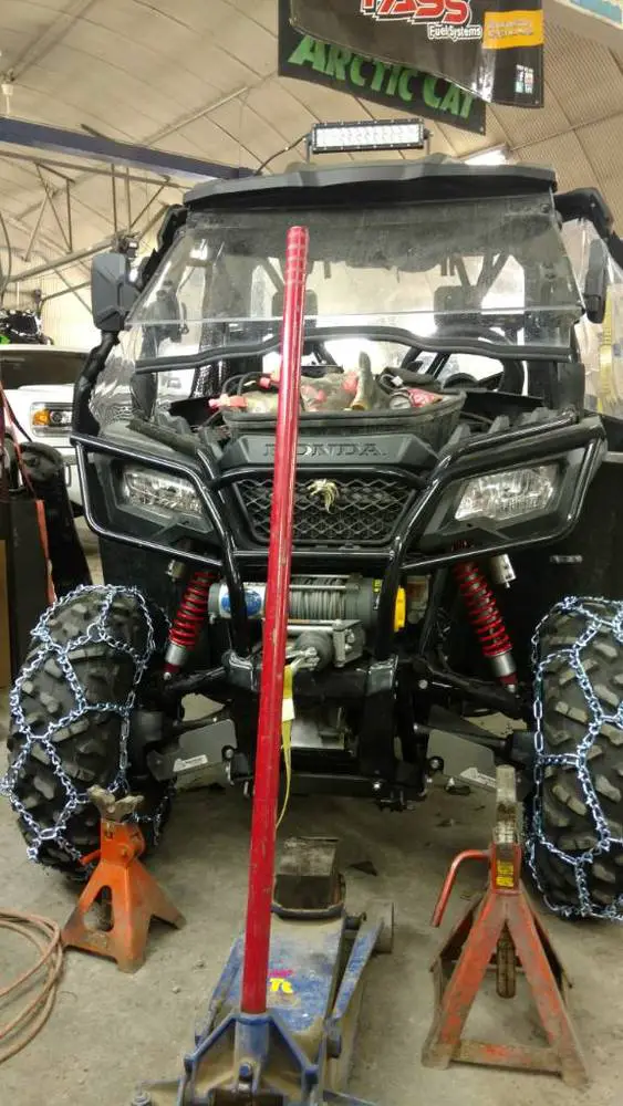

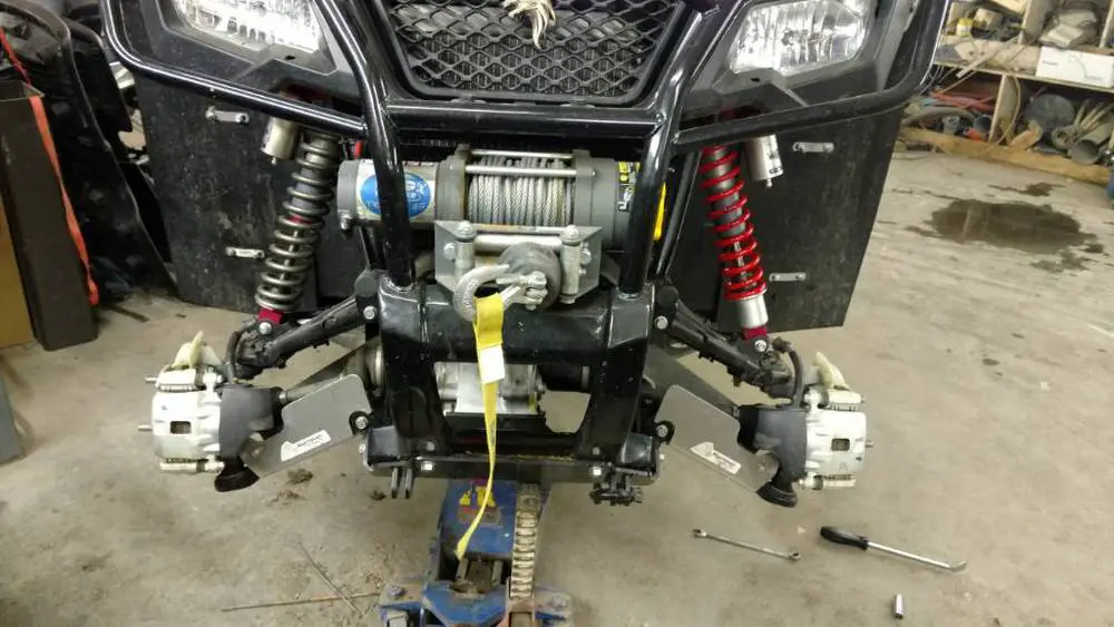

I agree that the front shocks make up 80% + of the P5's ride. Just replacing the front helps a lot!
After having WE shocks on the front of mine for 10 months......

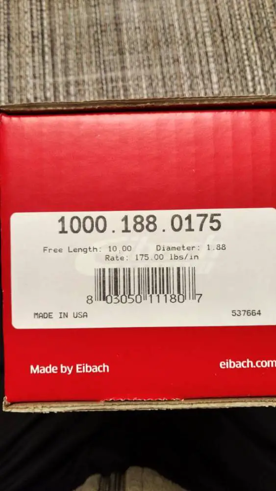

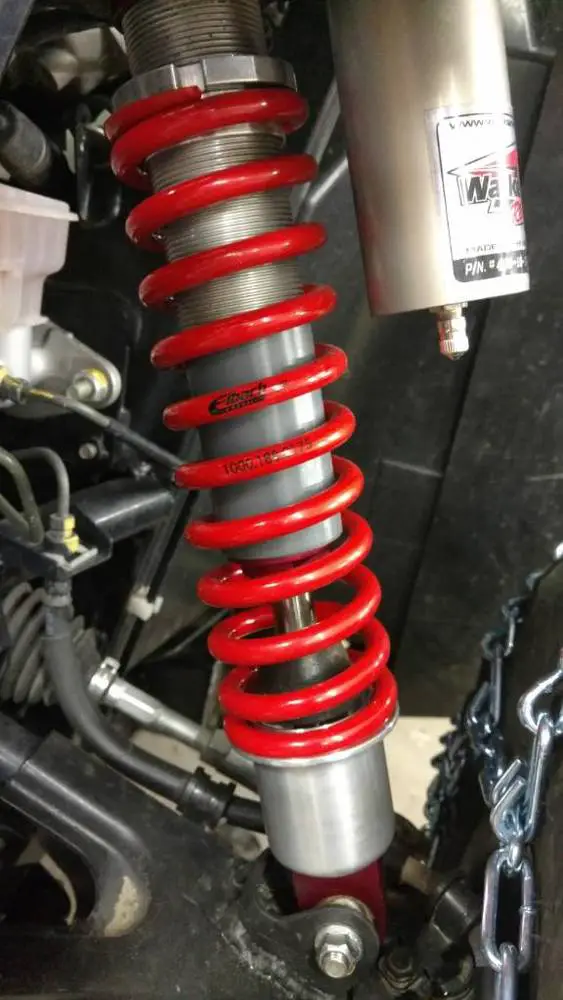

my opinion is that 250lb springs are too stiff for the front.
The 425HD progressives (with 110-160lb spring rate) that some guys here have on the front ,are fine,and give a correct ride height with little, if any, bottoming out.
The WE shocks has adjustable compression control which adjusts with just a turn of a button to prevent bottoming out. I'm finding that you have to ride very aggressive to need to turn that 16 position adjustment up to position 5 or 6 . A softer spring should allow for more movement at lower speeds and improve ride even more ,while allowing you to adjust compression adjustment for terrain. Right now the faster i go the more that those WE's soak it up. I want to soften the low speed ride even more.
however,
even with those 250lb springs the ride is worlds apart from stock
@solrus changed his WE shocks to 175lb springs. Maybe he'll comment
