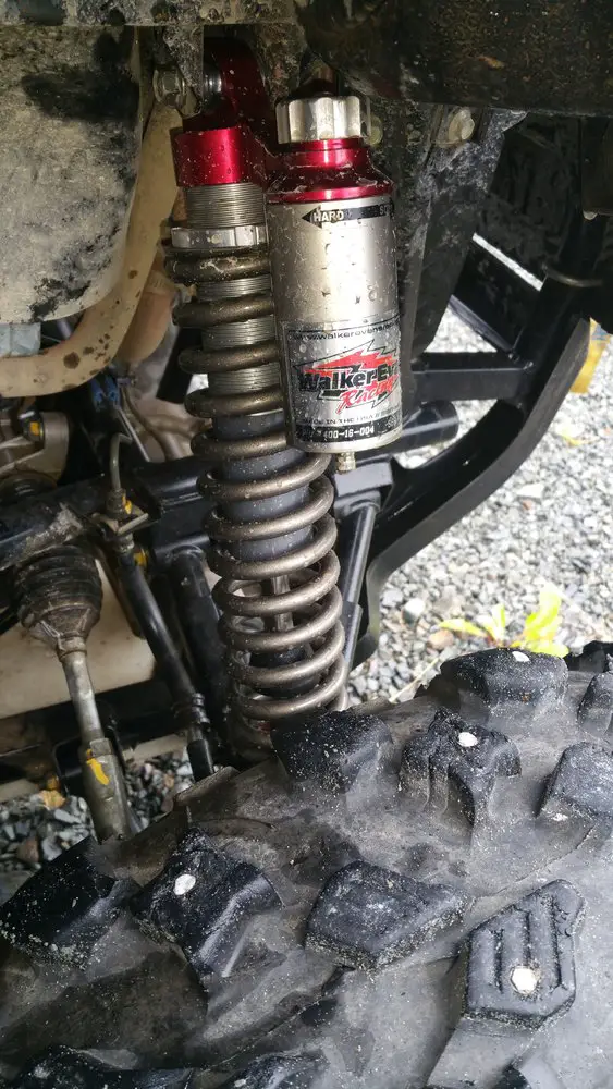

They supplied mine Grey

Ouch! That's a lot of loonies! I guess they don't have a canadian distributor...Tempted to start with the fronts they are so weak.
yea we do suffer on the dollar difference
You wont regret the shocks,even just the fronts. I'm keeping mine for a long time i figure and dont mind investing in it.If i were switching machines every 5 years ,id leave it stock for the most part.
