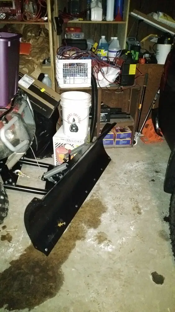

Still working through cleaning up a 2015 500 I purchased, and have gotten the full front bumper, winch mount, new synch rope, Hawse fairlead, etc. I mounted the snow blade on it to test, and it seems to 'pinch' the rope. May be hard to see in these pics, but I'm curious how others do their plow mounts. Can I or should I add some sort of pully at the low "fulcrum' point.... (not sure that's the correct term, but the thingy at the bottom of the blade what guides the rope)?

This could be a 'duh' moment. I put the rope inside the pin clamp on the bottom 'fulcrum' point. That might solve my problem.
What say you?

I had a warn provantage plow on my 4wheeler before I sold it, you got it hooked up wrong dude. Using this pic here, your cable comes down off the winch, thru the plastic "pully" from the top plow-side, and straight back and then the winch line hook clamps onto that loop hole thingy in the bottom left of this pic.
Lemme know if them's too technical wordage there, and I can try an draw up a pic or something, lol. Sorry, it's late, and I'm tired.
Also, I'd suggest getting or making a plow strap. Can DIY with 10' of old seatbelt and a connector end, or buy a cheap tow strap or whatever for $5 or $10. It's easy to swap out, and cheaper than breaking a synthetic winch line. Little duct tape to hold the first wrap on, and spool it up easy-peasy. I folded the plow strap in half to fit into the plastic "pully" bit there on the plow, used it for years.

I agree that doesn’t look hooked up right.
I found hawse fairlead wore bottom edge and broke under pressure. It’ll last a while, but repetitive lifting out of heavy snow is hard on the bottom edge. I replaced it with a roller fairlead which holds up great plowing. Synthetic rope lasts a long time but does eventually wear out on the most used section while plowing. I only lost ~2’ retying it when it broke which didn’t even happen once a season. It was used to plow a 1 km long driveway in a climate with 2-4’/season accumulated snowpack (actual snowfall considerably higher).

Old crappy pic from when I had steel cable on, but you can kinda see how it routes. You pull the cotter pin out, swing the plasticy pully bit out, slip the cable line in the middle somewheres, swing it back into place, and pop the cotter pin back in. Connect the winch hook to that hole in the back.

Ah Ha. Thanks for that. The previous owner showed me the method I used, and I'm not surprised it's wrong. ;)
I'll look into the tow strap and plow fairlead, too. Thanks all.

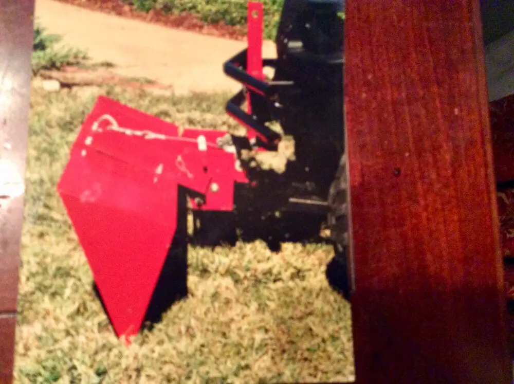

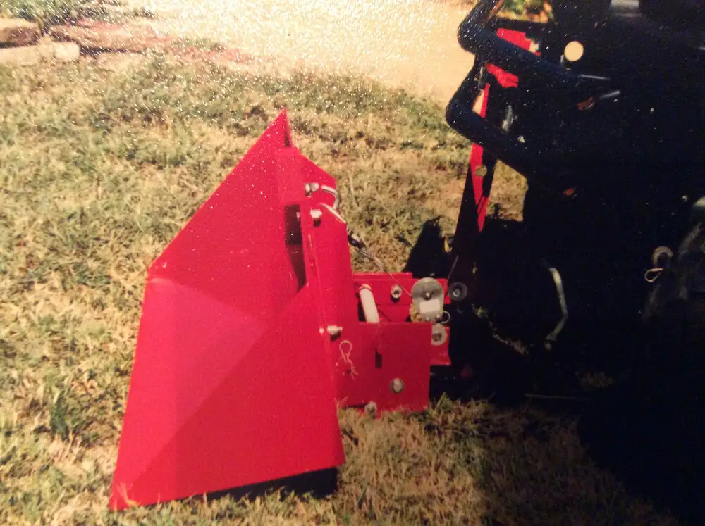

Kinda off topic, but a fun project with an old atv I made a bucket to mount on the plow bars, Could lift and dump. I haven’t fooled with it for the SxS as I now have a tractor. Just an idea to share.

On an old atv, I made a bucket to mount on the plow bars, Could lift and dump. I haven’t fooled with it for the SxS as I now have a tractor. Just an idea to share.
View attachment 291276View attachment 291277
Interesting. I can't fabricate that without investing in equipment and supplies so I'm not going there, but would be interested in it.

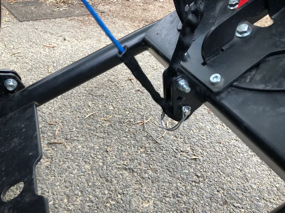

I added a pulley and connect the hook on the steel line to a short strap with metal ends wrapped around the top of the bumper.
Basic mechanics, 1/2 the speed snd 2x the lift. It makes my plow less ‘jerky’ when I’m raising ir lowering it.
I bought the 18” straps on Amazon.
Here’s some pictures.

I put washers on shaft on both sides to keep pully verticle.
