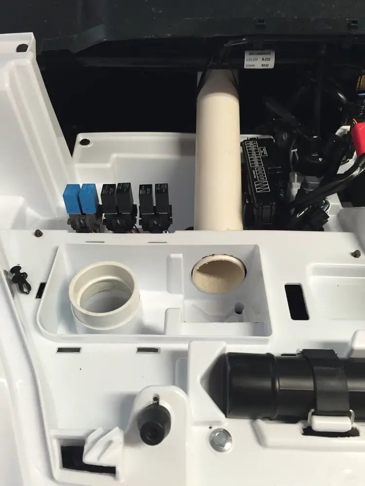

No way can water splash or no way can radiator fan throw water in my intake tube. Simple fix No more hot air going into intake from hot radiator. Good clean fresh air from under dash area. All under hood. The PVC pipe is 2inch and 13inches long Used 1 zip tie to frame.

Ridem that is awesome. I absolutely get the concept now with pics. I'm not wanting to ask but there's others out there wanting a good reasonable setup that's not noticeable so... How much did that cost you if you don't mind?

Great set up!! What size coupling did you put on the vertical intake tube, looks like something there to raise the height of the intake? Great thinking, Honda should be looking for designers like you!!

I believe it is a 2" PVC schedule 40 coupling

2inch PVC coupling and pipe. I have not sealed it yet. Will seal the pipe and seal the cover I made for the old intake hole in the front. Cost me 0. I had the coupling and pipe. Pipe is 13 inches long. If someone had to buy it all maybe $10 Hardware stores sell pipe by the feet. Find a old antifreeze type jug, I used a weed killer gallon jug I had and cut it to fit the old intake hole and glued it in. You can drill it with everything on the machine I did move the wiring harness as you can see in the pics. I think 1& 1/2 PVC would be big enough.
