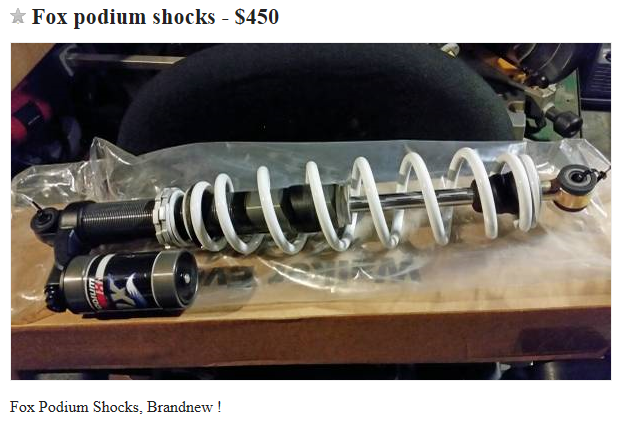

Saw this guys ad up on CL again, may have to go check these out also. $450 for all 4 and he said they may be off a 2011 Rzr 800

That's makes me curious if those will fit. That's why I'm hoping those that have done it can enlighten us on which donor vehicle. Will those from an 800 rzr work?

I dont believe the fronts will work (rzr is lighter so the spring will sag). Those are the backs I used. The other shock they have (the ones without the piggyback ) will be the direct bolt on. Just make sure you use the rear
