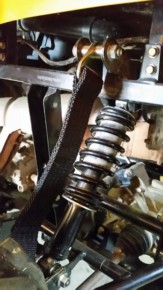

Chooglin
After I moved the stock front shocks to the rear , I gained 1/2" of ground clearance and 3/4" of downward travel. After doing this , I was a little concerned about over exstending my axles and having one of them pop out.
Today I installed some limit straps to make sure the axles don't exstend (13 1/2" eyelet to eyelet) any more than they did when I had the stock rear shocks on the back.
View attachment 59254 View attachment 59255
Were you able to just find some straps or were those custom made? They claim the WE shocks give you an extra inch of travel, would there be the possibility of the same thing happening with those?
When I wrecked..mine on the rocks..
it pulled my axle out....impact push left wheel
so far back...it broke the stop..in steering rack..

Chooglin
No they aren't custom made , I just ordered a set that had 16" length ,eyelet to eyelet.
As long as the W.E. shocks don't exstend more than 13 1/2" eyelet to eyelet, they should be fine. W.E. could have gotten the extra 1.00" of travel in the upward/compressed direction. Someone with the W.E. shocks could probably answer that.
I am probably being overly concerned , anyone who is using the 2.00" bracket lifts are over exstending there shocks and don't seem to have any problems.
