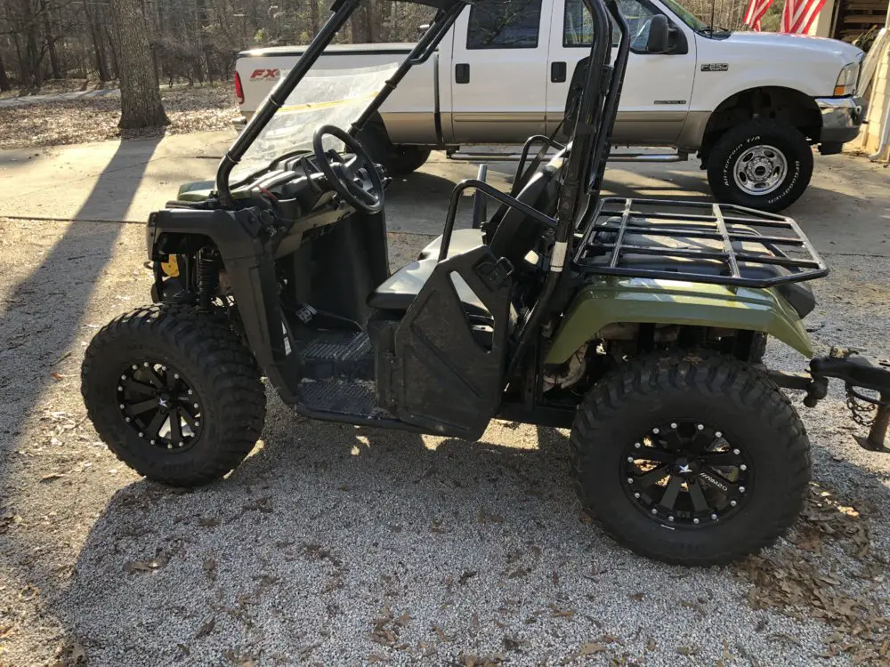

First post. Installed my msa kore 14s and bfgoodrich mt km3 28x10 all 4 corners. Box on roof and waiting for my club car seat to come in mail.
Sweet!! Those tires look great! Do they rub on the frame or anywhere else? I've been thinking about getting some , so I was very excited to see somebody post a picture of how they look. Thanks for sharing!
I have only got them to run one time when the front end suspension was flexed. Other than that no.

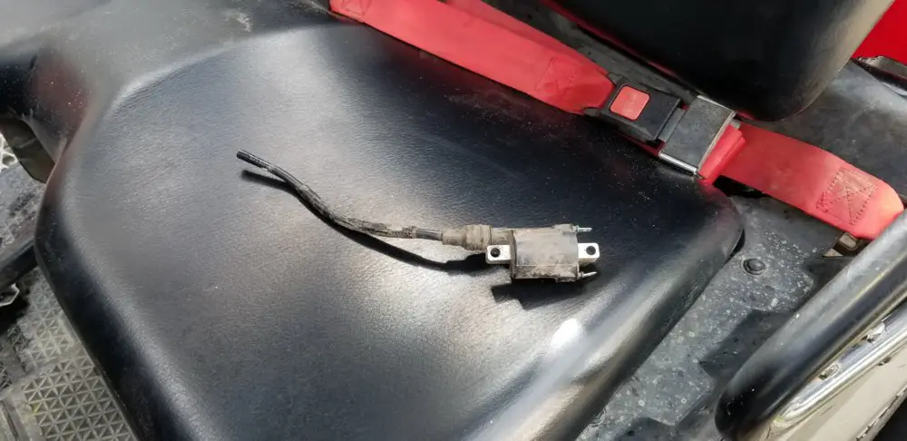

I put the new coil in and fired it up and let it run. I also adjusted the clutch. I contemplated jacking it up and tearing the front end out so I can have it ready to install the front locker when it gets here, (its supposed to be here today), but I think I will leave that project for next weekend. Im going in to be lazy now. Back to work tomorrow for me. Yall have a good one.
Pics or it didnt happen.
