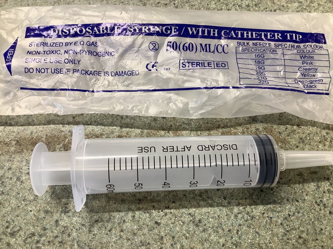

What did you end up doing? Have large syringes (different sizes on amazon) and clear tubing to remove fluids by fill holes. You can always drain, fill, drive and repeat if concerned about residuals. Removing the side plate is a PITA.
I drilled holes, several of them.

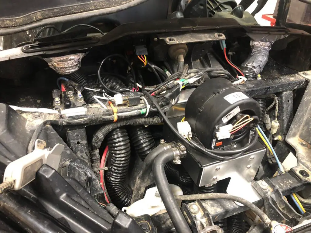

Hooked up my plow, figured I’d push the 4” of snow off the driveway. Pushed the dash toggle on the Warn VRX and nothing. Brought it in the shop, started with battery connections (ok), power to solenoid (ok) then reached behind the maze of wires from a heater, led lights snd the horn pushing in the connectors. Works fine. I hate to close it up and have it happen again. Any suggestions to do anything more?
That’s enough for 1 day, time to put a couple blue cheese and bacon mule deer sausages in the oven. It makes mule deer taste ok!
I've had issues with solenoids freezing in cold weather. They'd fail to switch until tapped while holding the switch. The Polaris solenoid on our old 6x6 was bad from new--so bad I carried a short shovel that I could reach under the fender and hit the solenoid with as needed. The Warn replacement didn't exhibit this issue for a few years, but eventually starting doing it now and then. I'm guessing the issue relates to sealing and moisture getting inside the solenoid. Other than that, dielectric grease--or Vaseline--in connectors to keep water and corrosion at bay can help keep electrical stuff working well.
