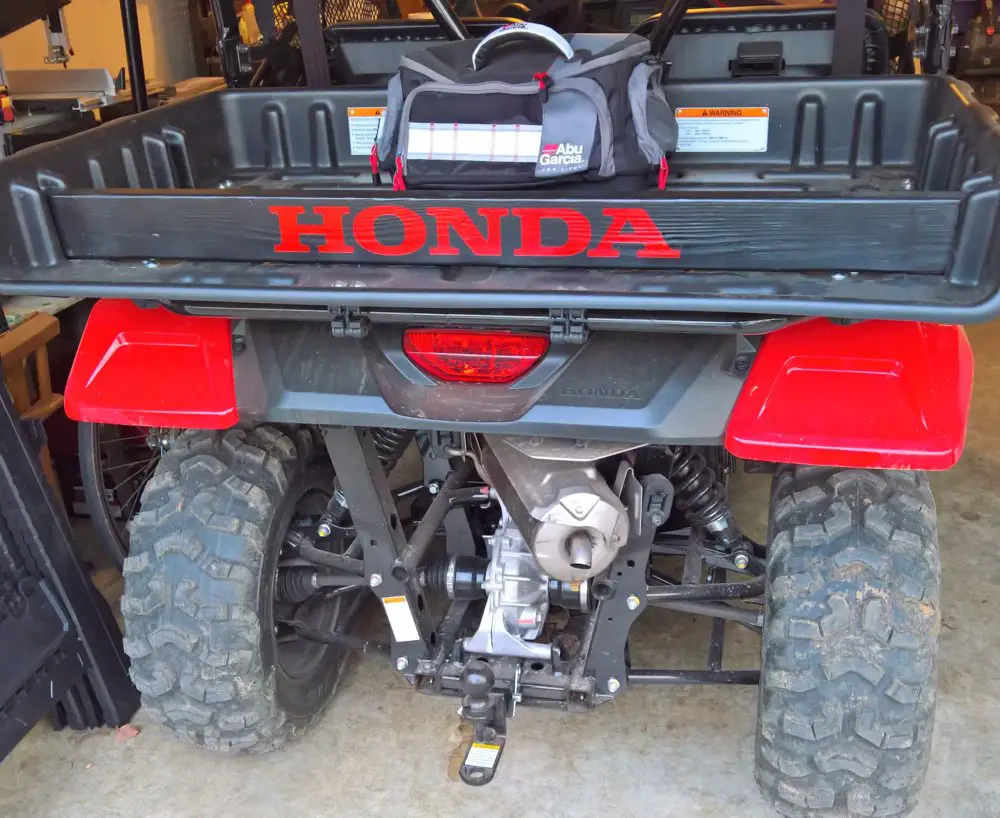

This is my first post but I've been lurking for a few months now. I bought a 2017 about four weeks ago and have been having a blast riding around our property and making new trails through the woods. My latest mod is this "tailgate" made out of a 2x4 we had lying around.
WP 20170131 07 05 04 Rich 2
Welcome to the forum, glad you came out of the shadows to become legitimate. :D:D Nice looking tailgate!!

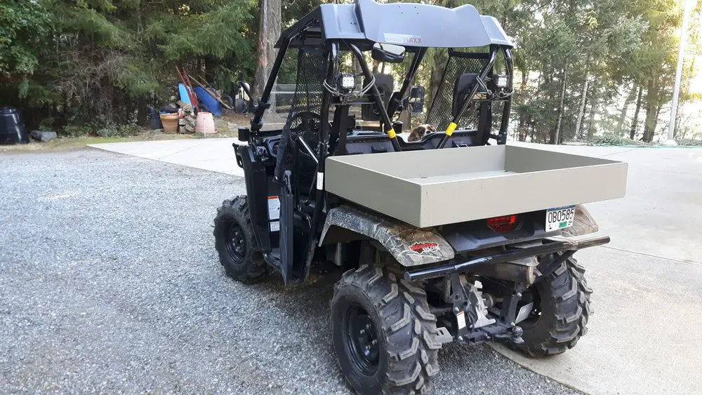

Storage Tray:
I didn't want to spend any $$ on a tray for the back rack. I like a tray with sides; holds things in better. Momma will use the tray to move flower pots around etc. I'm not a metal fabricator, but I do have a wood shop. Used some 3/4" plywood for the base and 1/2" ply for the sides. The costliest part of this tray was buying the paint. The tray is held in with heavy zip-ties at six locations.
20170201 130534 resized I like wood 'cuz I can place eye bolts anywhere I need.

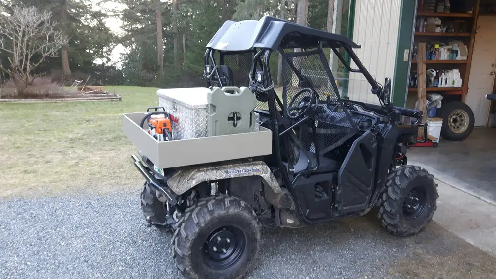

20170201 155100 resized I screwed the aluminum box onto the tray. I'm pretty sure this will all hold together. If it shakes loose, I'll pipe clamp the tray on and bolt the aluminum box down. I put several eye bolts in and bungied the chain saw down; it's super secure in the tray.

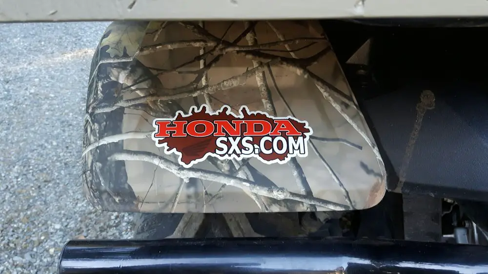

20170201 130641 resized Of course, no job is complete without a hondasxs.com decal !

What are the dimensions of the wood box you built? Looks nice.
