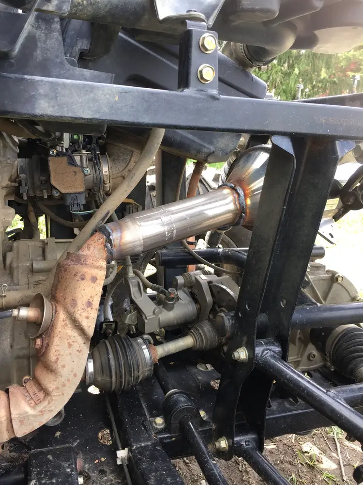

Stopped and turned the machine off after a long top speed run last weekend. The wife asked what all that popping noise was...lol. These heat shields do make a lot of noise.
Yep.... I dropped the buggy off today at my favorite local stainless exhaust shop to get my new pipe on. He said I can probably get away with leaving one of them off since the cat will be gone. The cat gets super hot and that's why it has its own shield. Can't wait to get it back! They have always done a really good job for me in the past.
Obviously pics please

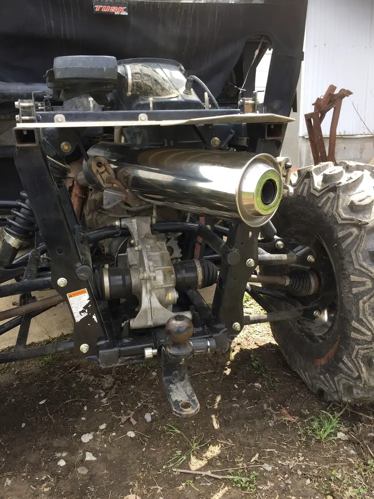

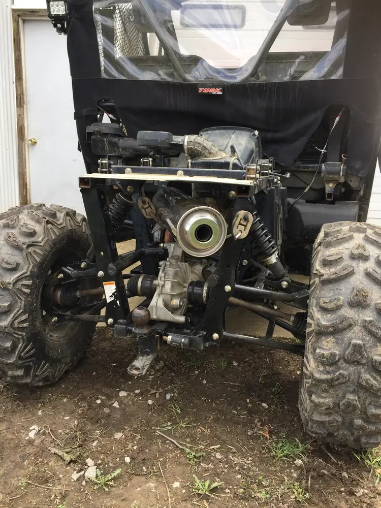

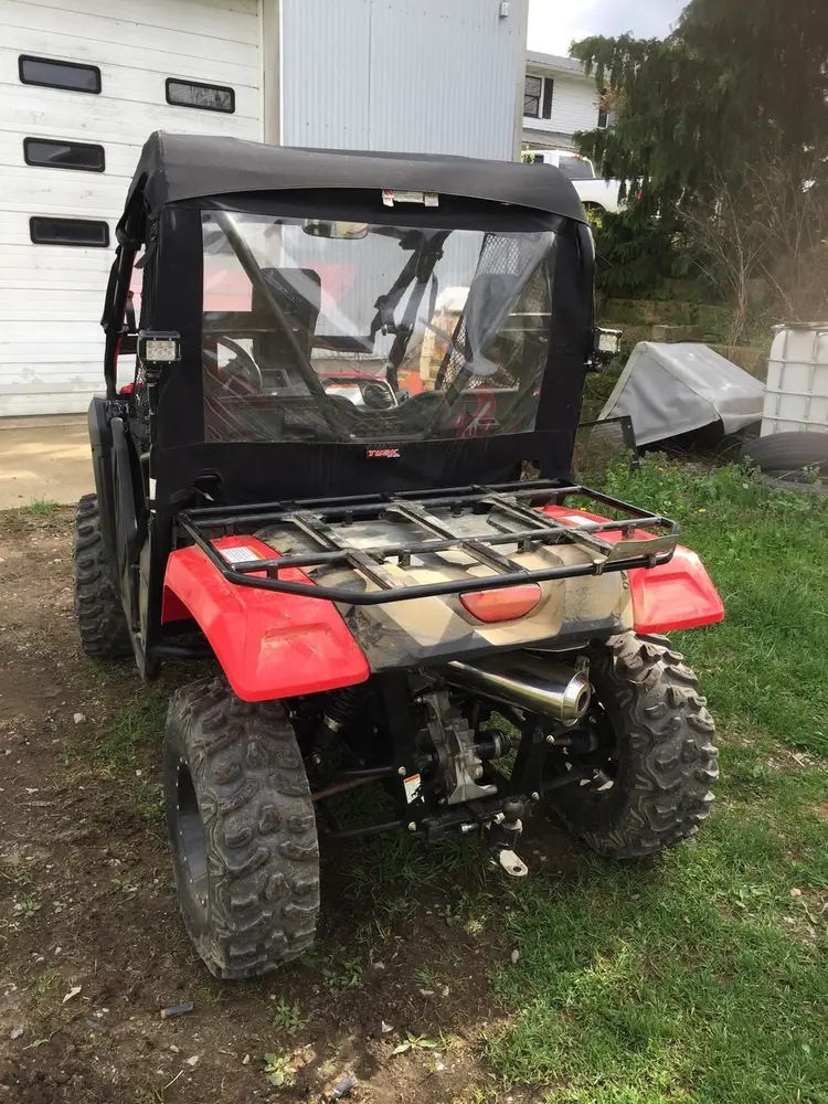

Awesome Bad Ass How's the sound?
It sounds good. It's not really any louder but that's ok. I didn't want it loud. It definitely has a deeper tone, which I like. Less rattles from the exhaust. Noticeable improvement in throttle response. I'm happy. $60 total.

@ehart814 is it quieter or louder than stock ?
I really don't think it's any louder. But it is deeper, and sounds better.
