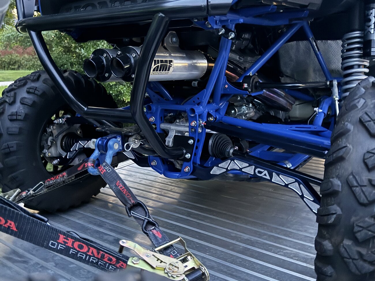

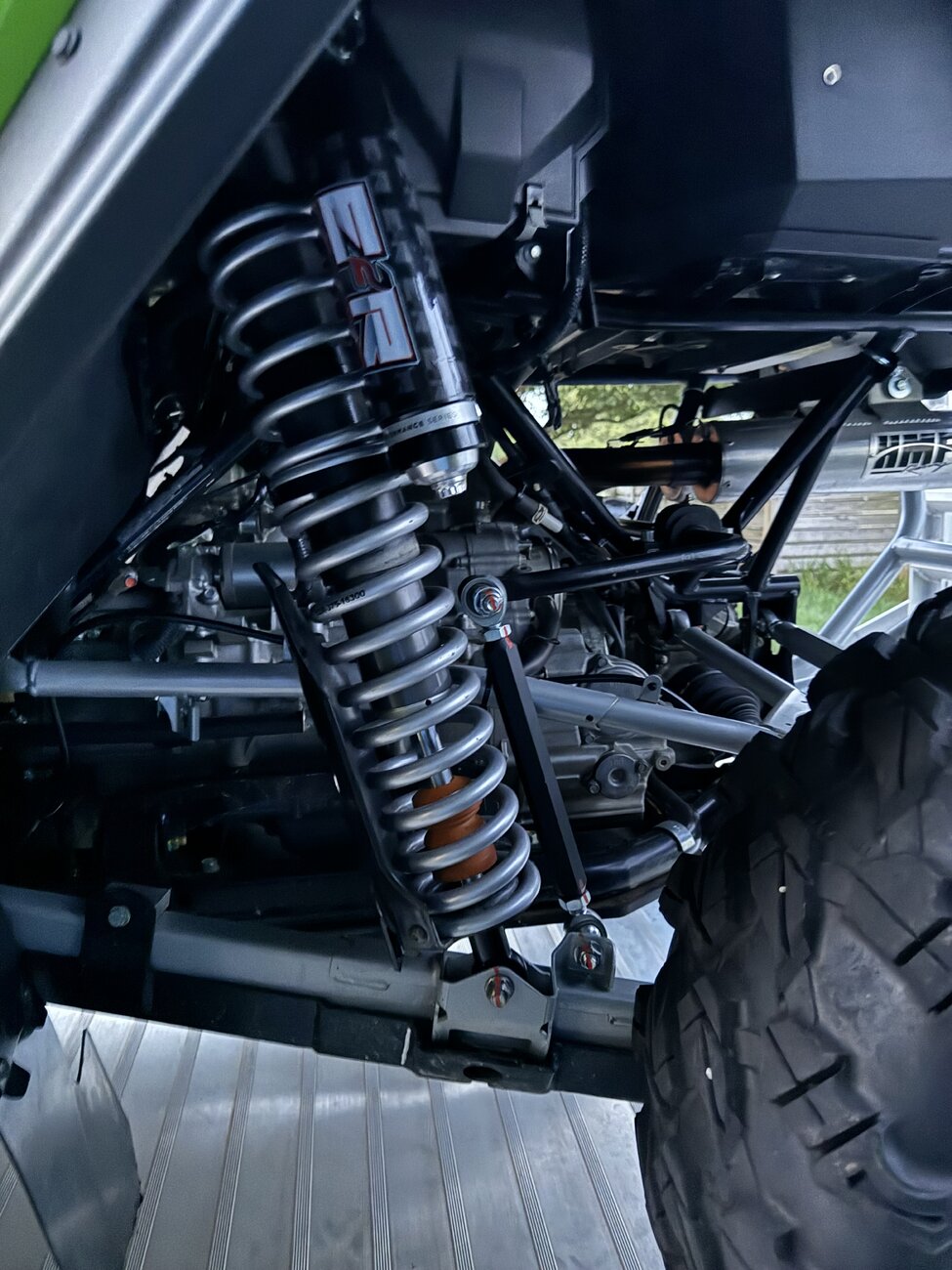

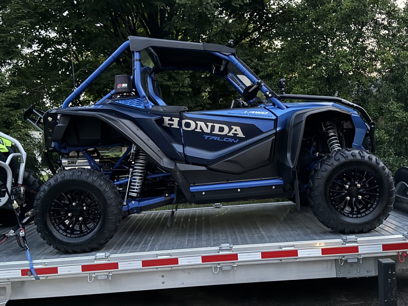

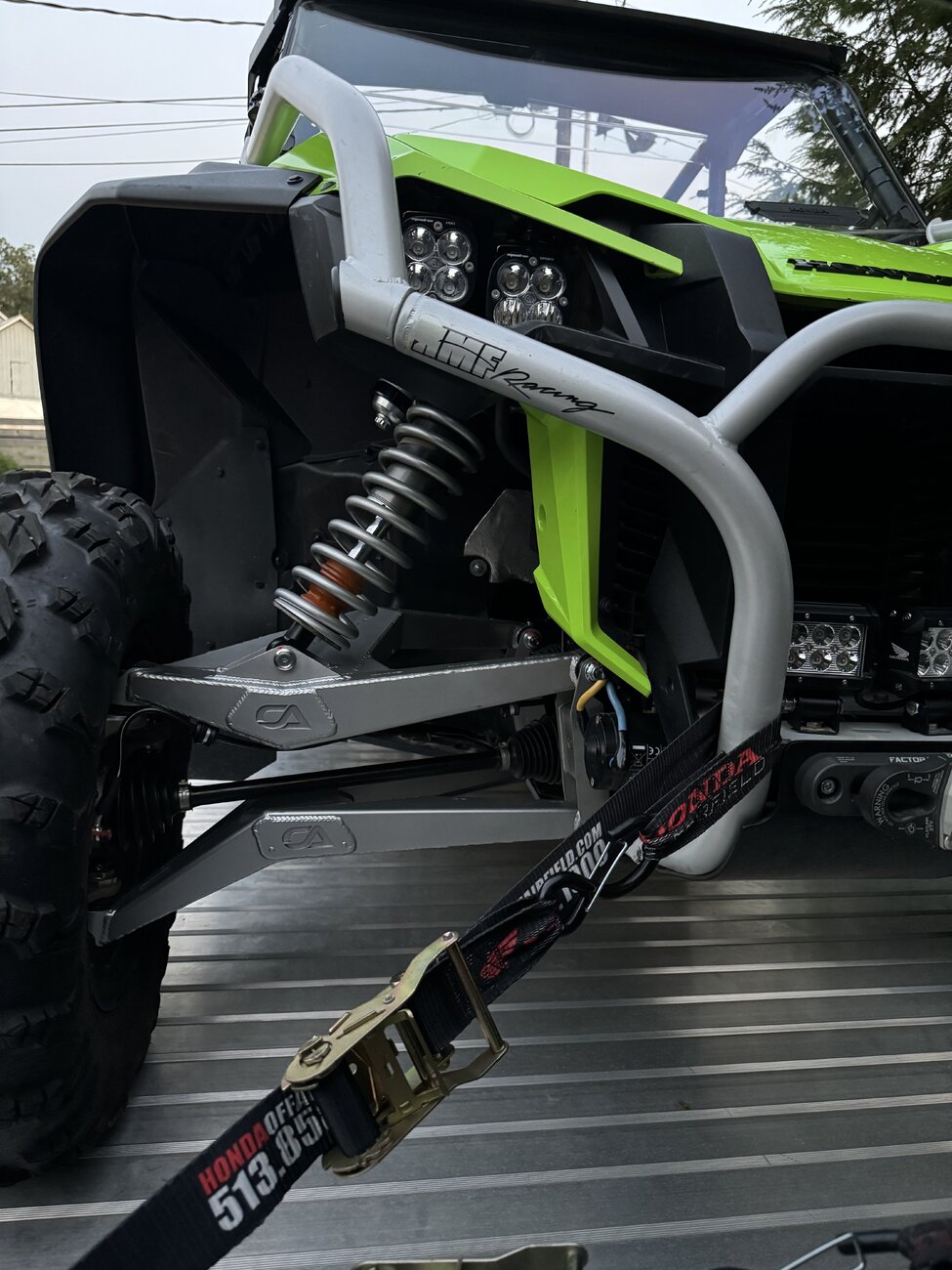

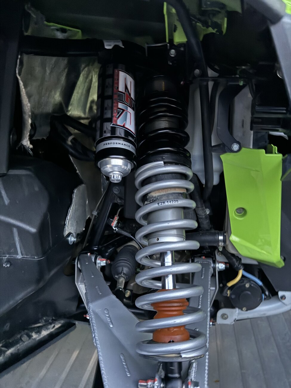

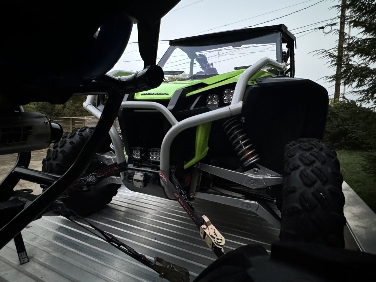

Picked up the Talons Saturday afternoon from having front a-arms and rear radius arms installed along with my re-worked suspension from Double E Racing. Installed a host of RaceCo braces and hubs, stainless brake lines and lightened wave rotors on the green machine, 1st service on the blue Talon along with a host of other upgrades.
View attachment 439458 View attachment 439459 View attachment 439460 View attachment 439461 View attachment 439462 View attachment 439463 View attachment 439464 View attachment 439465
Hell ya!
Did you send the rotors to my buddy Brian for lightening?

I purchased a set of wave rotors and plan to send the takeoffs to your buddy. I achieved the same result with the wave rotors. I took it for a quick spin Sunday morning and lightly bedded them in and am liking the way the pedal feels with the new brake lines. Looking forward to getting out and better evaluating the suspension upgrades.
