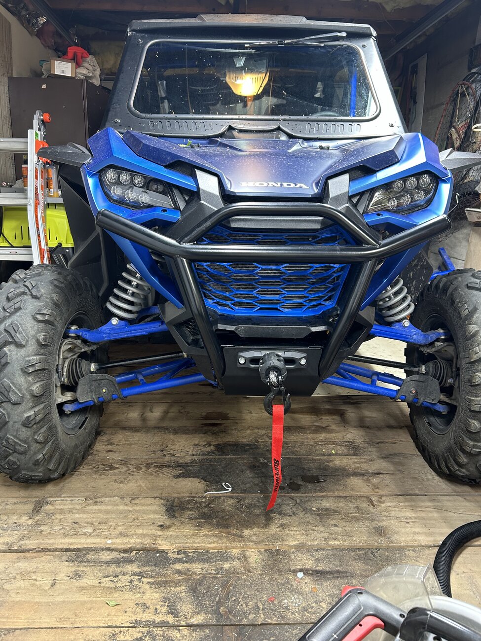

Hi all. Got an HMF bumper with winch installed on machine yesterday. I’m new to the forum. Appreciate all the ideas here.

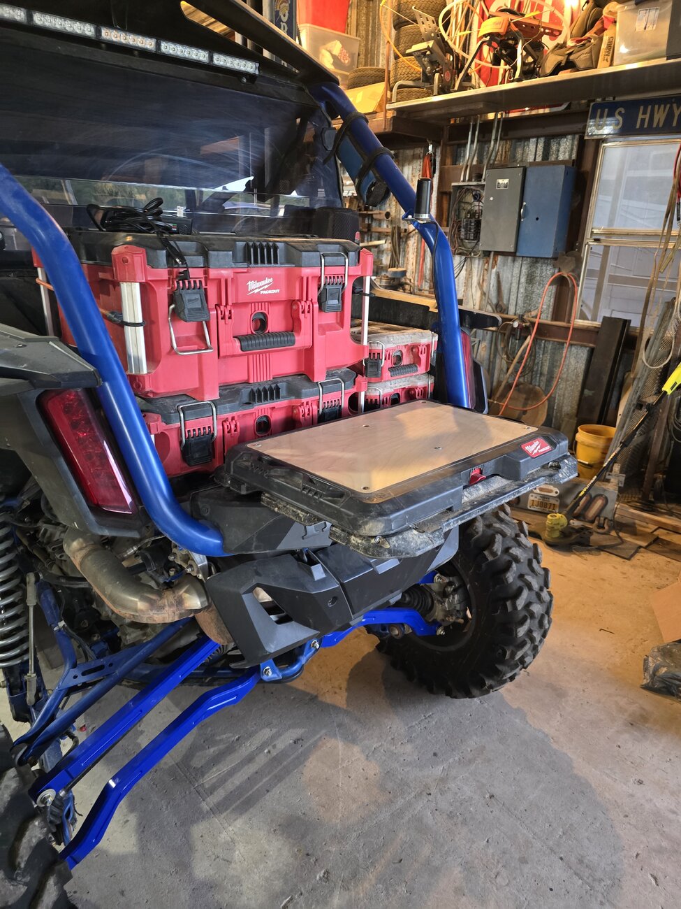

Thats cool, what holds it in place?
I will get a couple more pics today
I took a piece of 3/4"X3/4" angle and added a couple1/4-20 carriage bolt into one side at the factory tie down loops in the rear of the bed. The bolt heads go into the loops and the the Pac-out base plate is bolted to that.
20240910 191554
20240910 191600
20240910 191548
The flat plates are added for stability of the base, the OEM plastic has no support past these bolts.
20240910 191608
This is not for anything really heavy or the be used while riding. I was looking for something to hold my Jet boil and a few things while Overlanding.
