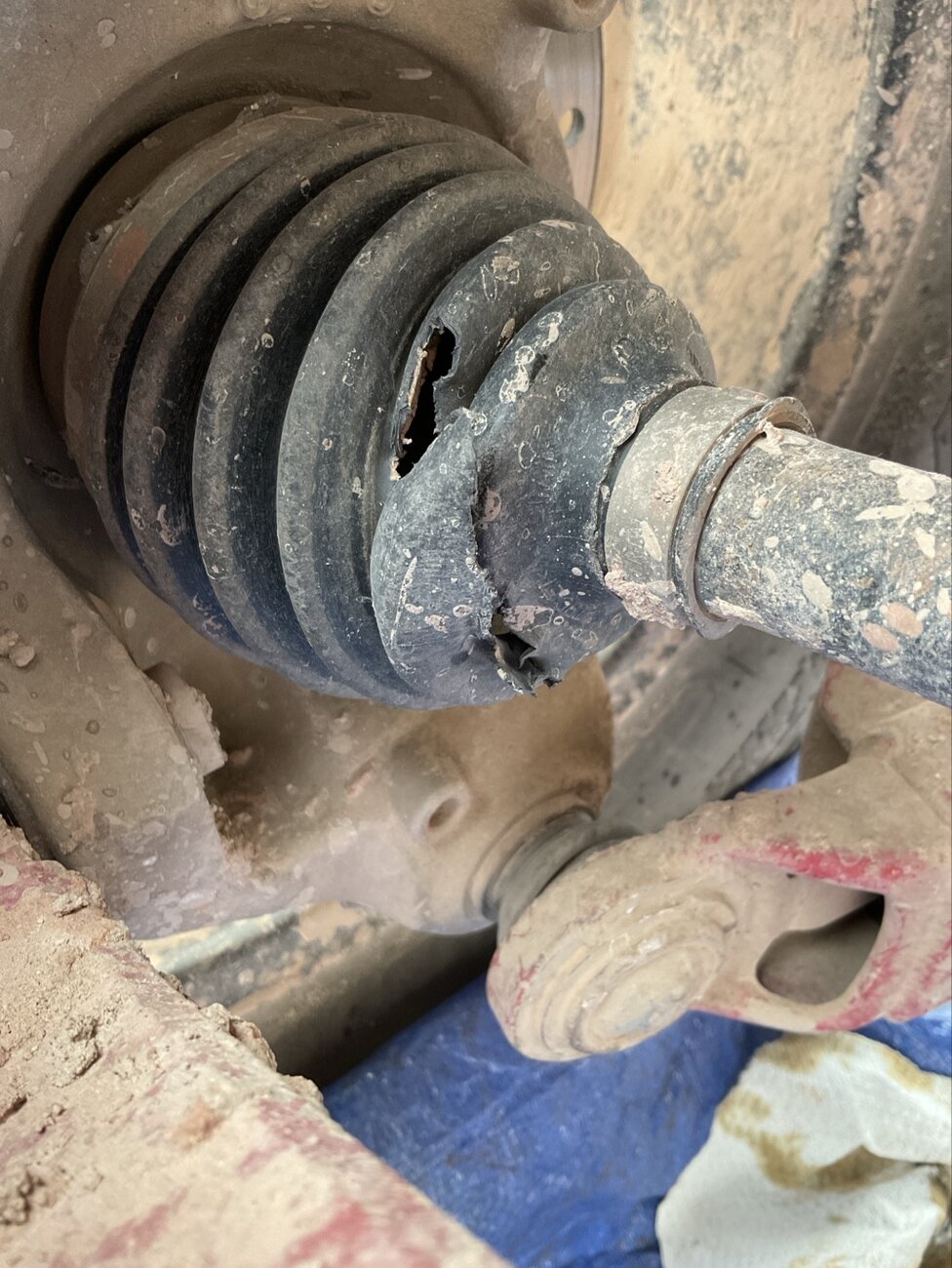

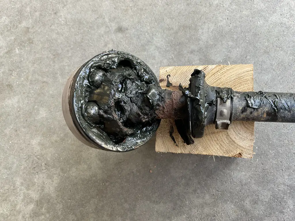

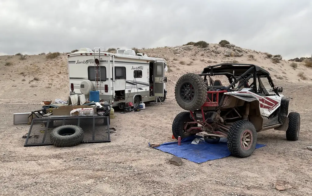

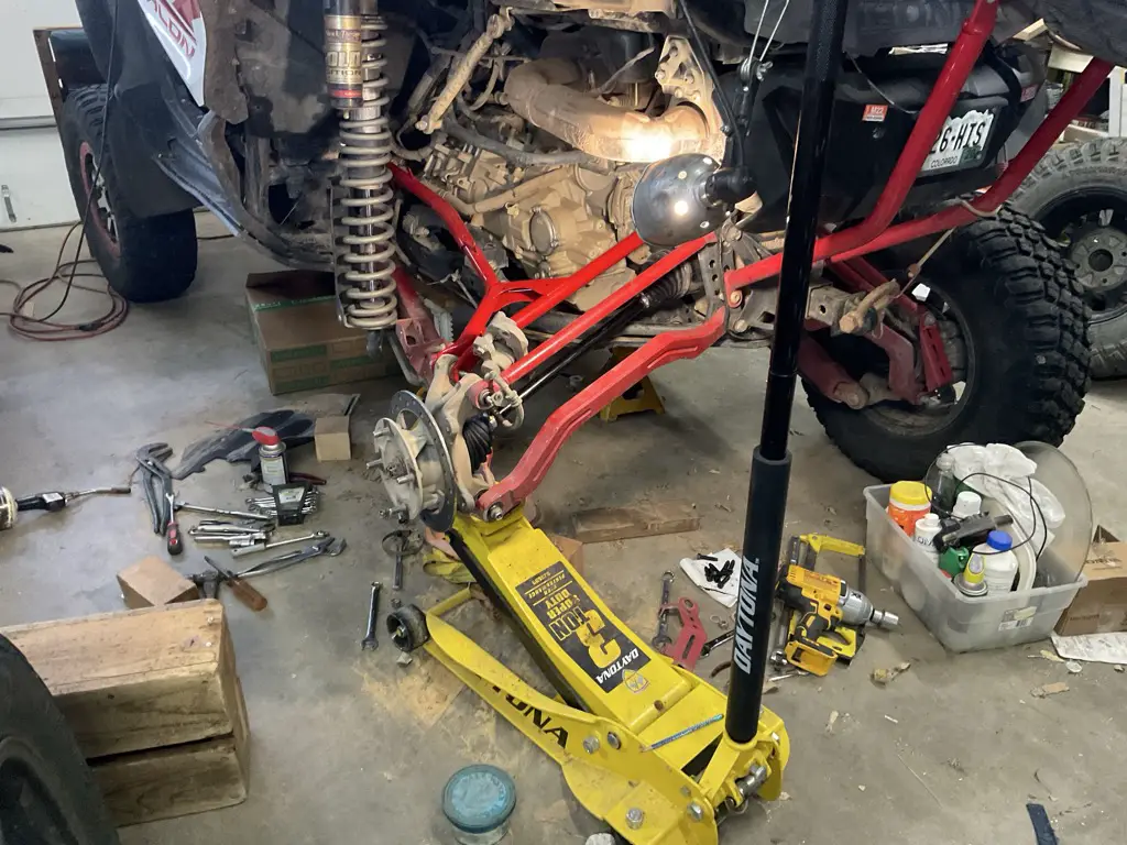

Waaaaaay back in October, toward the end of the season (even in Utah), I did a scheduled campsite oil change. During that, I found this torn boot. I'm not sure why it didn't spit grease all over that corner of the Talon to let me know that I had a problem, but it didn't. :( Although I had a complete spare axle, I realized that I didn't have enough 'other stuff' to replace it in camp ... so I packed up and headed home. I'd have tried harder but had ridden ~1300 miles on this trip and felt ok calling the season over.
This camp -
1741567824904
This oil change -
1741567792436
This torn boot -
1741567902426
This is what was left of the CV after I cut the boot off. It was worse before I cycled it through its range of motion and the grease covered the rust, but it was very stiff and binding up pretty bad -
1741570617210

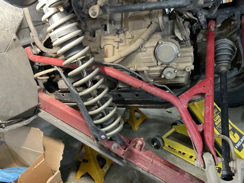

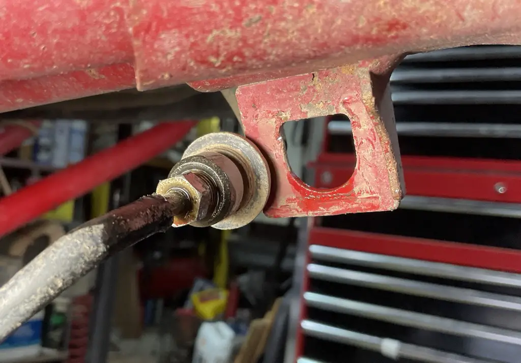

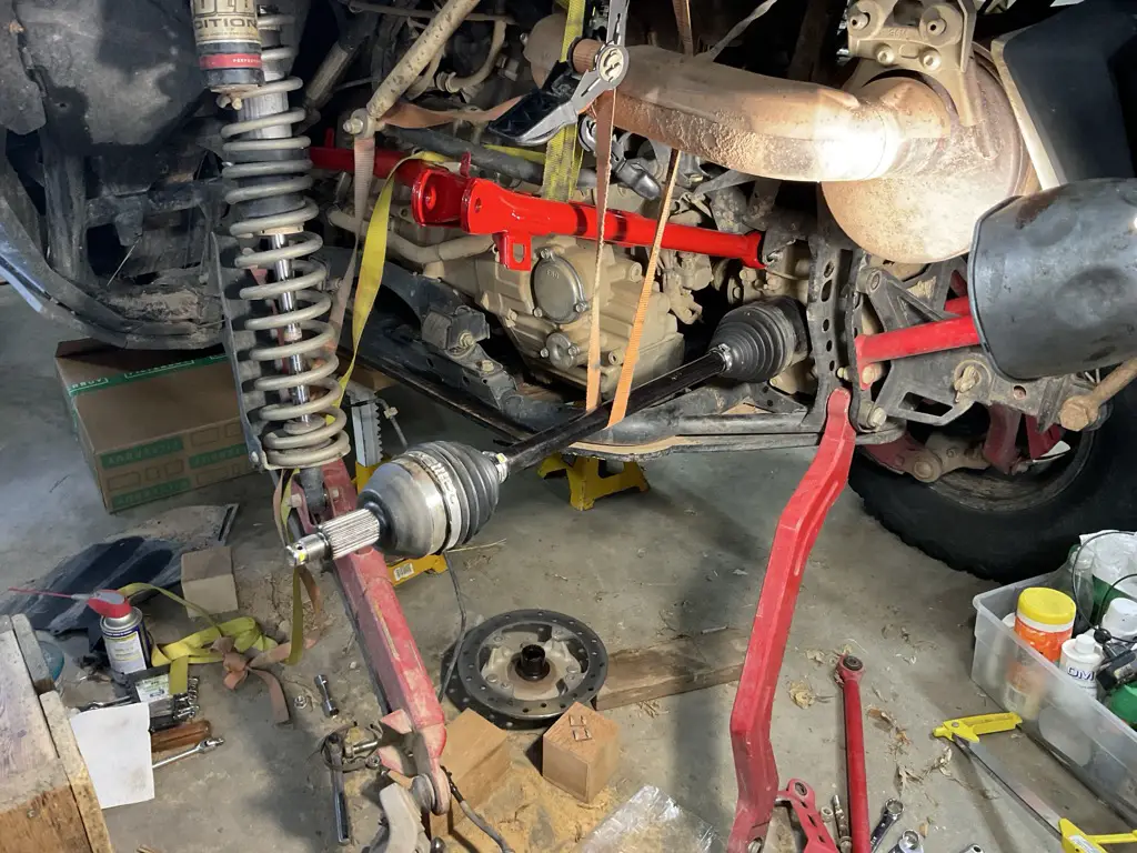

While I was getting ready to replace the axle, I discovered that the front bushing on the upper trailing link had left the building (the one right behind the driver's butt). Now I knew what that damn KLUNK in the rear end was. So my new task, on top of the axle assembly replacement, was also replacing that upper trailing link (no, you can't just buy the damn bushing :mad:).
This (dirty) red part, bushing at the far left -
1741568355971
Pay attention to the orange ratchet strap holding the axle assembly horizontally - that simple trick makes both removal and assembly buckets easier.
1741568899595
1741568947164

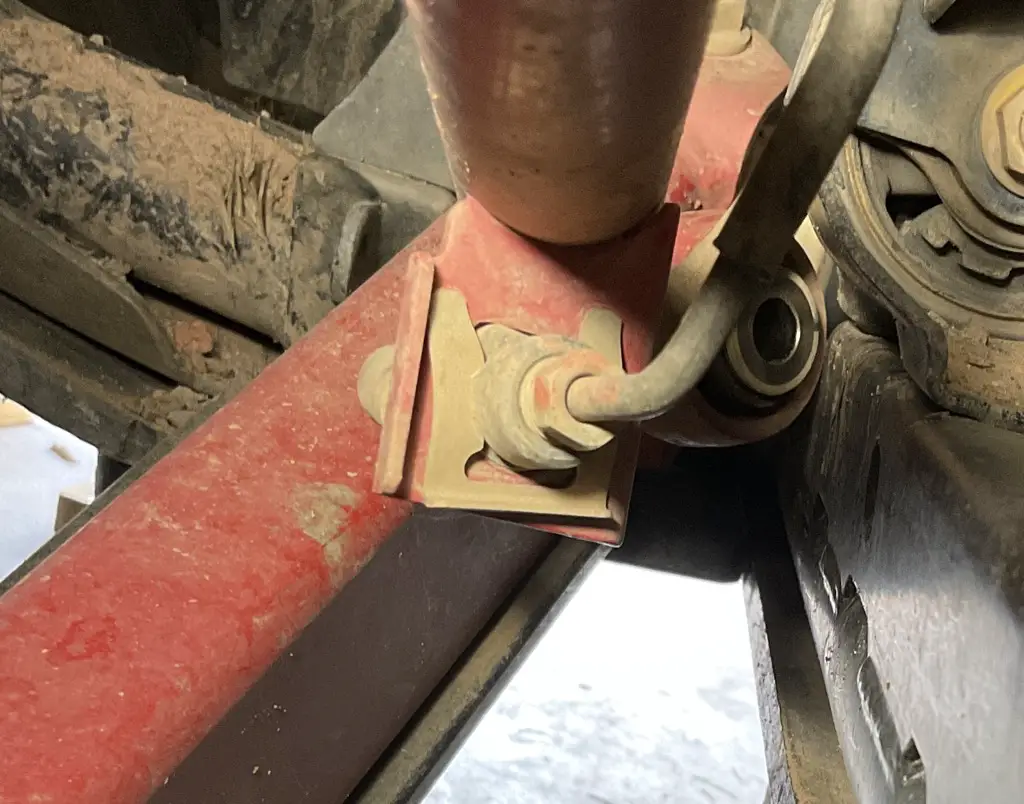

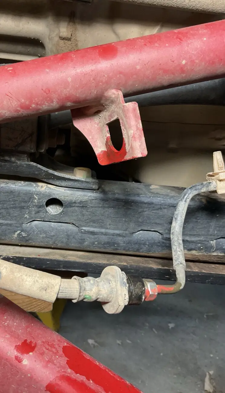

The brake line passes through the upper trailing link twice meaning that you'll be breaching the brake line twice which means you'll have to bleed that air out of that section of brake line -
Front - Note the D shape of the hole - I thought that I had to keep the fitting from spinning when undoing the flare nut but that D shape keeps the other side from turning, so you can just loosen it, it can't spin.
1741569436621
Rear -
1741569500691
This is the clip that secures both 'pass throughs' -
1741569576709

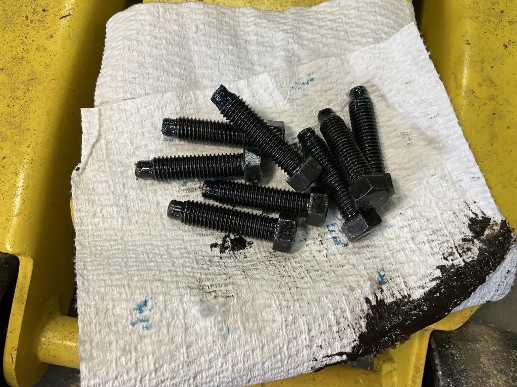

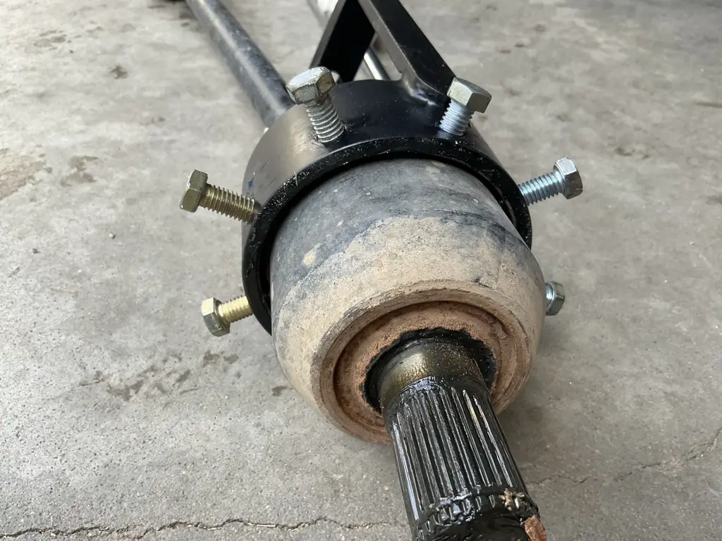

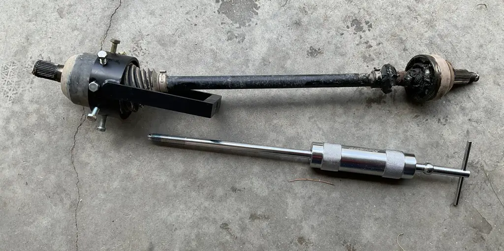

Since I had done this before, I decided to buy the SATV axle puller, I'm glad I did ... it makes the job easier and good tools aren't an expense, they're an investment. Those aren't the provided 'setscrews', I had to provide my own. That 'hammer' weighs as much as I do - :oops: On the second WHACK the axle let go and I almost fell off the box I was sitting on. 😊
1741569834996
Honda must use the largest SxS CV available because the SATV puller barely fit over it -
1741569996302
The provided bolts are 'shouldered' (because I can't think of the right term). They wouldn't grab the threads in the collar, and if they did, only by a thread, they'd have stripped if I had tightened them -
1741570178860

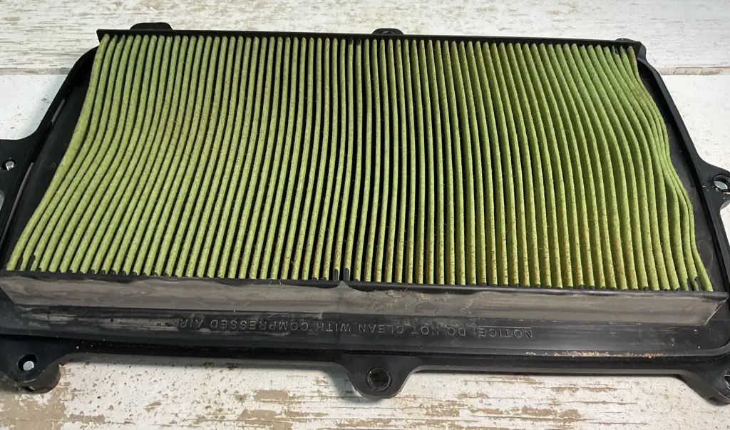

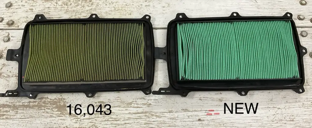

After 4-1/2 years and 16k miles, I decided to replace the original air filter because it's paper and could simply shake itself to bits (it didn't). I checked on it every once in a while but it was always clean so I put it back together until the next check up. All of those miles were with a Uni pod filter on a snorkel behind the passenger's seat headrest (details and part numbers in the New Talon Owners thread linked in my sig). If filters are $45 and you might get 500 miles per filter, that's 32 filters and $1440 - :oops:
1741825773791
Close up -
1741826243346
Close up -
My lawn mower has an inner and outer filter. The inner filter would always be so clean I wouldn't change it, only the outer. One day I checked the filters and the inner filter had started to come apart. After that, and for a few bucks more, I started changing the inner filter at the same time as the outer.
Close up -

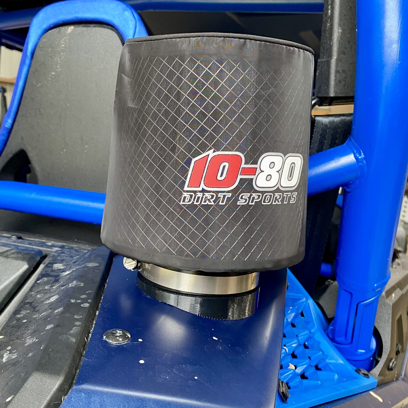

A prefilter system is hands down the best single modification you can install on the Talon. As you are well aware, the less you open the stock airbox the better off you are.
The dealers that like to accessorize machines before selling them should all be offering and installing the 10-80 Dirtsports pre-filter kits on every Talon they sell. Upselling an accessory that does such a good job of protecting the engine along with the ease of maintenance, it would practically sell itself.

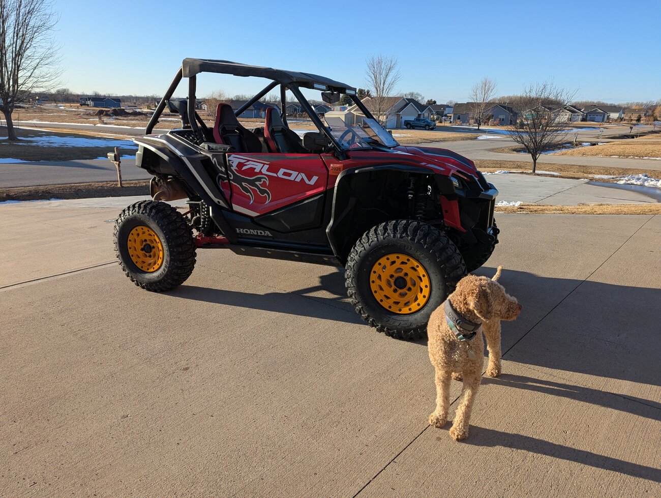

Those yellow Can Am wheels look very awesome on your Talon. Excellent choice!
I really wanted them in desert tan but the cost of powder coating wasn't worth it to me and these were on marketplace for $500 which made them a very affordable and high quality bead lock wheel
Absolutely correct and something I should have said. To replace those ~32 filters, I would have had to open/close the air box ~32 times instead of ~6, trouble looking for a place to happen. For those who don't have a snorkel yet - get an inspection camera/endo scope for your cell phone or tablet and use the airbox water drain to inspect your filter. This wasn't my idea but I won't 'name drop', if he wants to speak up, he can.
With the Uni on a snorkel, I can see when it needs to be replaced without disturbing anything and it takes 5 minutes to R&R a filter. I have 3 of them, so there's always a clean one ready to install.
About the clips holding the airbox lid on, they're a finger killer - :eek: The solution is a 19 mm end wrench - use the open end to release the clips and the closed end to pull them back into place, also not my idea but I don't remember where I saw it. It's pretty simple to figure it out once you're there.
