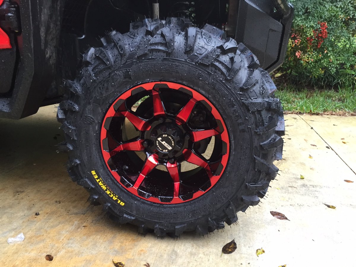

After looking at what others have been able to fit without any lift, I went with 28" Blackwater Evolutions on stock wheels.
28x11 rear 28x10 front. When turned hard over there isn't much clearance with the 28s, but I don't think it will rub much even when hard over.
Ill measure the overall width when I get the machine to the house.
