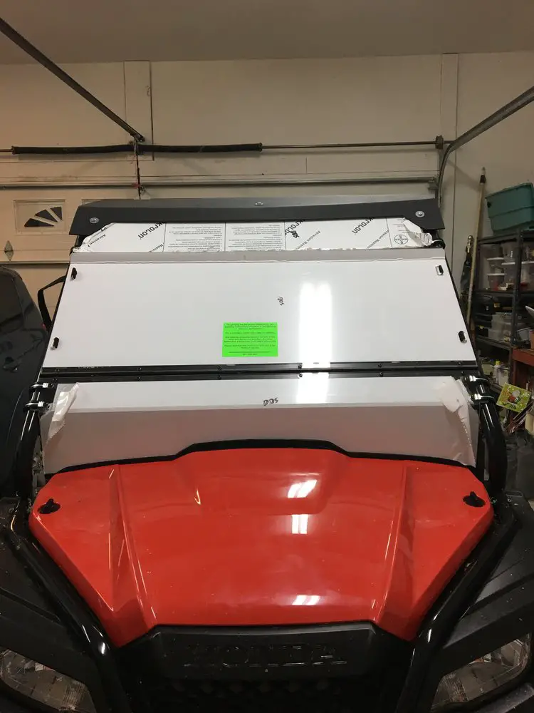

I just ordered one and got the scratch resistant one.
Thank you for the recommendation.
You will love it.
Polished mine with Maguire's plastic polish and much better but still wish I would have paid for scratch resistant. Its a great windshield that allows you to remove hood and I have towed it both up and down at 70mph.

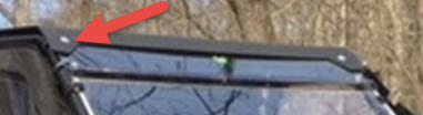

My windshield is arriving today. I was looking at the small piece of windshield that is under the roof does each of the top corners share a clamp with windshield?

I will have to look but I do believe they share a clamp, like the wiper its a EMP(extreme metal products) 12" and all you have to do is move the blade down and you can fold the windshield like normal as it mounts through the fixed lower section.

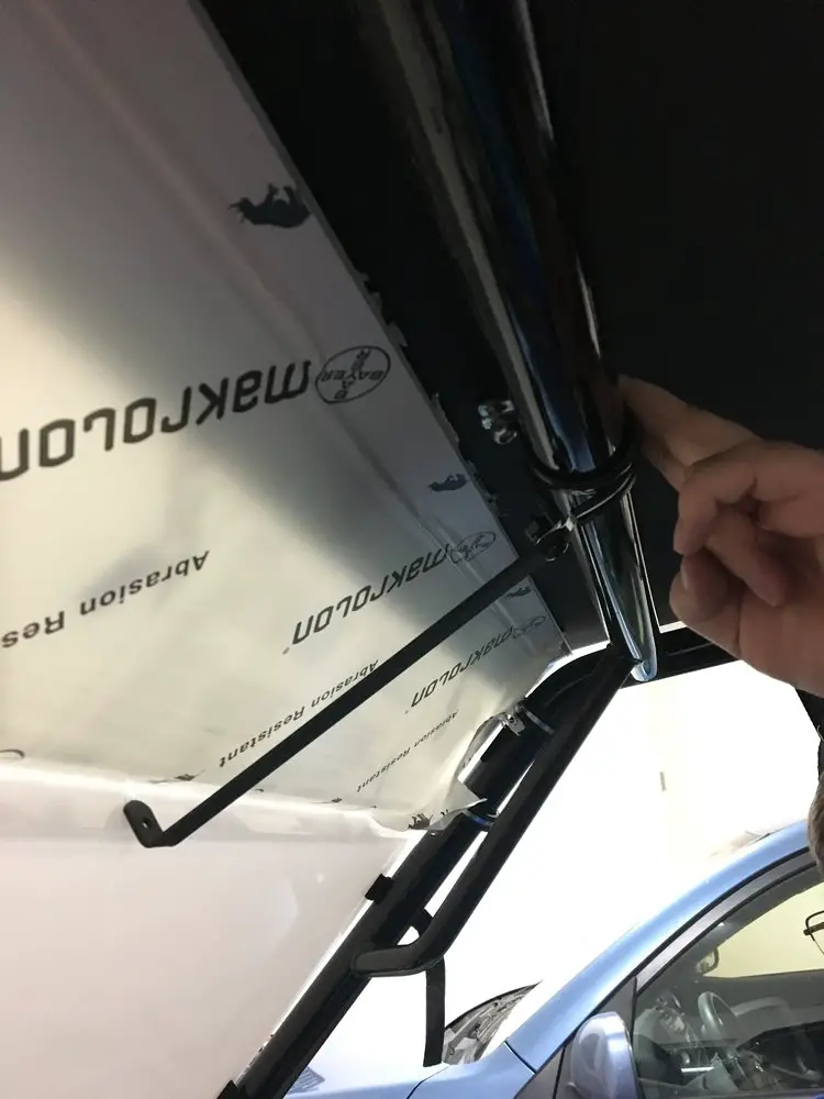

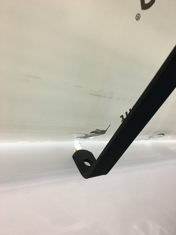

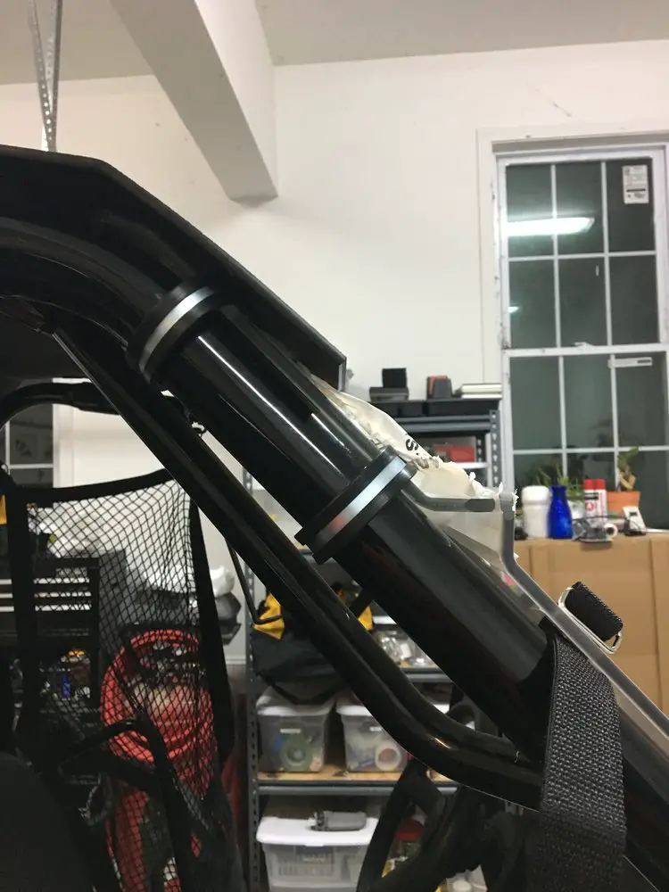

KYhillbilly I am having trouble getting the middle support to line up with the hole in the middle part of the windshield.
and do I have to top piece turned the correct direction.

you have it correct just may have to bend the end of the bracket a little to change the angle to get it line up perfectly. I vary rarely hook up my center bracket. The p500 isn't fast enough to really need it, only if trailering with window up which I never do. Here is a link to video from them on installing the windshield. I also put a little piece of weatherstripping on the bracket so it doesn't scratch the upper section if it were to hit it.

Thank you I’ll try and find something to bend the bracket over.
