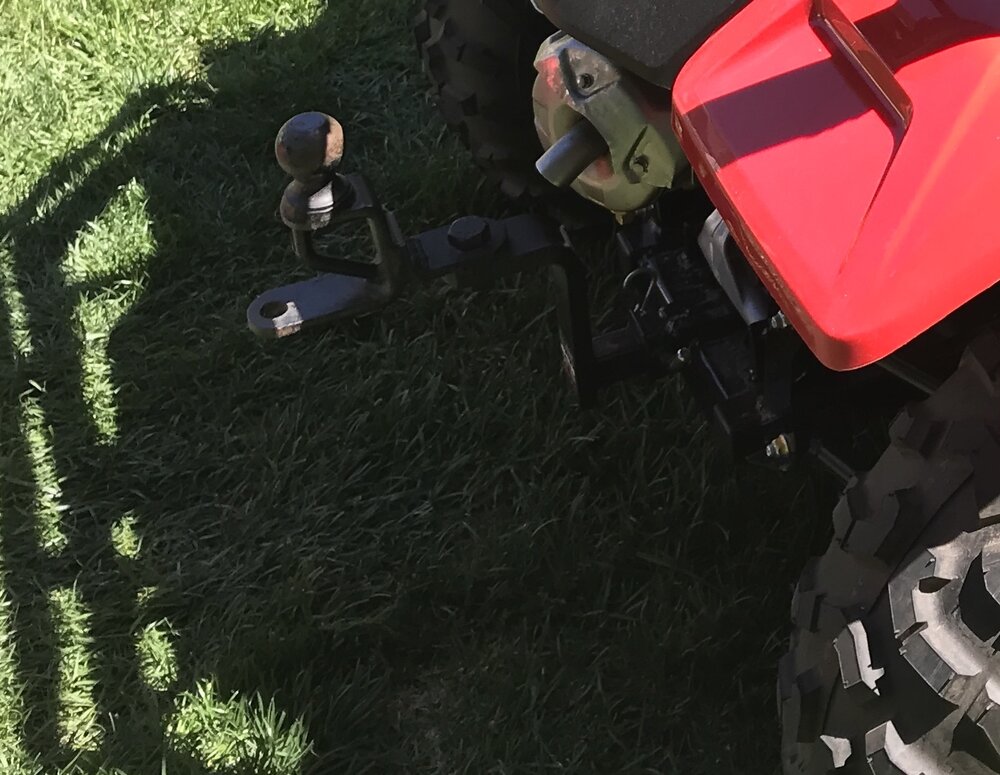

Far N.E. Iowa
This is what I use pulling smaller boat/trailer and wood trailer with 2" ball and no issues. 6" riser I believe. A couple welds to keep it from swiveling. IMG 1563 copy
Reactions: NTCPrezJB
